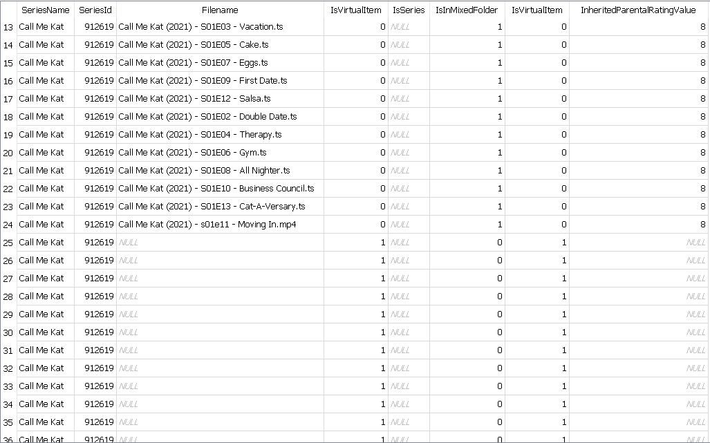

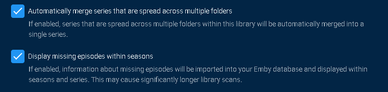

Carlo 4561 Posted June 10, 2022 Posted June 10, 2022 IsInMixedFolder is what I was looking at. Probably not related but: Do you have "Display specials within seasons they aired in" turn on by any chance? Library->Advanced tab How about these 2 settings from Library setup menu? @Luke Not sure how this is pulled from the database but if it's a single SQL query or two if you PM the SQL, that could be helpful knowing the criteria being used. Question about IsInMixedFolder column above.
MBSki 1116 Posted June 10, 2022 Author Posted June 10, 2022 6 minutes ago, cayars said: IsInMixedFolder is what I was looking at. Probably not related but: Do you have "Display specials within seasons they aired in" turn on by any chance? Library->Advanced tab How about these 2 settings from Library setup menu? @Luke Not sure how this is pulled from the database but if it's a single SQL query or two if you PM the SQL, that could be helpful knowing the criteria being used. Question about IsInMixedFolder column above. The only one of those settings that I have enabled is Display Missing Episodes. I've turned it on and off and it doesn't make a difference. It appears that you're looking at the Recordings library which IS mixed. And, interestingly, that one works. The libraries that do NOT work are the TV Show media type libraries.
Carlo 4561 Posted June 10, 2022 Posted June 10, 2022 Sorry, I re-opened SQL tool with your library and just threw that SQL together rather quickly to show you roughly how I was looking at it.

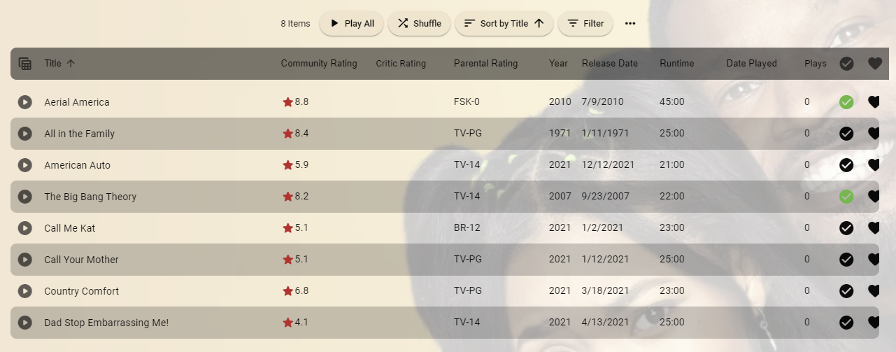

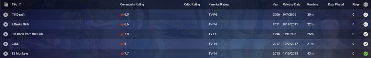

MBSki 1116 Posted June 16, 2022 Author Posted June 16, 2022 @cayars Can you please respond? It would be nice if we could get this issue fixed. It's a bit annoying not being able to use a basic feature. I'm not sure it helps, but having the table view might provide a clue. the 2 shows that are marked as played don't have a Date Played or any Plays associated with them. In the example below, I marked The Big Bang Theory as played a few minutes ago and it still doesn't get a Date Played stamp.

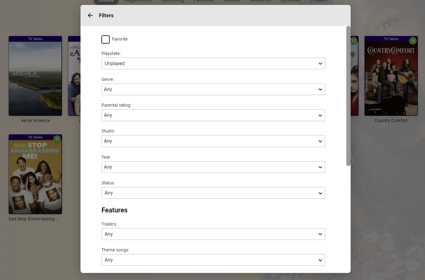

MBSki 1116 Posted June 17, 2022 Author Posted June 17, 2022 5 hours ago, cayars said: I didn't look at Aerial America but only the ones you mentioned. What specifically happens with Aerial America? Let me know how it works on your setup and I might have a better idea what to look for. Sure, there really isn't much to it. I select the Unplayed filter and everything shows up, even the played items.

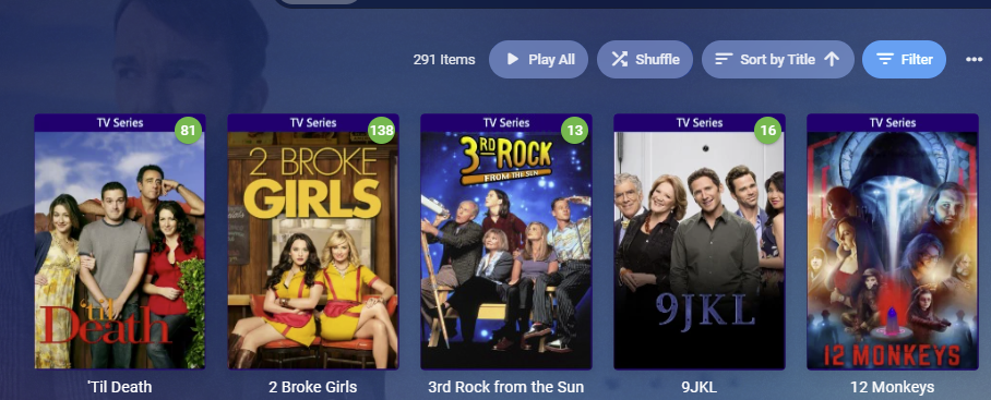

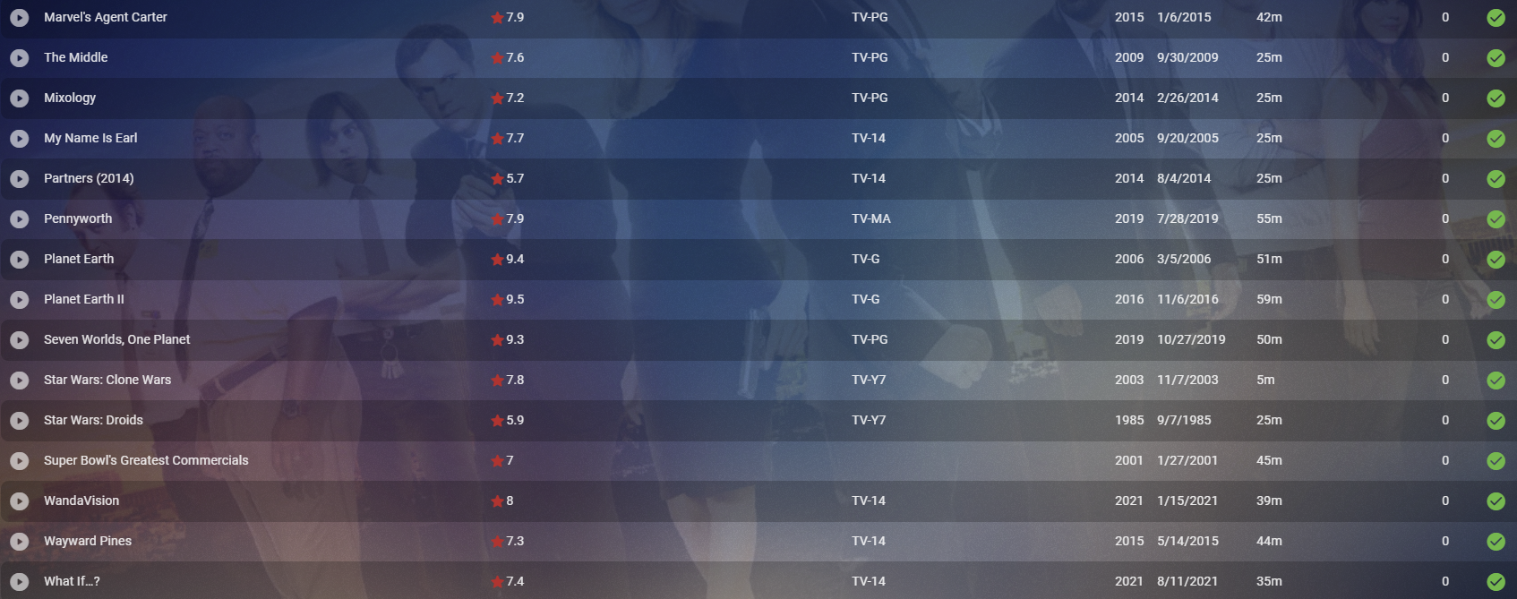

MBSki 1116 Posted June 19, 2022 Author Posted June 19, 2022 16 minutes ago, Luke said: Do you still see this with 4.7.3? Yes, I still see the problem. @cayars If you can look at the new database that I posted in the DM then here are a few shows to take a look at (these are all played, but don't get filtered): 12 Monkeys 30 Rock Abbott Elementary Aerial America Bad Batch The Black Donnellys Bless This Mess Boston Legal Burn Notice These are all the Played that show up correctly as Played. 12 Monkeys shows as Played in the table, but doesn't get filtered with the Unplayed filter. This is the view with an Unplayed filter set.
