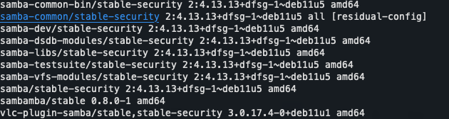

mike3821 67 Posted September 1, 2022 Posted September 1, 2022 (edited) Found something of interest. I changed my DVR path to local storage instead of my shared folder. It appears I can watch currently recorded TV now. I was reviewing the logs and I was getting Access Denied Permissions? Strange, since it can create recordings and I can also watch recordings... Picture below shows when mapped via CIFS off Debian 11. Edited September 1, 2022 by mike3821

mike3821 67 Posted September 1, 2022 Posted September 1, 2022 40 minutes ago, Luke said: Hi, what does this tell us? Besides logs, would this not help any to know the versions. Maybe cifs is a better option to see? I recall issues with samba/cifs a few Emby versions back. Maybe still issues lingering?
