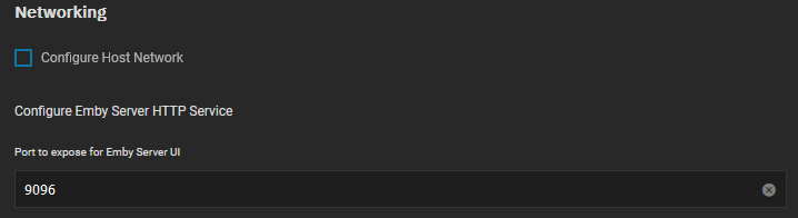

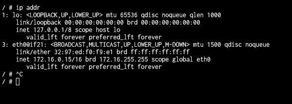

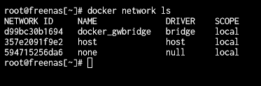

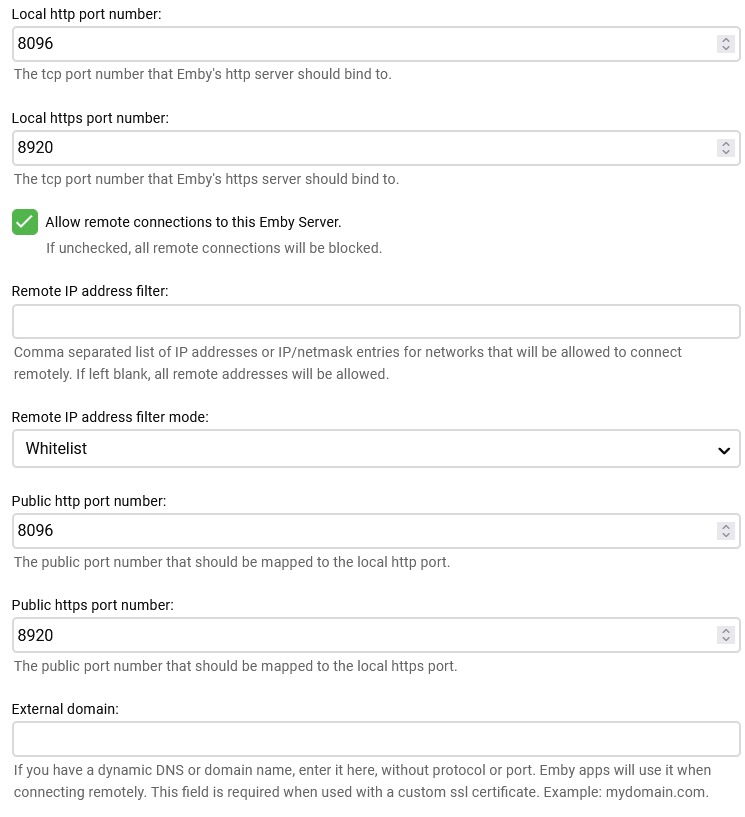

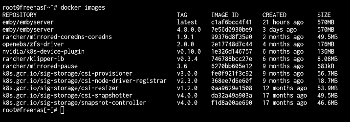

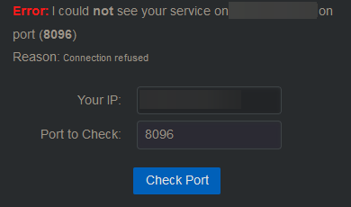

Bottomnotc 1 Posted May 27, 2022 Posted May 27, 2022 Hello all I have recently been having issues connecting remotely to my Emby instance ever since upgrading from Truenas CORE to Truenas Scale. I initially set up Emby through the built in apps (4.8.0.0_1.0.3) and was able to set up hosts paths to see media quite easily, no issues there. The issue I have been struggling with the past few days is being able to access this server remotely. I am able to access the server correctly on LAN through the address http://192.168.0.197:9096 I have gone through the support articles for Connectivity and Remote Setup and have still had no luck. Through my router, I have ports 8096, 8920 forwarded through 192.168.0.197 TCP I've checked Can you see me port 8096 when Emby is running, no success I do however find it interesting it says Connection refused instead of Connection timed out, that could possibly have something to do with it. I'm almost certain my ISP isn't using CG-NAT, as I'm able to port forward other services fine, and when running tracert (my external IP) there is only 1 hop ip addr inside pod: Spoiler docker images: Spoiler docker ps: Spoiler docker network ls: Spoiler ports forwarded on router: Spoiler firewall on router: Spoiler container application events: 2022-05-27 11:42:25 Started container emby 2022-05-27 11:42:24 Created container emby 2022-05-27 11:42:21 Container image "emby/embyserver:4.8.0.0" already present on machine 2022-05-27 11:42:21 Add eth0 [172.16.0.42/16] from ix-net Successfully assigned ix-emby/emby-595bc56cc8-qv9mj to ix-truenas 2022-05-27 11:42:17 Created pod: emby-595bc56cc8-qv9mj 2022-05-27 11:42:17 Scaled up replica set emby-595bc56cc8 to 1 2022-05-27 11:34:38 Stopping container emby 2022-05-27 11:34:38 Deleted pod: emby-595bc56cc8-fkrvp Also, allow remote connections to this Emby server is also checked. If anybody has additional steps I can take to help troubleshoot, or possibly something that I'm overlooking; any information is very much appreciated!

Solution Luke 42245 Posted May 28, 2022 Solution Posted May 28, 2022 Ok it's actually port 9096 in the log but look at your router port forwarding. 1
Bottomnotc 1 Posted May 28, 2022 Author Posted May 28, 2022 (edited) Alright, I forwarded 9096, connecting remotely seems to be fixed now! In the Emby networking settings, I left the ports as 8096 and 8920. Port 9096 is the default port when creating the Emby application through Truenas (and can't be changed to anything < 9000) ---- I plan on configuring a reverse proxy +domain name and pointing it at this server, is there any changes you suggest I make before I proceed? Thanks for your help thus far Luke Edited May 28, 2022 by Bottomnotc
