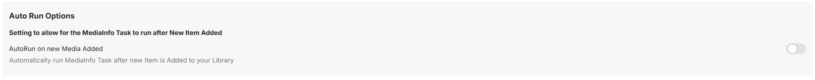

rbjtech 5345 Posted May 17, 2025 Posted May 17, 2025 19 minutes ago, sh0rty said: Is this true? All my 1080p files with DV/HDR are tagged correctly. I'm using MediaInfo 24.05 and mkvtoolnix 70.0.0. Video display settings are all enabled. @NormanosYeah experience the same since the Media Toolbox task is triggered by the library scan, when enabled, butit seems there is no trigger from Toolbox back to Library Scan so it can rescan the file changes. I circumvented this by setting up a scheduled task for a library scan every hour. Agreed - there is something where we excluded 1080p I just can't remember what for lol. I just checked the code and indeed it should cater for any resolution - incl 720p. Anything below this is just tagged as SD. It just 'builds' each media item into the new title - so yes even SD HDR is technically possible haha. 1
rbjtech 5345 Posted May 17, 2025 Posted May 17, 2025 25 minutes ago, sh0rty said: @NormanosYeah experience the same since the Media Toolbox task is triggered by the library scan, when enabled, butit seems there is no trigger from Toolbox back to Library Scan so it can rescan the file changes. I circumvented this by setting up a scheduled task for a library scan every hour. ah right - with you. I don't have that set - because as you say, it will run it on adding a new item BUT if you add more than one, it won't run it again. As part of an import script - after adding all the items - I then kick off the schedule (mediainfo) to process them all at once. Running as a normal schedule works as well, but you obviously won't get the results until the schedule has next run. Some improvment needed on the wording here or functionally how it works - agreed .. I'll add to the list. 1

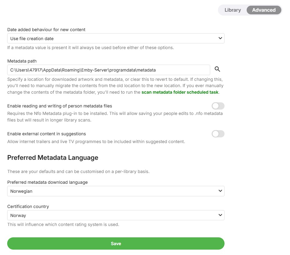

PeteGul 41 Posted September 7, 2025 Posted September 7, 2025 I want to make emby show my audio cedecs etc, like this addon doing. But I have not tried it yet, this bacause I can't find the setting for "Embedded track title display". This is gone in the Beta server.. Is there an way?
lorac 120 Posted September 7, 2025 Posted September 7, 2025 I wouldn't concern yourself with that. Install the plugin and give it a go. Then open your embyserver log in notepad ++ and you should see entries related to mediainfo. 1
rbjtech 5345 Posted September 8, 2025 Posted September 8, 2025 23 hours ago, PeteGul said: I want to make emby show my audio cedecs etc, like this addon doing. But I have not tried it yet, this bacause I can't find the setting for "Embedded track title display". This is gone in the Beta server.. Is there an way? Ah - you are correct - that option is no longer there. I *think* the track title is now used by default on most Emby clients, so it no longer really matters as the MKV track 'title' will now be shown anyway. Worst case, you can actually turn it on via a config file, system.xml in programdata\config <EnableOriginalTrackTitles>true</EnableOriginalTrackTitles>
