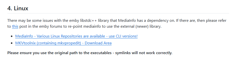

robsch 45 Posted November 21, 2024 Posted November 21, 2024 38 minutes ago, robsch said: It is the Plugin Catalogue version. I'll try the manual edit / shutdown method. Is the catalog or the dll the preferred method. (Well, for Linux) !!Update & Solved!! So I did some digging on the OS level. The version of mediainfo and mkvpropedit were symlinks to the actual binaries where were in /bin. As soon as I changed it to /bin/mediainfo and /bin/mkvpropedit (in the GUI), it worked like a champ. For anyone using a *nix, check your paths and make sure they are not symlinked to an path! 1
supermood 71 Posted November 21, 2024 Posted November 21, 2024 and one hint from me it's also running again auto update the emby docker with synology tools and 10 restarts are not enough if you have the moded version. I needed a repull and recreate via portainer 1
rbjtech 5345 Posted November 22, 2024 Posted November 22, 2024 (edited) @robsch @supermood thanks for the updates ! I've updated the wiki to include the symlink hint to help others. https://github.com/Cheesegeezer/MediaInfoWiki/wiki/Various-OS-Installation-Help#4-linux Edited November 22, 2024 by rbjtech updated 1 1

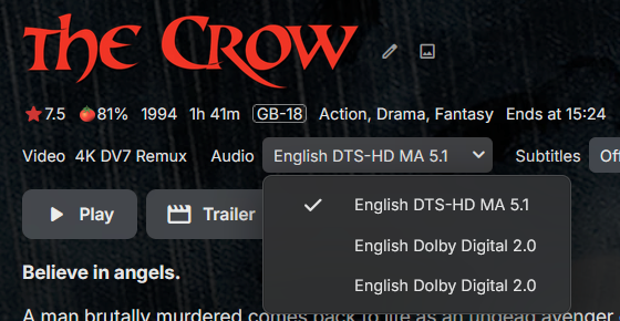

lardners 8 Posted November 29, 2024 Posted November 29, 2024 Can you explain the current logic behind detecting tracks as commentary? For example, it worked here for Spinal Tap: But not for The Crow: I would imagine it looks for stereo tracks, that are not default or something along those lines?
rbjtech 5345 Posted November 29, 2024 Posted November 29, 2024 57 minutes ago, lardners said: Can you explain the current logic behind detecting tracks as commentary? For example, it worked here for Spinal Tap: But not for The Crow: I would imagine it looks for stereo tracks, that are not default or something along those lines? Hi - See - https://emby.media/community/index.php?/topic/126561-support-for-mkv-commentary-flag/ Unfortunately, even MediaInfo does not support the commentary 'flag' - or I would have used that in parallel for detection. If Emby ever supports the commentary MKV flag (via ffmpeg) - then I'll update the plugin to work with it - but this is the only option thus far. btw - I should actually update this to provide the option to keep the actual full text ie 'Commentary By the Director Joe Blogs' and put that in the brackets rather than just the word Commentary - but I guess it's better than nothing.
lardners 8 Posted November 29, 2024 Posted November 29, 2024 50 minutes ago, rbjtech said: Hi - See - https://emby.media/community/index.php?/topic/126561-support-for-mkv-commentary-flag/ Unfortunately, even MediaInfo does not support the commentary 'flag' - or I would have used that in parallel for detection. If Emby ever supports the commentary MKV flag (via ffmpeg) - then I'll update the plugin to work with it - but this is the only option thus far. btw - I should actually update this to provide the option to keep the actual full text ie 'Commentary By the Director Joe Blogs' and put that in the brackets rather than just the word Commentary - but I guess it's better than nothing. Ah ok, I understand how it works now. The Crow never had the word 'commentary' in the secondary track title (before being processed by Mediainfo), but Spinal Tap did. Thank you
