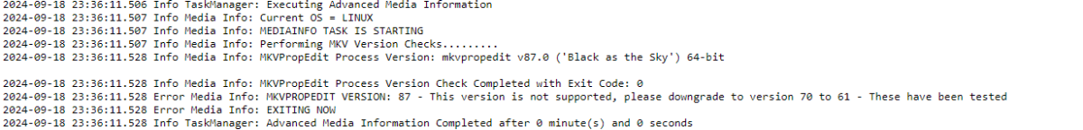

EasyCodex 1 Posted September 18, 2024 Posted September 18, 2024 I have a question and what should be put in MKVPropEdit File Path when I have Linux?
EasyCodex 1 Posted September 18, 2024 Posted September 18, 2024 (edited) I have Ubuntu 24.04 for reasons that the Nvidia did not work for me. Edited September 18, 2024 by EasyCodex

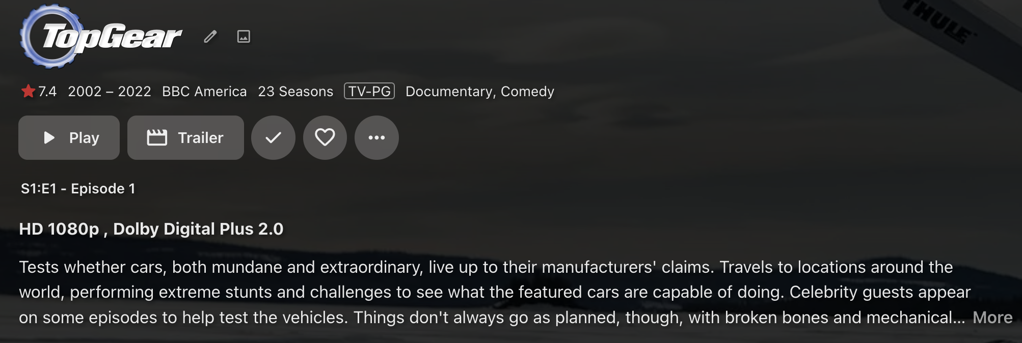

keemy 25 Posted September 19, 2024 Posted September 19, 2024 I noticed on v1.0.1.43 that the usual audio and video tags are getting added to tagline at the series level. Individual episodes still have the usual tags. Is this intended behavior?
Teddyknuddel 136 Posted September 19, 2024 Posted September 19, 2024 2 hours ago, keemy said: I noticed on v1.0.1.43 that the usual audio and video tags are getting added to tagline at the series level. Individual episodes still have the usual tags. Is this intended behavior? Yes, it is. But it can be deactivated in the plugin.
rbjtech 5345 Posted September 19, 2024 Posted September 19, 2024 (edited) 2 hours ago, keemy said: I noticed on v1.0.1.43 that the usual audio and video tags are getting added to tagline at the series level. Individual episodes still have the usual tags. Is this intended behavior? Yes - It uses the 'tagline' field only available on the root of the show to display this information. The idea being that you can see the 'quality' of the show without needing to go into the Seasons and/or Episodes. Yes, each episode 'may' be a different quality - but the majority of people will have/want the same quality across all the seasons/shows. ie all 4K, all HD 1080p etc It gets the detail from S1E1 - and uses that. Seasons and Episodes don't have the tagline field - thus it's not used for those. I should probably create a toggle to turn this on/off - but I find it VERY useful when looking at TV series to see what quality it is - another 'Emby missing detail' that this plugin can provide .. Edited September 19, 2024 by rbjtech
rbjtech 5345 Posted September 19, 2024 Posted September 19, 2024 9 hours ago, EasyCodex said: I have Ubuntu 24.04 for reasons that the Nvidia did not work for me. As per the error - you are using MKVToolNix (mkvpropedit) v87 which is not supported as it (not the plugin) corrupts the mkv files. Either use and earlier or later version and there should be no issues.
keemy 25 Posted September 19, 2024 Posted September 19, 2024 11 minutes ago, rbjtech said: Yes - It uses the 'tagline' field only available on the root of the show to display this information. The idea being that you can see the 'quality' of the show without needing to go into the Seasons and/or Episodes. Yes, each episode 'may' be a different quality - but the majority of people will have/want the same quality across all the seasons/shows. ie all 4K, all HD 1080p etc It gets the detail from S1E1 - and uses that. Seasons and Episodes don't have the tagline field - thus it's not used for those. I should probably create a toggle to turn this on/off - but I find it VERY useful when looking at TV series to see what quality it is - another 'Emby missing detail' that this plugin can provide .. Yes making this optional is preferred. I see the usefulness but personally not a fan of the text aesthetic. Maybe if it was icons but I know that's probably outside of the scope of the plugin. To be clear I like having tags for episodes and find them very useful especially for filtering through my library but just not a fan of the tagline description.
rbjtech 5345 Posted September 19, 2024 Posted September 19, 2024 (edited) 3 minutes ago, keemy said: Yes making this optional is preferred. I see the usefulness but personally not a fan of the text aesthetic. Maybe if it was icons but I know that's probably outside of the scope of the plugin. To be clear I like having tags for episodes and find them very useful especially for filtering through my library but just not a fan of the tagline description. ok - fair enough - I'll add an option to turn it off .. Icons would be nice - Luke originally looked into this but then it never went anywhere .. thus my 'hack' to at least give you the info. Edited September 19, 2024 by rbjtech 1
