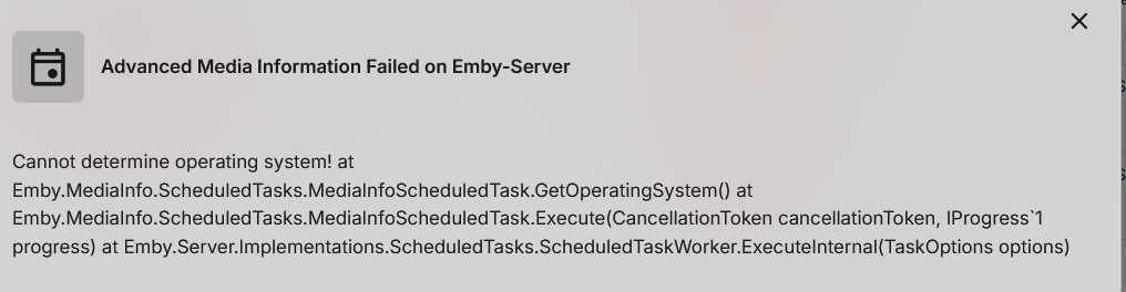

hjason7812 35 Posted August 22, 2024 Posted August 22, 2024 i would love for this to work on my server but it keeps failing the advanced media information task and i can't figure out how to fix this for it to run..
MrLinford 62 Posted August 23, 2024 Posted August 23, 2024 19 hours ago, hjason7812 said: i would love for this to work on my server but it keeps failing the advanced media information task and i can't figure out how to fix this for it to run.. What are you running EMBY Server on?
hjason7812 35 Posted August 24, 2024 Posted August 24, 2024 18 hours ago, MrLinford said: What are you running EMBY Server on? i have it installed on truenas core

hjason7812 35 Posted September 10, 2024 Posted September 10, 2024 Is there any fixes on the truenas core issue i am having yet? It will not do the scan it keeps failing and i have the media info cli installed and the plug in pointed to the cli update but still always fails.. Someone has to have a fix or something for this? i know everyone is running scale now but i can't use scale for some reason plugins will not install for me

hjason7812 35 Posted September 10, 2024 Posted September 10, 2024 On 8/19/2024 at 7:46 AM, rbjtech said: The other factor is people that know how to load a dll, are also the people that can generally fault find themselves. I updated this plugin for my own needs to try and help fill gaps in the core system and shared the updates - with a big disclaimer that it was only tested on my own system. For most community derived free plugins, i would say little testing outside of the devs own system has been done. This is also the reason I have not looked to update the catalogue version. For paid for plugins, then these must be in the catalogue but there is a little more testing responsibility and support required imho. Btw I also wrote the wiki page to try and help with the install and support queries - this is still maintained by me. MEDIAiNFO WIKI PAGE https://github.com/Cheesegeezer/MediaInfoWiki/wiki Are you the dev for the media toolbox? Because if you are please help me with my issue that is driving me crazy..
