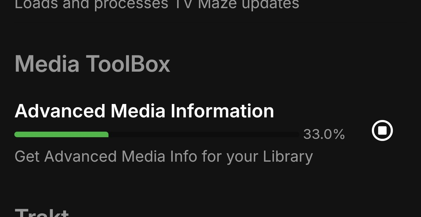

supermood 71 Posted May 14, 2024 Posted May 14, 2024 tataaaa! something is happening! yipiajeh!! it's def more than a sec. it's running 3 min and has 5% I would say time for champagne!! i will write in 30m hopefully with a smile
supermood 71 Posted May 14, 2024 Posted May 14, 2024 (edited) this looks just BEAUTIFUL!! in case my nas is still running in one hour, could you make me huge favor and post only the ssh commands I have to perform after an emby docker update? I have absolutely no clue which one you mean in your guide sorry!! thanks!!! Edited May 14, 2024 by supermood Pic 1

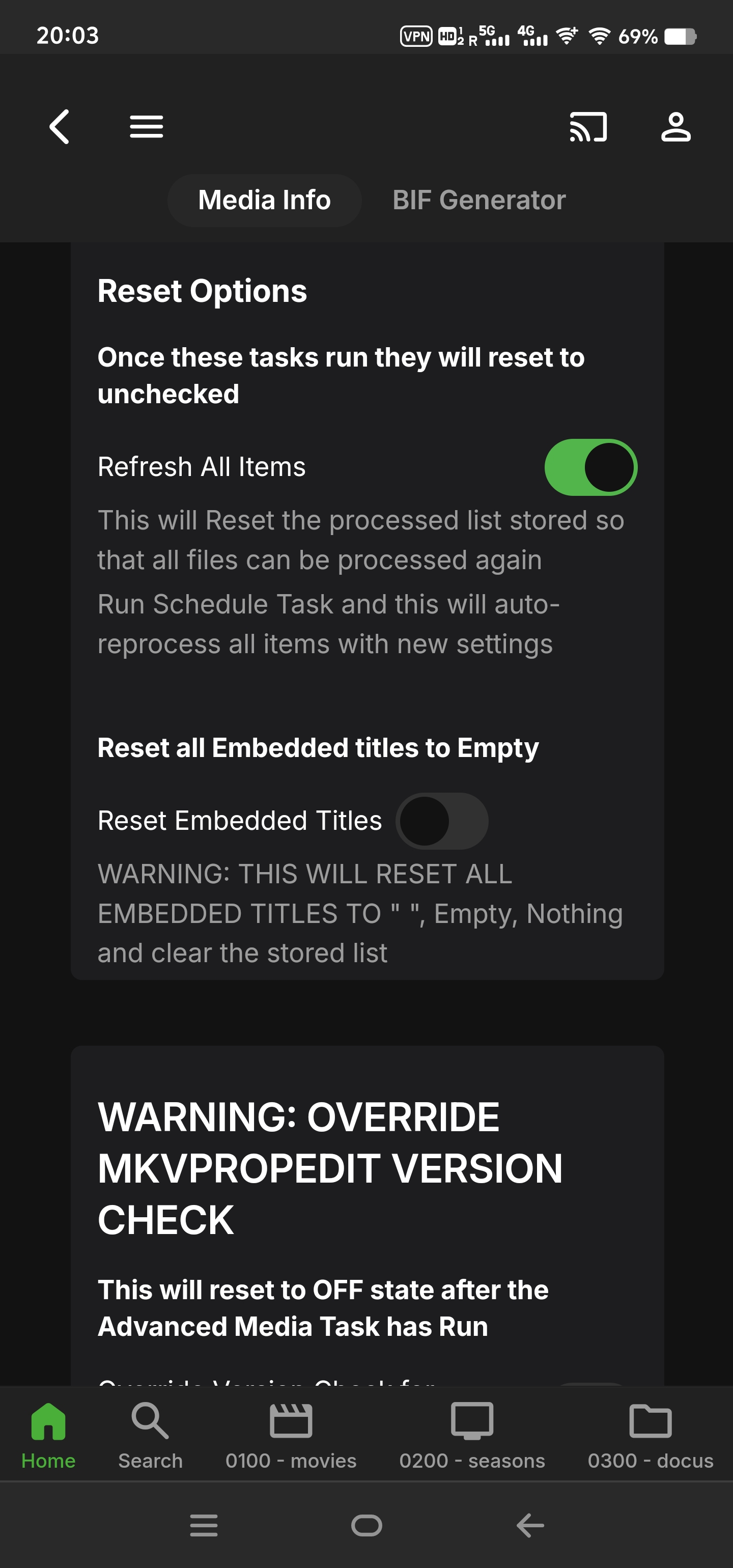

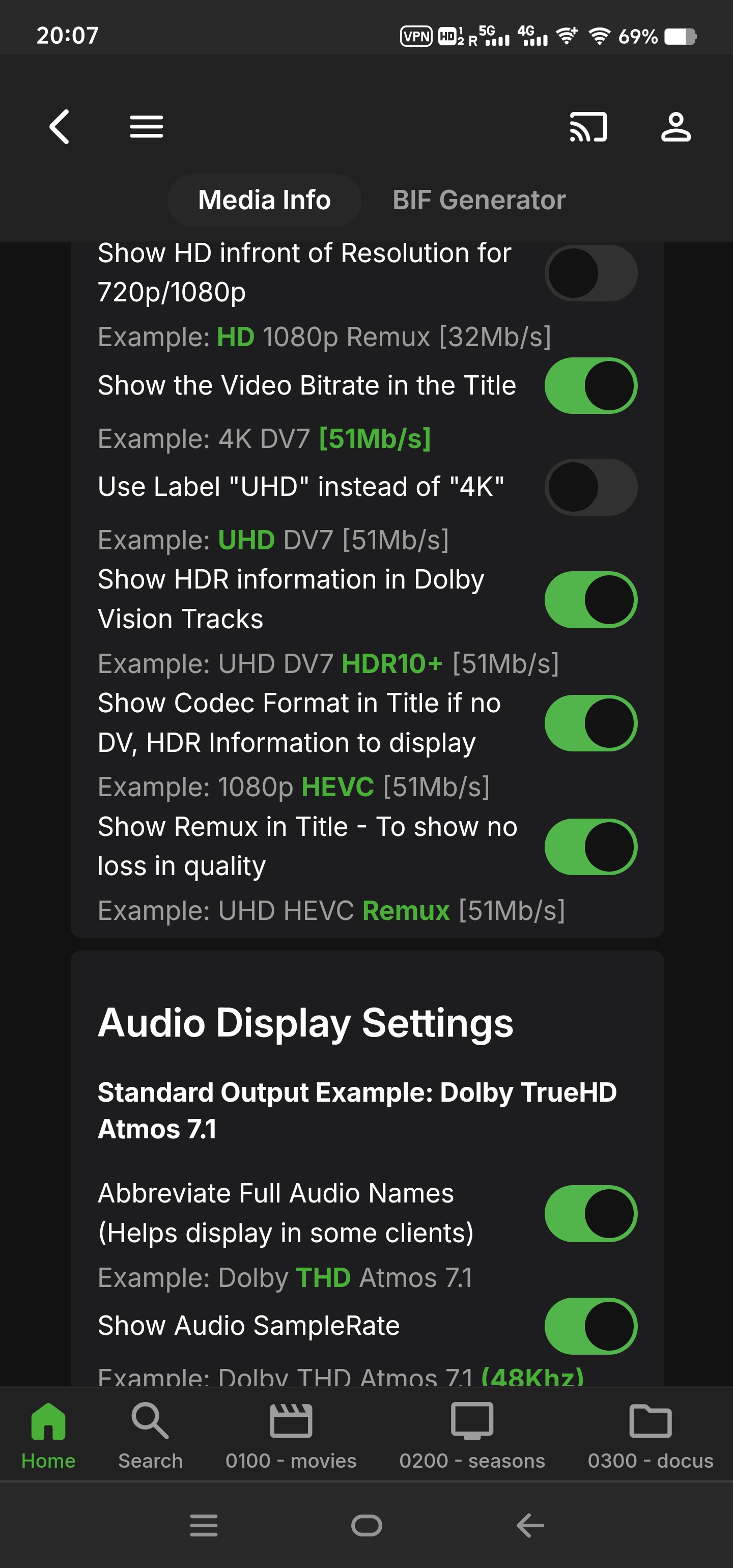

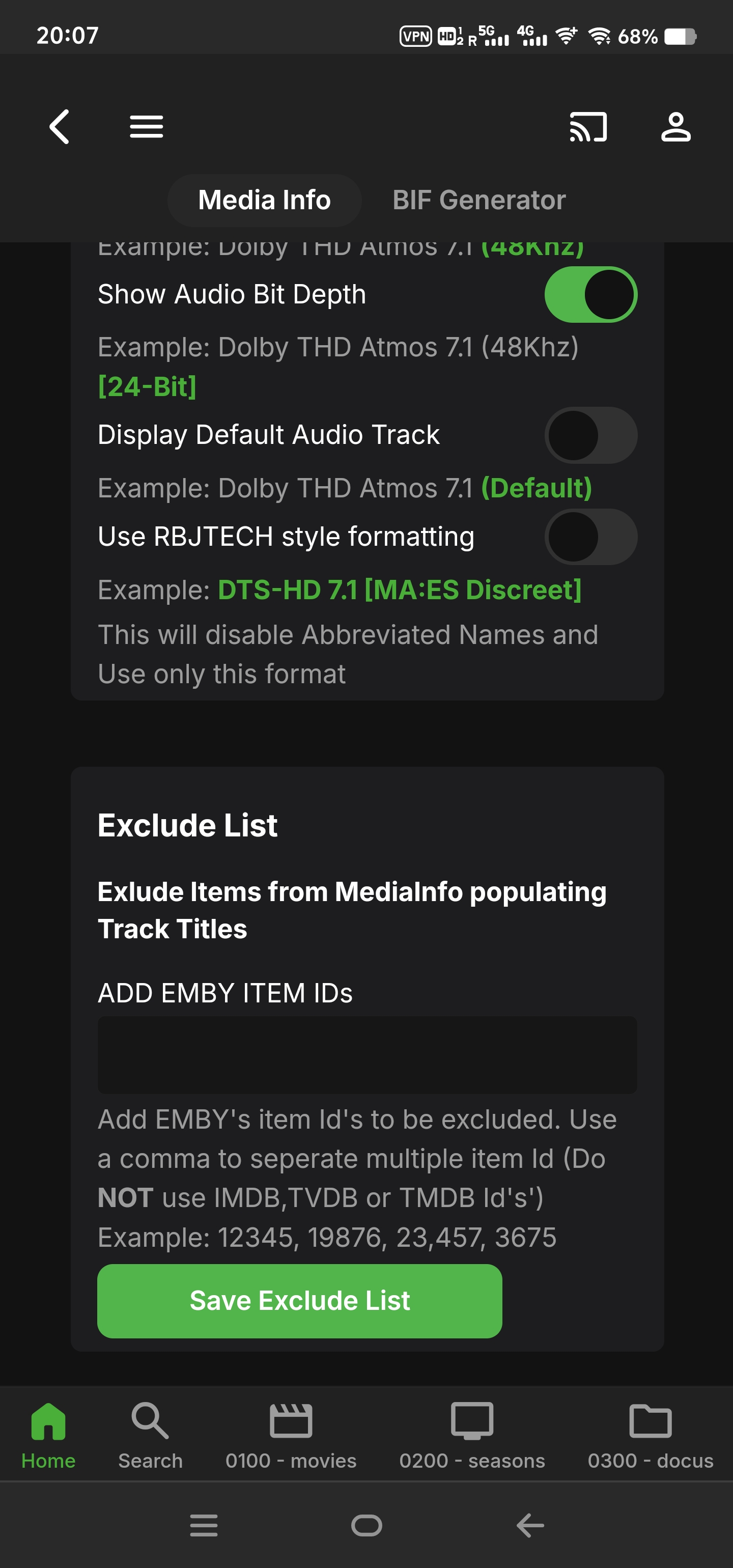

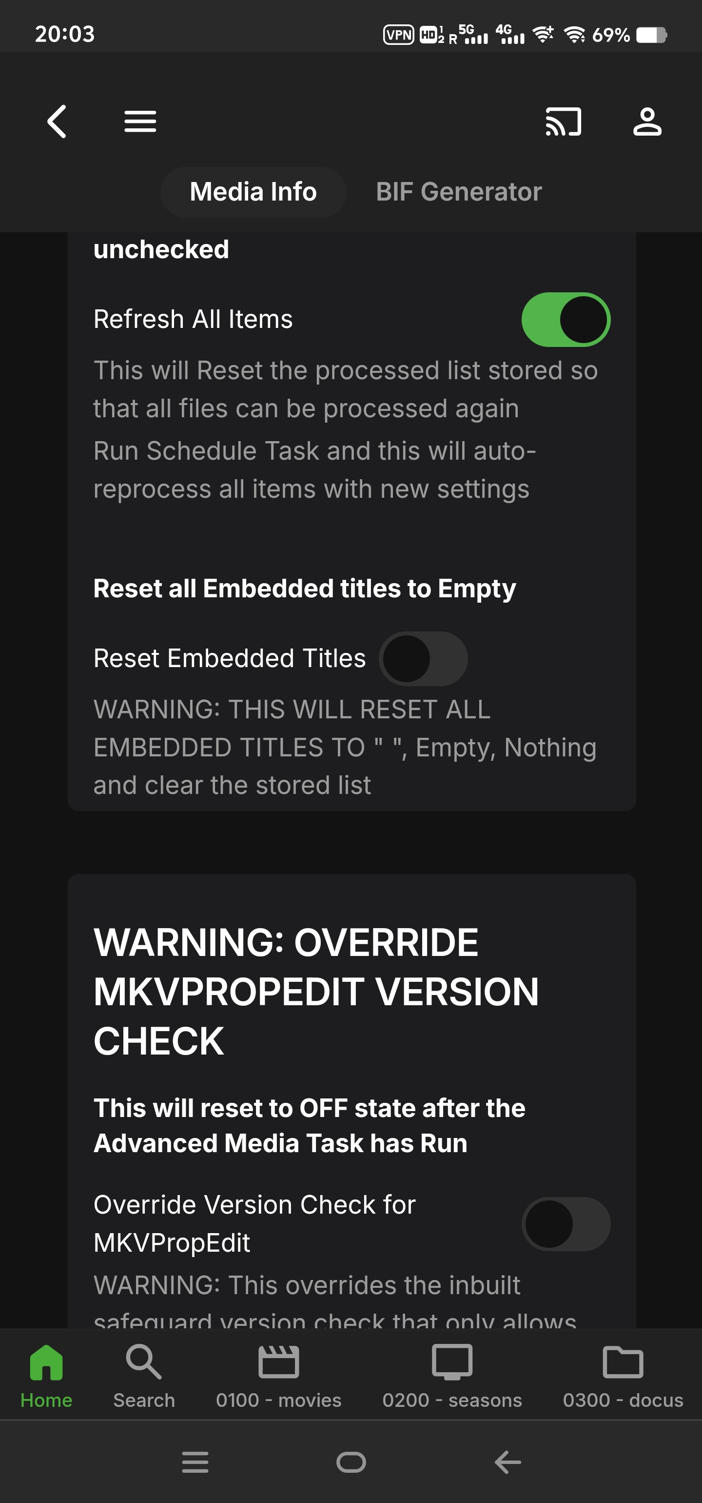

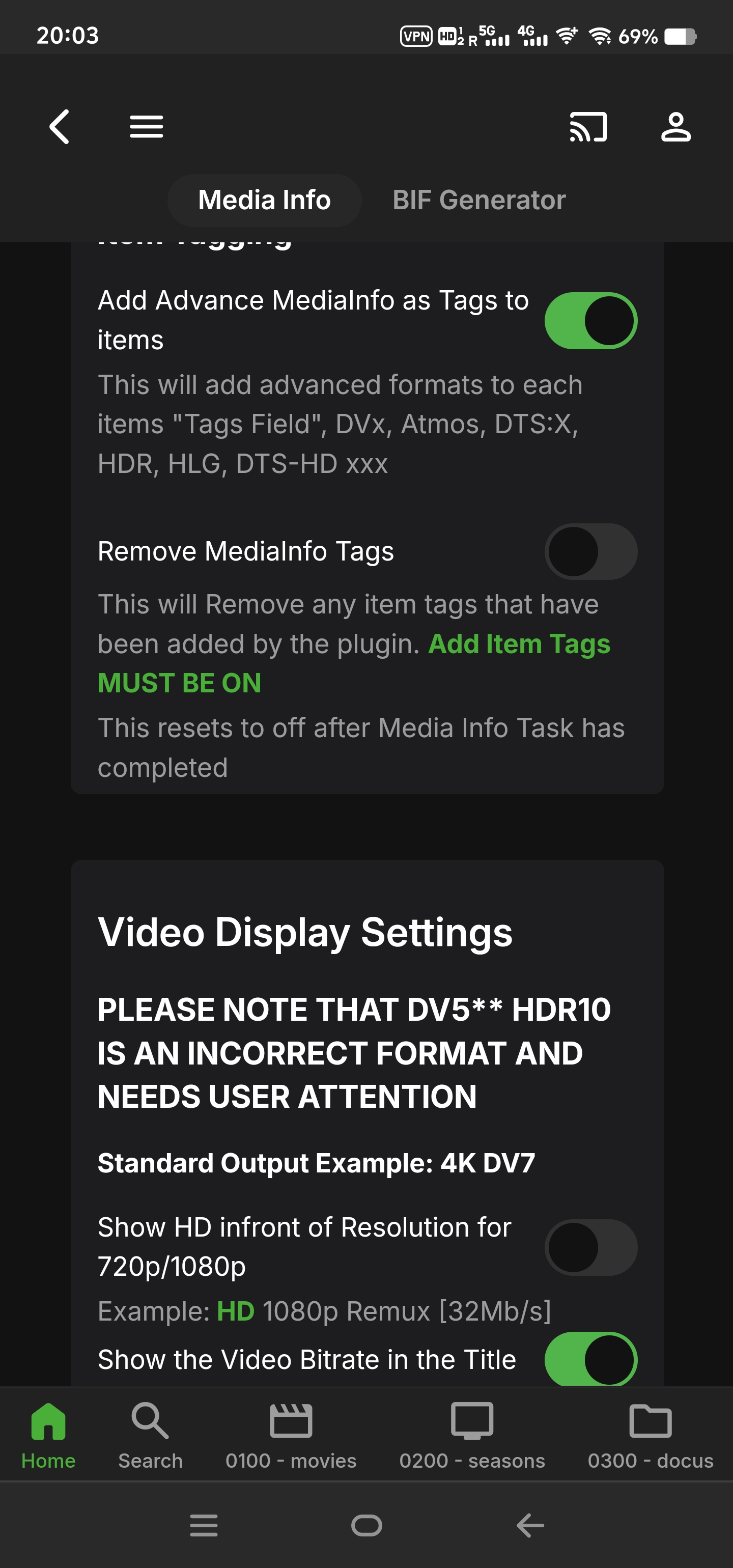

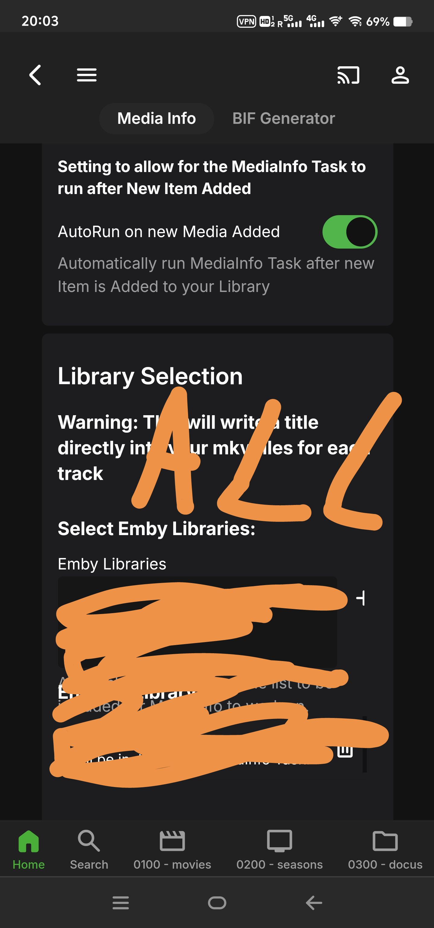

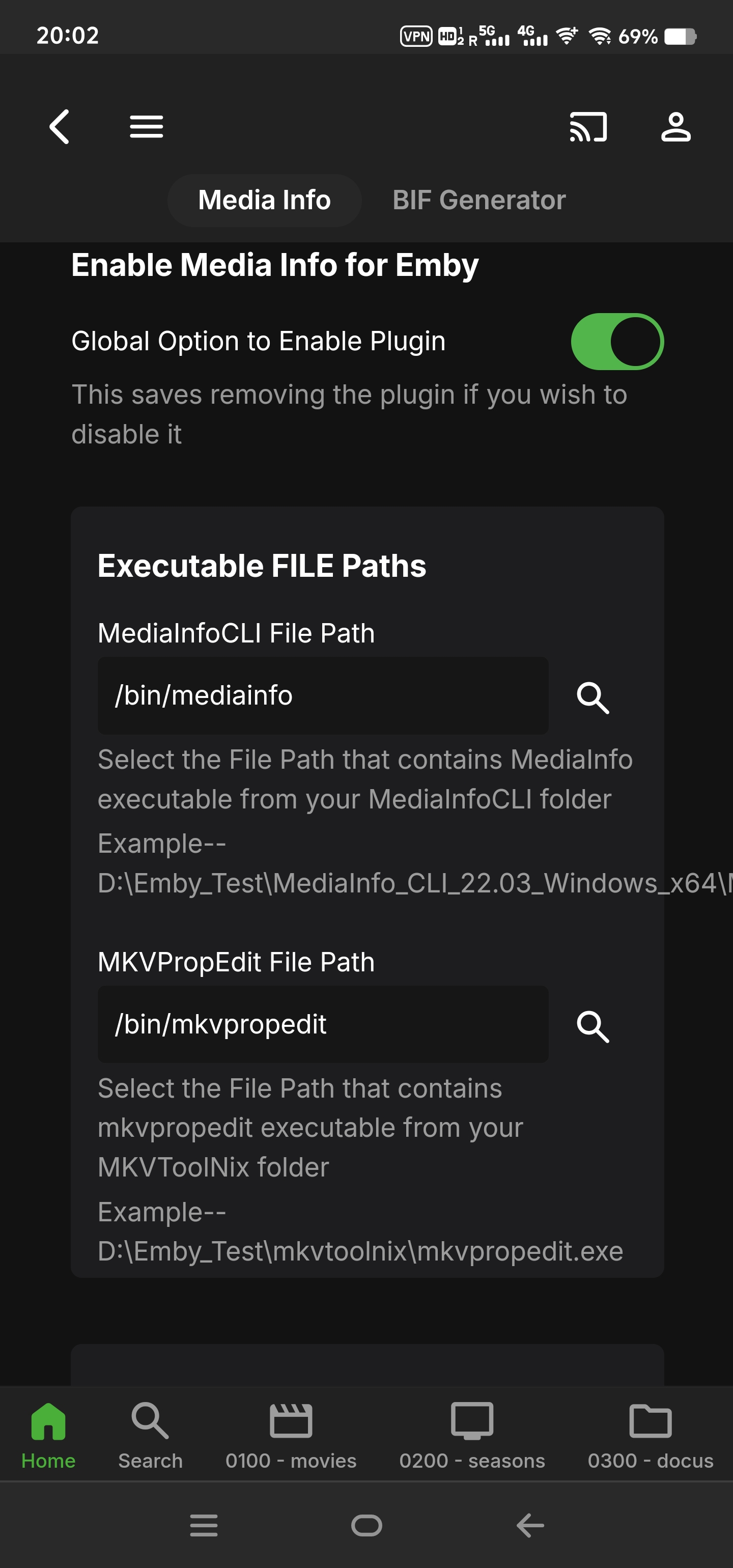

rbjtech 5345 Posted May 14, 2024 Posted May 14, 2024 While we are waiting what options did you use on the MediaInfo Plugin ? Maybe do a screenshot ..?
supermood 71 Posted May 14, 2024 Posted May 14, 2024 (edited) sure. I guess standard besides the different tags? honestly I tried 10 times yesterday with a test lib, and only a few tags, without success. today I completely forget and later I will have it all for all libs Edited May 14, 2024 by supermood
