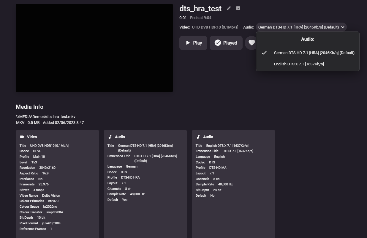

MagicDoubleM 121 Posted June 1, 2023 Posted June 1, 2023 (edited) Found another one that slips through the audiotrack-treatment, this time it's a DTS variant: sample.json sample.mkv Edited June 1, 2023 by MagicDoubleM
rbjtech 5345 Posted June 1, 2023 Posted June 1, 2023 8 minutes ago, MagicDoubleM said: Found another one that slips through the audiotrack-treatment, this time it's a DTS variant: sample.json 7.99 kB · 0 downloads sample.mkv 471.59 kB · 0 downloads Hmm - Odd - I did include DTS HRA - but the Additional Format for yours suggests it's DTS XXCH .. Let me take a look tomorrow - if needs be we'll just add it as an alternative format - that's easy enough. Thanks ! 1

rbjtech 5345 Posted June 2, 2023 Posted June 2, 2023 12 hours ago, MagicDoubleM said: Found another one that slips through the audiotrack-treatment, this time it's a DTS variant: sample.json 7.99 kB · 1 download sample.mkv 471.59 kB · 2 downloads Fixed .. Please let me know of any other specialist formats that may have slipped through the net ! This version contains the following changes (1.0.1.26) :- Fixes/Enhancements 1. DTS-HD HRA detection Fix 2. Add 'Remux' to Video Title if 'Remux' in the filename. (note case) - and the file was not previously classed as a Remux due to the bitrate. 3. Remove Spacing before Kb/s (now same as Mb/s) 4. Remove '-' on Bit Depth 5. Added UHD/4K to written Tags Known Bugs 1. Multi-video tracks do not get updated properly. (I attempted but couldn't get it to work - will need @Cheesegeezerfor this one I think). DLL below Emby.MediaInfo.dll 1

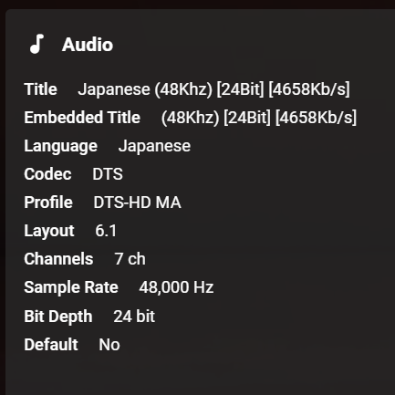

MagicDoubleM 121 Posted June 2, 2023 Posted June 2, 2023 Ok, I've found a few of those DTS-HD HRA tracks like above, but here is something else, DTS-HD MA 6.1 sample.json sample.mkv
rbjtech 5345 Posted June 2, 2023 Posted June 2, 2023 (edited) 55 minutes ago, MagicDoubleM said: Since you asked for it , I walked into that one didn't I .. haha ! Yea something odd going on with HRA - I think i'm going to add both the 'AdditionalFeatures' as can be seen by both your samples below - both are DTS-HD HRA - but one uses 'XBR' (what it used to use before I changed it..) and one has 'XXCH' - which is what it now uses ... So gonna add both ... Edited June 2, 2023 by rbjtech 1
rbjtech 5345 Posted June 2, 2023 Posted June 2, 2023 (edited) 6 minutes ago, MagicDoubleM said: Ok, I've found a few of those DTS-HD HRA tracks like above, but here is something else, DTS-HD MA 6.1 sample.json 4.42 kB · 0 downloads sample.mkv 687.47 kB · 0 downloads so that's a new one on me - that one is 'ES XCh XLL' .. wow If you can check them all - then I'll add them all at once - no point in doing this piece meal ... Thanks ! Edited June 2, 2023 by rbjtech 1

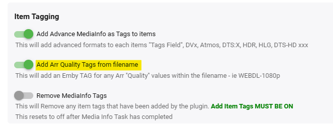

rbjtech 5345 Posted June 3, 2023 Posted June 3, 2023 (edited) Getting the hang of this c# now - so added some new functionality options which I've wanted for a long time .. The Plugin now reads the Arr 'Quality' type and adds an an Emby Tag. It does not add to the track title, as that would be too much. But you can now sort on the 'Quality' within emby based on this Tag. string[] ArrQuality = new string[] { "WORKPRINT", "CAM", "TELESYNC", "TELECINE", "REGIONAL", "DVDSCR", "SDTV", "DVD", "DVD-R", "WEBDL-480p", "WEBRip-480p", "Bluray-480p", "Bluray-576p", "HDTV-720p", "WEBDL-720p", "WEBRip-720p", "Bluray-720p", "HDTV-1080p", "Raw-HD", "WEBDL-1080p", "WEBRip-1080p", "Bluray-1080p", "Remux-1080p", "HDTV-2160p", "WEBDL-2160p", "WEBRip-2160p", "Bluray-2160p", "Remux-2160p", "BR-DISK", "Raw-HD", "Bluray-2160p Remux" }; ... if (config.AddArrTags) { var itemFilename = mediaSource.Path; foreach (var StringToFind in ArrQuality) { bool b = itemFilename.Contains(StringToFind); if (b) { Log.Debug("Found Arr Quality in Filename.."); tempList.Add(new LinkedItemInfo { Name = StringToFind }); } } } @Cheesegeezer- it appears to work just fine, but there is probably a better way to do this ? Any thoughts of coding wisdom or wizardry ? ------ Plugin version - v1.0.1.28 Emby.MediaInfo.dll Edited June 3, 2023 by rbjtech 1

MagicDoubleM 121 Posted June 3, 2023 Posted June 3, 2023 Hmm, yeah, of course I did rename the profiles in *arr... 1
MagicDoubleM 121 Posted June 3, 2023 Posted June 3, 2023 (edited) I'd propose splitting these tags up into the name and resolution: "WORKPRINT", "CAM", "TELESYNC", "TELECINE", "REGIONAL", "DVDSCR", "SDTV", "DVD", "DVD-R", "WEBDL", "WEBRip", "HDTV" , "Bluray", "Remux" , "Raw-HD", "BR-DISK" I'm not sure if REGIONAL, Raw-HD and BR-DISK do make any sense in practical use, while some other strings like "DVDRip" might be worthy to add to the mix somehow. Like DVDRip could result in "DVD" and "tvrip" depending on resolution in SDTV or HDTV. And then a second tag for resolutions: "480p", "480i", "576p", "576i", "720p", "1080p", "1080i", "2160p", "4320p" Edited June 3, 2023 by MagicDoubleM
rbjtech 5345 Posted June 4, 2023 Posted June 4, 2023 8 hours ago, MagicDoubleM said: I'd propose splitting these tags up into the name and resolution: "WORKPRINT", "CAM", "TELESYNC", "TELECINE", "REGIONAL", "DVDSCR", "SDTV", "DVD", "DVD-R", "WEBDL", "WEBRip", "HDTV" , "Bluray", "Remux" , "Raw-HD", "BR-DISK" I'm not sure if REGIONAL, Raw-HD and BR-DISK do make any sense in practical use, while some other strings like "DVDRip" might be worthy to add to the mix somehow. Like DVDRip could result in "DVD" and "tvrip" depending on resolution in SDTV or HDTV. And then a second tag for resolutions: "480p", "480i", "576p", "576i", "720p", "1080p", "1080i", "2160p", "4320p" It's just using the standard Arr quality values - cut'n'pasted from the Apps - the idea being if the Arr has renamed the file, then that's what the tag should be. These are not manually added items. If you want resolution and interlace, then you can always get that from the actual emby fields. ? It's possible to have an CSV field on the Plugin config - and it checks for those as well - maybe that's another route - you can put what you want then.. 1
