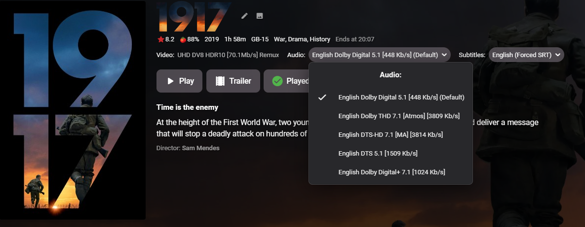

Teddyknuddel 136 Posted May 31, 2023 Posted May 31, 2023 Would it be possible to display the audio bitrate as well? I think it's here that you can clearly see which audio track has decent power.
rbjtech 5345 Posted May 31, 2023 Posted May 31, 2023 (edited) 2 hours ago, Teddyknuddel said: Would it be possible to display the audio bitrate as well? I think it's here that you can clearly see which audio track has decent power. Possibly .. just having a dabble myself to add this - the good news is because @Cheesegeezerwrote such an awsome structured Plugin to begin with - adding ANYTHING from the mediainfo JSON output can easily be added (it gets all the fields, not just those displayed in the Emby config) .. I've got the Audio Bitrate value showing in the debug log and added the GUI (below), now just need to append the value if the checkbox is true.. brb .. edit .. ok - so got there in the end - JavaScript is not nice ... Just need to do a little bit more testing - but there is now an option to add Audio Bitrate - I'll post the DLL shortly ... Edited May 31, 2023 by rbjtech 2 1
rbjtech 5345 Posted May 31, 2023 Posted May 31, 2023 Appears to be working a treat DLL version is 1.0.1.25 Please take a copy of your old DLL before replacing with the attached - and clear your browser cache to re-load it. Toggle on/off the Audio bitrate I don;t use the Sample/Bit depth myself - so feedback on formatting welcome - it's probably a bit much if you ticked them all .. Enjoy.. .. and @Cheesegeezer.. I will learn how to do this in GitHub honest as this is all on my private fork .. Emby.MediaInfo.dll 1 2

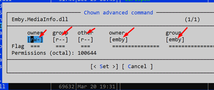

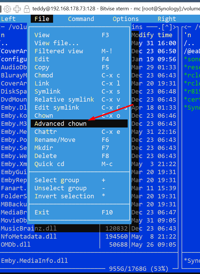

Teddyknuddel 136 Posted May 31, 2023 Posted May 31, 2023 @rbjtechCan you possibly tell me where the path for the MediaInfo.dll is on the Synology?
rbjtech 5345 Posted May 31, 2023 Posted May 31, 2023 56 minutes ago, MagicDoubleM said: I just noticed an unexpected behavior in regards to "Remove MediaInfo Tags". Basically, it's like this. I had a DV7 files, which I converted to DV8. Now, when I update the file it gets properly tagged with DV8, and the DV7 tag stays. No problem I thought, let's remove the tags and build them from ground. The task indeed removes the tags, but leaves the DV7 tag untouched. So, I guess the logic is, that "Remove MediaInfo Tags" only removes the tags that do match to the file. I see that this is a safety measure, but... Well yeah, it results in a few ghost tags here. Yea as you've gathered this is to avoid removing tags that the Plugin did not originally populate. Let me give this some thought as I'm on the same journey actually, converting DV7 to DV8 .. 1 hour ago, MagicDoubleM said: And one more thought, for the "remux" info, it wouldn't hurt to also check if the file-name has that string included, instead of solely relying on that bit-rate limit. I just saw a remux that didn't get marked as such (and it is a remux, I did it myself). ok - that could be something to add - if it's in the JSON output, then even better. 1
rbjtech 5345 Posted May 31, 2023 Posted May 31, 2023 3 minutes ago, Teddyknuddel said: @rbjtechCan you possibly tell me where the path for the MediaInfo.dll is on the Synology? I'm not 100% sure where that is on the Synology - but it's ..\programdata\plugins on Windows Because you'll need to manually load the DLL (as it's not from the catalogue) then I think you'll need to SSH/SCP the file - or wait for it to be updated in the Catalogue The wiki may provide more info https://github.com/Cheesegeezer/MediaInfoWiki/wiki https://github.com/Cheesegeezer/MediaInfoWiki/wiki/Various-OS-Installation-Help @FrostByte- Any help appreciated.
MagicDoubleM 121 Posted May 31, 2023 Posted May 31, 2023 (edited) 1 hour ago, rbjtech said: Yea as you've gathered this is to avoid removing tags that the Plugin did not originally populate. Let me give this some thought as I'm on the same journey actually, converting DV7 to DV8 .. ok - that could be something to add - if it's in the JSON output, then even better. Yup, it's in the JSON under "complete name" and "movie name". BTW, tiny detail, there is a space between the number and "kb/s" for audio, but no space for video. If you ask me, I'd go without a space everywhere and whould get rid of the "-" inbetween the number for bitdepth and "Bit". I know thats extremely picky... lol Edited May 31, 2023 by MagicDoubleM
Teddyknuddel 136 Posted May 31, 2023 Posted May 31, 2023 Thank you - worked. But you still have to customize user and group under the synology. Goes with the MidnightCommander (mc) over SSH on the Synology quite well. This must all be set like this - otherwise the plugin is lost in Emby 1

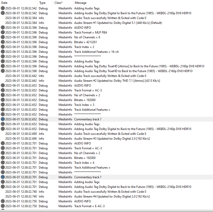

rbjtech 5345 Posted June 1, 2023 Posted June 1, 2023 Hi All, So I'm trying to add some logic to 'detect' commentary tracks. Unfortunately it's pretty rare to get these tagged in the MKV and even if they are, MediaInfo does not report this is the JSON output. So I've come up with a little logic that should automatically name these as such - and with a toggle to turn it on/off - may be another nice addition to the Plugin. Logic is this 1. Track must not be 'Default' 2. Track must not be the first Audio Track (incase the Default is another track) 3. Track must have only 2 Channels 4. Track must be AC3 Format (of all the Commentary tracks I have, they are all AC3 2.0) If all the above are true - then append [Commentary] after the channels - ie English Dolby Digital 2.0 [Commentary] What are peoples thoughts ? if (typeInfo.Default != "Yes" && trackIndex != "1" && typeInfo.Channels == "2" && typeInfo.Format == "AC-3") { Log.Debug("Commentary track ?",trackIndex); } Debug below - just testing the logic - appears to work as these are indeed both commentary tracks .. 1
MagicDoubleM 121 Posted June 1, 2023 Posted June 1, 2023 I like the idea, but would make that brute-force-algo optional, with a basic version only marking the tracks that are marked via mkv (if you find a way to get to that info). Additionally I'd look for strings in the naming of the track. Sometimes there is "commentary" to be found in there For a brute-force-algo: I'd also say there is always a track with the same language but a higher level of audio-quality to be found. So if there is an English AC3 2.0 track and an 5.1 track (AC3 or better), then it's highly possible the 2.0 is a commentary. If there is a track marked as original language (again an MKV tag thats probably not in the json) and there is a second track with the same language but only 2.0 AC3, then yeah, that's probably a commentary. Audio analyzing goes too far... and looking for subtitles (again maybe named) or even for keywords within the subtitles, are also ideas that will go way too far. 1
MagicDoubleM 121 Posted June 1, 2023 Posted June 1, 2023 Two more thoughts, relying on the codec might produce lots of miss-matches in cases, where a user has added additional audiotracks for streaming purposes (I did experiment myself with generating stereo counterparts to highres-audio).... It will miss commentary tracks that have been converted to another format (like AAC for example). Yeah, it's best suited for clean remuxes, totally with you on that. 1
rbjtech 5345 Posted June 1, 2023 Posted June 1, 2023 Some great thoughts there - thanks. Yea homebrew stuff may screw things up, but language is a good call. I strip everything non English which is why I hadn't thought of that scenerio .. If it gets included, then Yes this is totally optional - I'll add it to a toggle switch now I know how to add them .. haha btw - I've also added the 'Remux' from the filename now .. and also attempting to fix the multi-video track bug that just re-writes video track 0. I can see the issue but I'm just working out how to pass the correct video track to mkvpropedit ... yes I know not many files have multi video but the pesky 'MJPEG' are classed as Video tracks and that screws things up occassionally (I should just delete them..) ... 1
