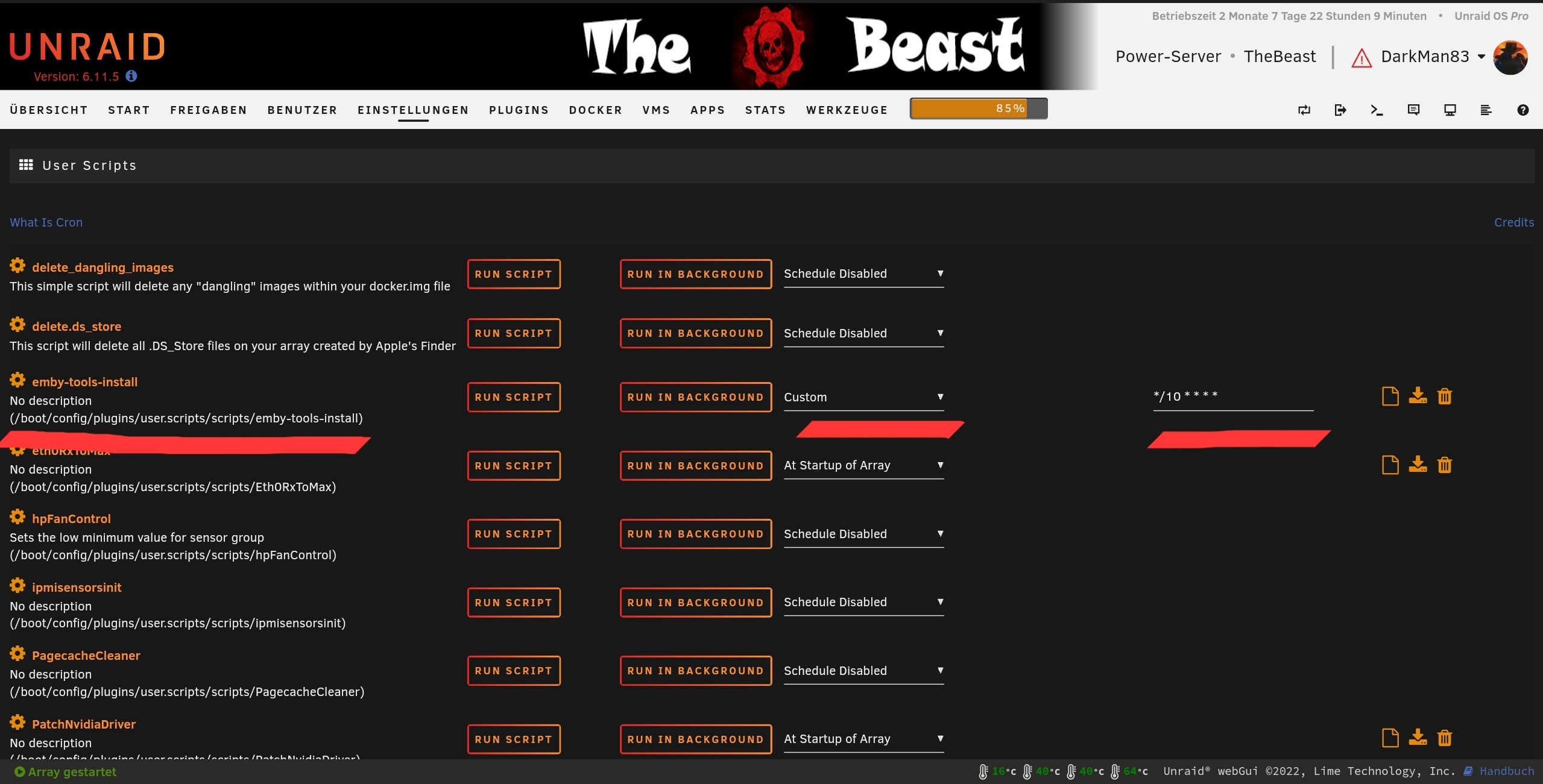

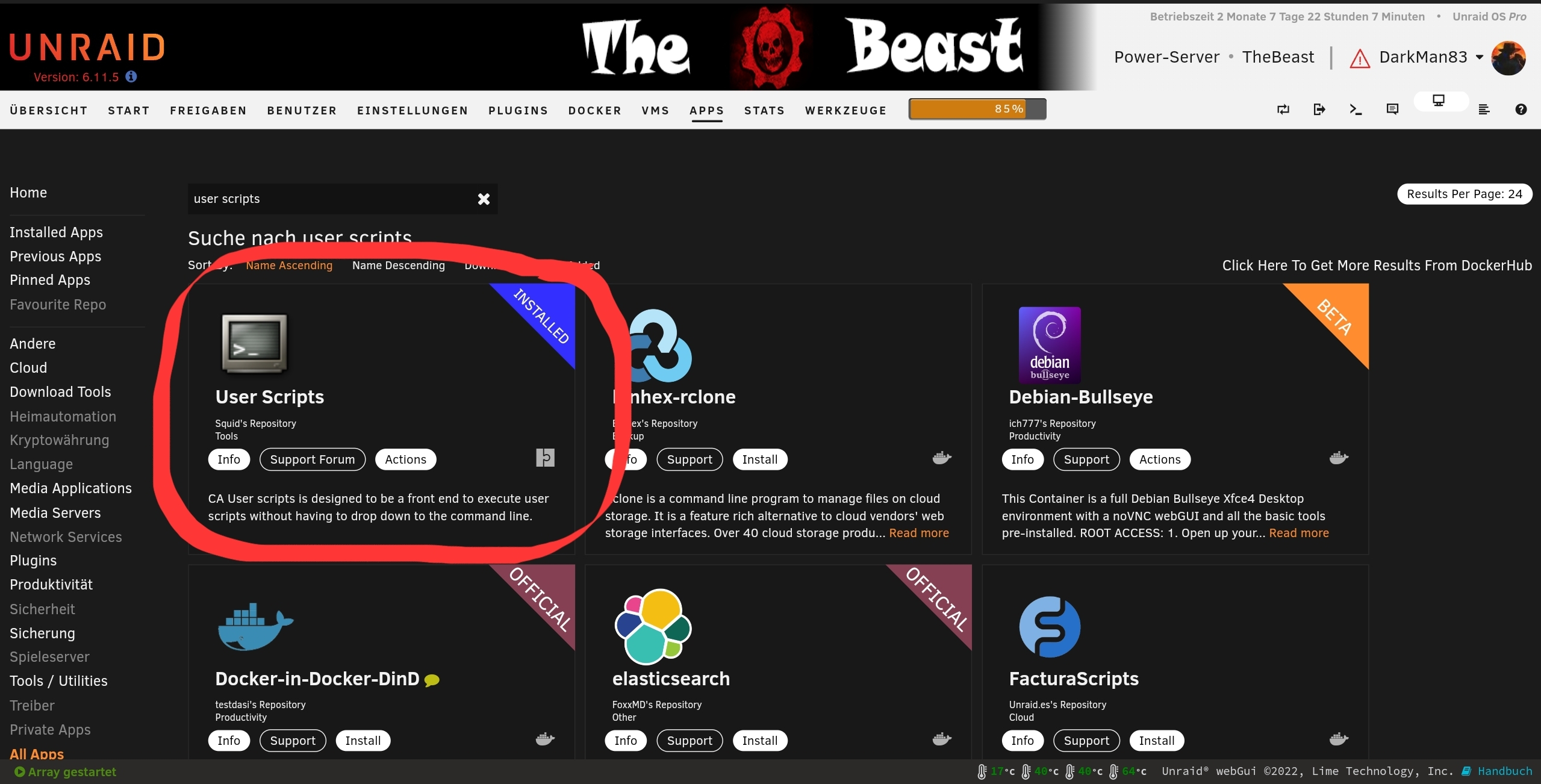

darkman1983TS 4 Posted April 14, 2023 Posted April 14, 2023 Yeah, for sure you can - that's the reason, I've added it here. If it's the Linuxserver.io docker, there should be no additional than these below. As i stated before, i recommend using the "User Scripts" plugin: 1. Install the plugin from the community appstore 2. Add a entry for the script to it (After creating a new entry, click the wheel icon and then "Edit Script", paste the script and save the changes) 3. Set your cronjob interval (the one in the screenshot is every 10 minutes) and click apply 4. Leave as is and wait or click the run button to test it now Greetings Dark 2

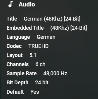

MagicDoubleM 121 Posted May 26, 2023 Posted May 26, 2023 (edited) Lately I stumbled across a few movies of whicht he audio-tracks don't get recognized correctly. Tried MediaInfo 23.04 instead of 22.12, but that didn't make a difference. An example: mediainfo.xml There should be a bit more info about the audio-track, since I have these options enabled: Edited May 26, 2023 by MagicDoubleM
rbjtech 5345 Posted May 27, 2023 Posted May 27, 2023 Can you provide the mediainfo output in JSON format. that attached XML doesn't look right - all the values are there multiple times ? I just checked the latest MediaInfo - and it's still all working perfectly for me (the Plugin uses JSON output as input for it's Title naming ...)
