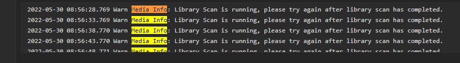

FrostByte 5456 Posted May 30, 2022 Posted May 30, 2022 1 hour ago, Cheesegeezer said: Ya, it stalled until the scan was done and then you can see it ran for 2 seconds 2022-05-30 08:57:54.625 Info LibraryMonitor: Watching directory /volume1/surveillance 2022-05-30 08:57:58.776 Info Media Info: Refresh Titles is ON - Resetting Lists 2022-05-30 08:57:58.852 Error Media Info: Object reference not set to an instance of an object. *** Error Report *** Version: 4.8.0.0 Command line: /volume1/@appstore/EmbyServer/system/EmbyServer.dll -programdata /var/packages/EmbyServer/var -ffdetect /var/packages/EmbyServer/target/bin/ffdetect -ffmpeg /var/packages/EmbyServer/target/bin/ffmpeg -ffprobe /var/packages/EmbyServer/target/bin/ffprobe -nolocalportconfig -ignore_vaapi_enabled_flag -pidfile /var/packages/EmbyServer/var/EmbyServer.pid -defaultdirectory /volume1/Public -updatepackage emby-server-synology7_{version}_x86_64.spk -noautorunwebapp Operating system: Linux version 4.4.180+ (root@build17) (gcc version 8.5.0 (GCC) ) #42661 SMP Fri Apr 1 15:31:10 CST 2022 Framework: .NET 6.0.2 OS/Process: x64/x64 Runtime: volume1/@appstore/EmbyServer/system/System.Private.CoreLib.dll Processor count: 8 Data path: /var/packages/EmbyServer/var Application path: /volume1/@appstore/EmbyServer/system System.NullReferenceException: System.NullReferenceException: Object reference not set to an instance of an object. at Emby.MediaInfo.ScheduledTasks.MediaInfoScheduledTask.Execute(CancellationToken cancellationToken, IProgress`1 progress) Source: Emby.MediaInfo TargetSite: Void MoveNext()
Cheesegeezer 3106 Posted May 30, 2022 Author Posted May 30, 2022 1 hour ago, FrostByte said: Ya, it stalled until the scan was done and then you can see it ran for 2 seconds 2022-05-30 08:57:54.625 Info LibraryMonitor: Watching directory /volume1/surveillance 2022-05-30 08:57:58.776 Info Media Info: Refresh Titles is ON - Resetting Lists 2022-05-30 08:57:58.852 Error Media Info: Object reference not set to an instance of an object. *** Error Report *** Version: 4.8.0.0 Command line: /volume1/@appstore/EmbyServer/system/EmbyServer.dll -programdata /var/packages/EmbyServer/var -ffdetect /var/packages/EmbyServer/target/bin/ffdetect -ffmpeg /var/packages/EmbyServer/target/bin/ffmpeg -ffprobe /var/packages/EmbyServer/target/bin/ffprobe -nolocalportconfig -ignore_vaapi_enabled_flag -pidfile /var/packages/EmbyServer/var/EmbyServer.pid -defaultdirectory /volume1/Public -updatepackage emby-server-synology7_{version}_x86_64.spk -noautorunwebapp Operating system: Linux version 4.4.180+ (root@build17) (gcc version 8.5.0 (GCC) ) #42661 SMP Fri Apr 1 15:31:10 CST 2022 Framework: .NET 6.0.2 OS/Process: x64/x64 Runtime: volume1/@appstore/EmbyServer/system/System.Private.CoreLib.dll Processor count: 8 Data path: /var/packages/EmbyServer/var Application path: /volume1/@appstore/EmbyServer/system System.NullReferenceException: System.NullReferenceException: Object reference not set to an instance of an object. at Emby.MediaInfo.ScheduledTasks.MediaInfoScheduledTask.Execute(CancellationToken cancellationToken, IProgress`1 progress) Source: Emby.MediaInfo TargetSite: Void MoveNext() you got debug logging on? These darn lists again. have you uploaded an old one by accident.

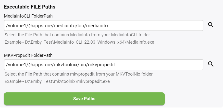

Cheesegeezer 3106 Posted May 30, 2022 Author Posted May 30, 2022 2 minutes ago, FrostByte said: It's the link in my post a little way up right before arrbee99's post Got it lol, sorry chief. Just looking thru it looks like there isn’t a path set for something. Just double check everything again. Does it run on just movies? thanks for your help!
FrostByte 5456 Posted May 30, 2022 Posted May 30, 2022 It runs fine for just Movies, but not just TV shows. 1
