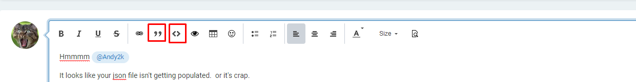

Cheesegeezer 3106 Posted November 1, 2022 Author Posted November 1, 2022 Hmmmm @Andy2k It looks like your json file isn't getting populated. or it's crap. open one of those items in MediaInfo. and then click on View and JSON then click anywhere in the json output --> Ctrl A (select all) and then ctrl C (copy) then paste in a code block or quote here on the forum 1
