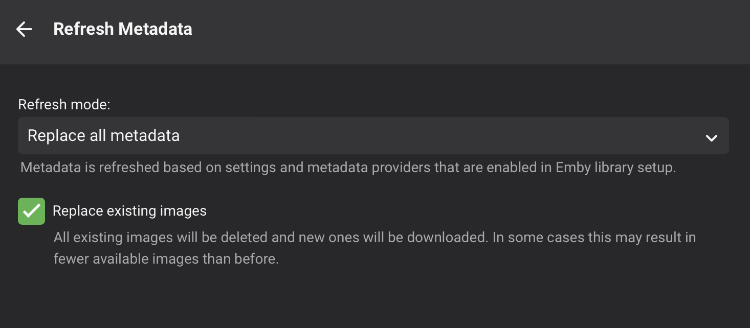

I went through and corrected all the filenames assuming Emby would pick up the changes but it hasn't. (I ran the scheduled scan, library scan, etc.)

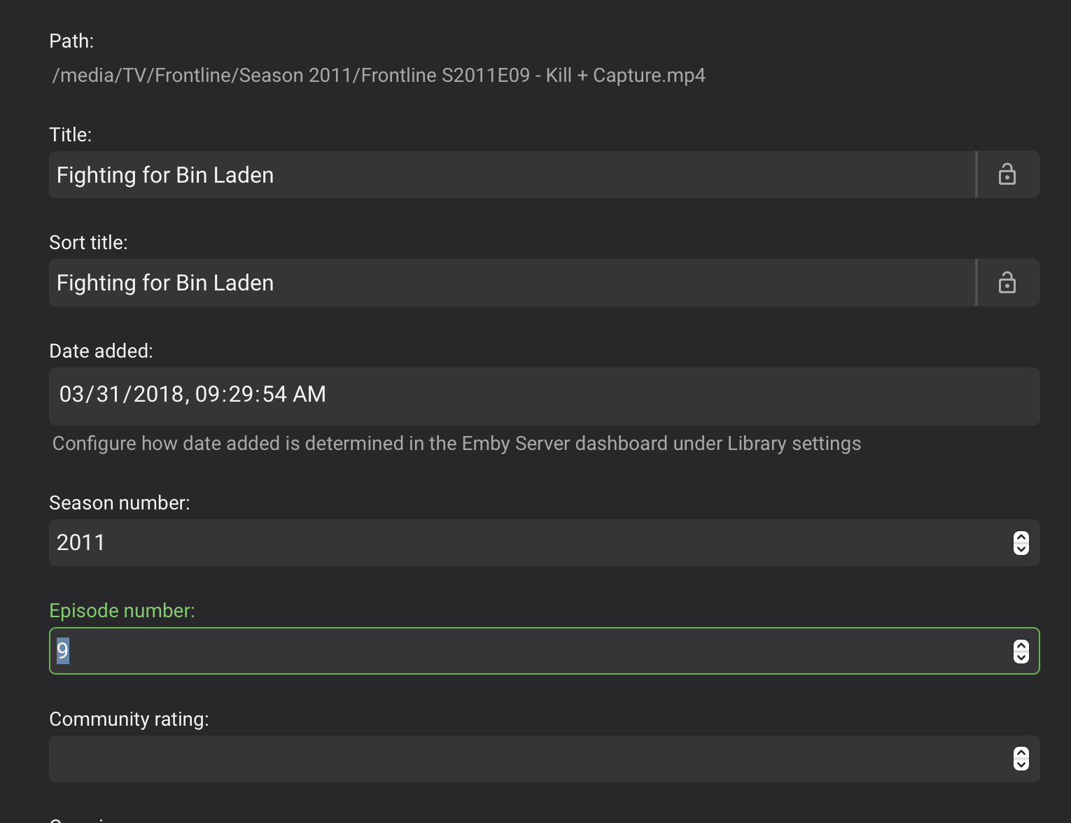

Even now when I correct the season/ep explicitly in the metadata then refresh to populate the rest of the fields it reverts season/ep to their previous values:
Am I doing something wrong?

It's not a permission issue because I tried again after deleting the NFO file which emby re-created with the old information.
Is "provider id" TVDB id? If so it's 7147875.
Here's the re-created NFO and logfile excerpt for NFO delete (not logged) metadata edit and refresh:

Yep that id is for ep8 not 9
Frontline - Fighting for Bin Laden - TheTVDB.com
Did Emby make this nfo?  As it name is correct but everything in if is for ep8.
Assume internal cached metadata is being used as the server log only shows TMDB queries and they will not work as they do not have this Series in this season order.
