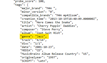

softworkz 5127 Posted May 30, 2022 Posted May 30, 2022 I've looked at your file and now I'm confused, because it doesn't show multiple genres in the ffprobe output, like you posted above. Your posted output: Output from the (completely different) file which you PM'ed:
Vicpa 612 Posted May 30, 2022 Author Posted May 30, 2022 (edited) Hi @softworkz Sorry my bad.. I screwed up the attachments in the OP. . 10 hours ago, softworkz said: because it doesn't show multiple genres in the ffprobe output, l Above is the issue I am reporting. The probe.txt file I attached (Incorrectly) is a .FLAC file working as expected. ffprobe version 5.0.0-emby_2022_05_07-g463c71b3b3+1847 Copyright (c) 2007-2022 the FFmpeg developers and softworkz for Emby LLC built with gcc 10.3.0 (Rev5, Built by MSYS2 project) { Input #0, flac, from 'file:D:\Public\Win 10\01 Algonquin.flac': Metadata: MUSICBRAINZ_RELEASEGROUPID: 438b9826-8ad8-3c8a-be1a-b7d132f6f057 ORIGINALDATE : 1957 ORIGINALYEAR : 1957 RELEASETYPE : album MUSICBRAINZ_ALBUMID: 748a6bdb-51a8-4dd3-92db-16ef19a71a54 The file I pm'd is an .M4A which is where the problem is. Your ffprobe output. Display and Tags as displayed in "MediaInfo" Example.txt Below is how it appears in Picard. In an .m4a (for some reason?) only the first tag is displayed. Picard and MediaInfo display the multiple values. Sorry for the confusion. Just limit your investigation to the m4a container. mp3's and flac seem fine. Thanks -vicpa Edited May 30, 2022 by Vicpa

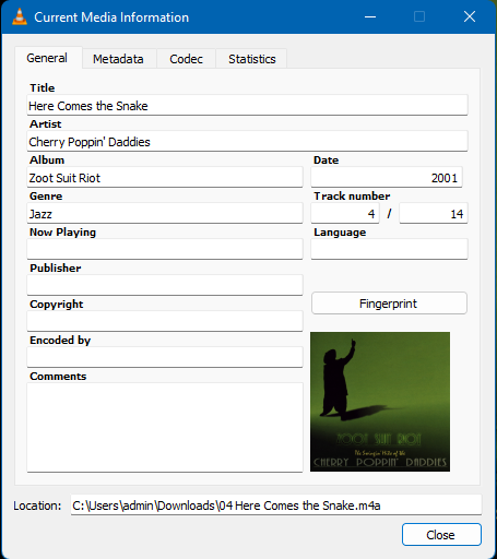

softworkz 5127 Posted May 30, 2022 Posted May 30, 2022 VLC shows this: Windows New Windows Media Player 1
softworkz 5127 Posted May 30, 2022 Posted May 30, 2022 (edited) I thought the issue would be that ffprobe shows multiple entries and Emby is not taking them. But when ffprobe doesn't show multiple and neither VLC nor Windows, then it's a different story. On 5/29/2022 at 2:55 PM, Vicpa said: Does the m4a spec not support ";" or multiple tags, maybe Picard should not write them ???? I don't really know. Would need to study the file format specs. Multi-Value support could have been added in a later version of the spec. Or it's just some kind of extension something in the range between official and unofficial Edited May 30, 2022 by softworkz 1
