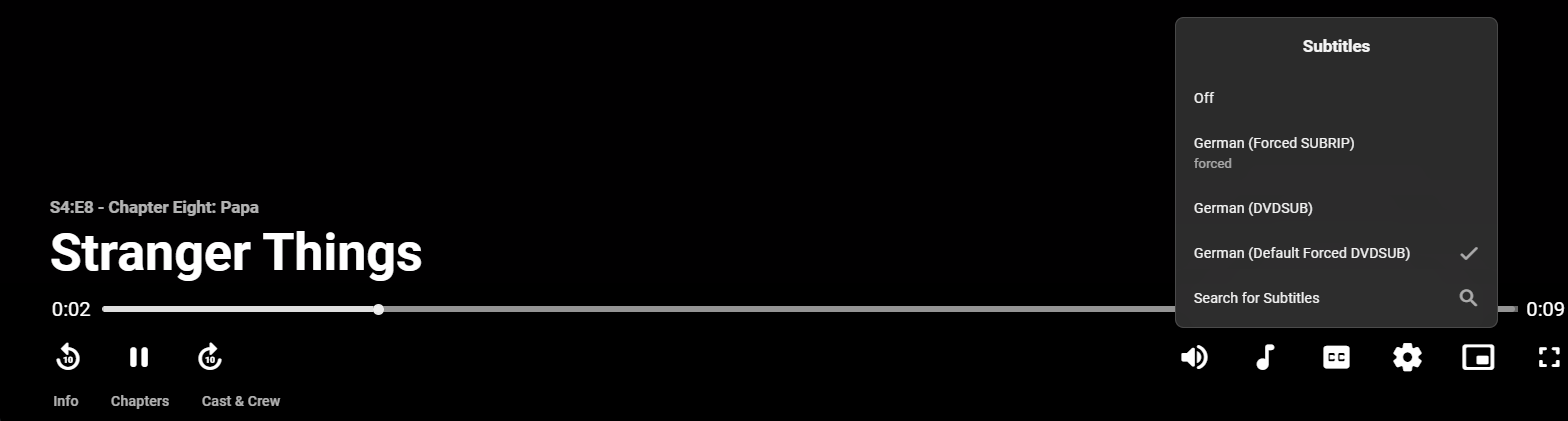

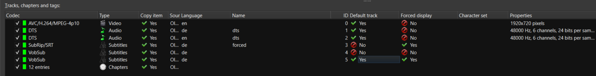

horstepipe 423 Posted May 24, 2022 Posted May 24, 2022 (edited) Hello I mux external VobSubs subs or srt subs inside my mkv and mark them as default and forced if necessary, see screenshot. I set the subtitle settings to only show forced subtitles. But they are not enabled if I start playback. Best regards sample.mkv Edited May 24, 2022 by horstepipe added file sample

Happy2Play 9812 Posted May 25, 2022 Posted May 25, 2022 6 hours ago, horstepipe said: 8 hours ago, horstepipe said: @Happy2Play did you try out my example file and got that result? If yes, could you please show your exact language and subtitle settings and the platform you tested it? Only tested the web client, iOS app and ET (store and desktop). Don't own any Android devices. The all show the same as above. Since no langues is set "Default" will take priority. 1

Happy2Play 9812 Posted June 21, 2022 Posted June 21, 2022 5 hours ago, horstepipe said: here is my sample file from first post uploaded to github as strm file, so you should easily see the problem Stranger Things - S04E08.strm 69 B · 1 download Playing that for the first time they were selected. Preferred subtitle language: German subtitel mode: only forced subtitles 1
Happy2Play 9812 Posted June 21, 2022 Posted June 21, 2022 So here it a mixed issue as you have two subtitle tracks that are Forced but Default/Forced is more important then just Forced is my takeaway.
