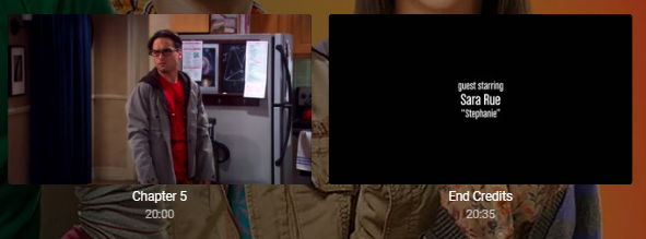

Amanade3 32 Posted April 28, 2023 Posted April 28, 2023 On 26/04/2023 at 20:20, rbjtech said: Ensure the top option is set. Please be aware that the Introskip Plugin is NOT compatible with the Core Introskip. Run one or the other. If you are running the Core Introskip, it's possible that it is wiping the Credit data. Post running it (and after a Library Scan) you should see the hidden markers appear as real chapters (as the Introskip Plugin nicely Inserts them (as well as the Intro..) (note the recalibrated chapter points, going back to every 5 minutes post the Intro.. ) .. and you should also see in the ChapterAPI Plugin as a hidden CreditStartMarker Yeah I think i am missing to activate the setting but wouldn't it mess up the core's intro skip database?? if not i will use it. tnx
rbjtech 5344 Posted April 28, 2023 Posted April 28, 2023 1 hour ago, crusher11 said: The only MKV files that are missing chapters are the only ones with intact intro data. So something is going on. As for adding chapters, that's the only way to generate the markers, right? And doing so changes the first chapter after the intro. If there are 'chapters' in the MKV - then they are imported into Emby as per a normal import process. If there are no chapters, then emby will create them every 5 minutes - in it's database only. Neither emby nor the plugins touch the original source files. The only Plugin that does (that we/cheese/chef produced) is the MediaInfo plugin - as that modifies the MKV track titles - but that has nothing to do with chapters. So your missing chapters in the MKV have nothing to do with us ..
rbjtech 5344 Posted April 28, 2023 Posted April 28, 2023 3 minutes ago, Amanade3 said: Yeah I think i am missing to activate the setting but wouldn't it mess up the core's intro skip database?? if not i will use it. tnx If you are using the Core Introskip detection, then you should not be using the Introskip Plugin. It's one or the other, not both.
