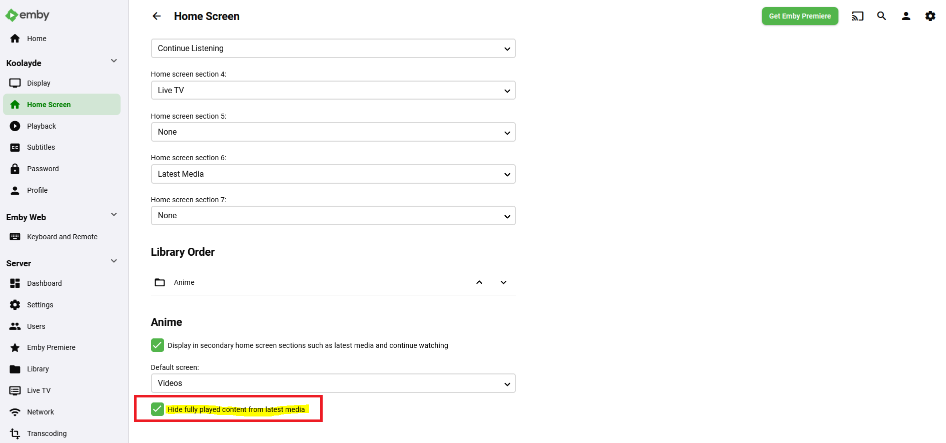

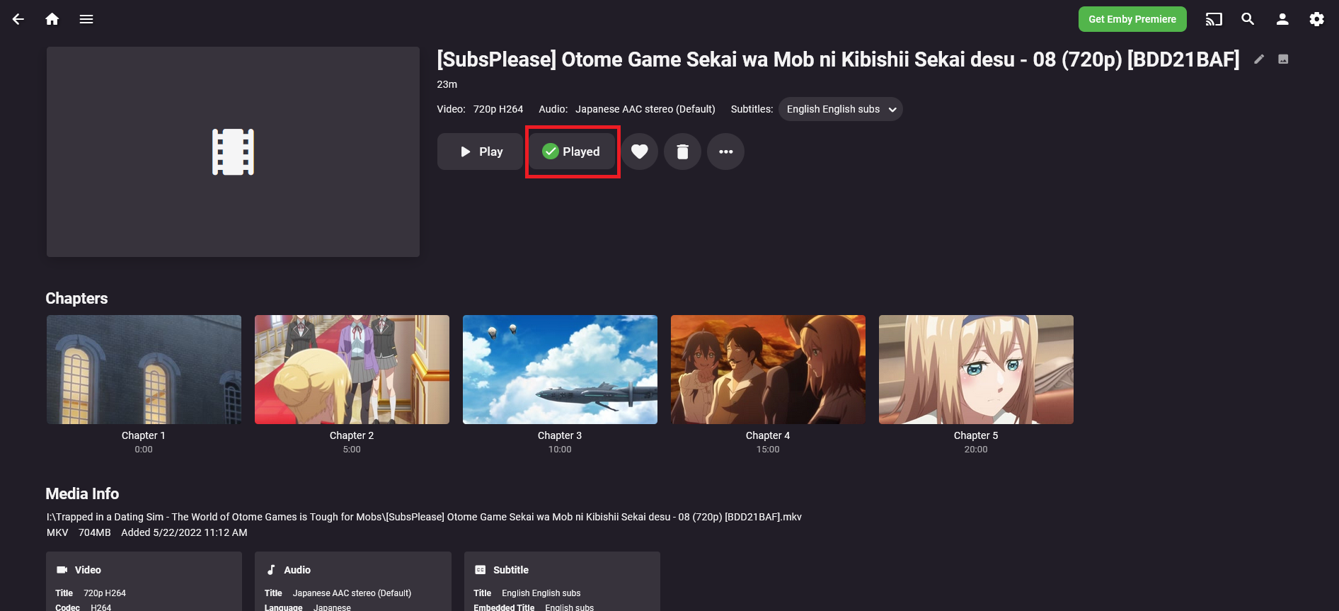

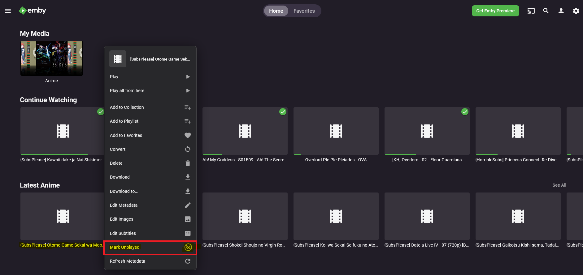

Koolayde 0 Posted May 23, 2022 Posted May 23, 2022 Hello, I'm experiencing a new issue since my Emby server installation upgraded to version 4.7. When accessing the Emby server via a web browser, the latest media section within the Home Screen now displays media that has already fully played. The setting "Hide fully played content from latest media" for the library IS turned on within the Home Screen setting menu. * - The issue persists regardless of browser used to access the Emby server installation. Specifically, I have tried Chrome, Firefox and Brave. I have also tried clearing browser cache and accessing again with no change in symptoms. * I have toggled the setting off and then back on again within the setting menu, but the problem persists. *- I have restarted the computer that is hosting the Emby server, but the problem persists. *- Clicking the 3 dot menu for a fully played media file on the home screen, shows the correct menu options consistent with a file that has been marked as played. No checkmark is being displayed for any file within the latest media section that has been marked as played. *- Navigating to the previously played video file details screen correctly shows the file as played. Attaching screen captures with yellow highlighting and a red box on the relevant parts showing Home Screen settings, the Home Screen itself, 3 dot menu for a fully played back video file, and an image showing the video file with full details itself and the Emby server log file. Any assistance on how to fix would be greatly appreciated. embyserver.txt

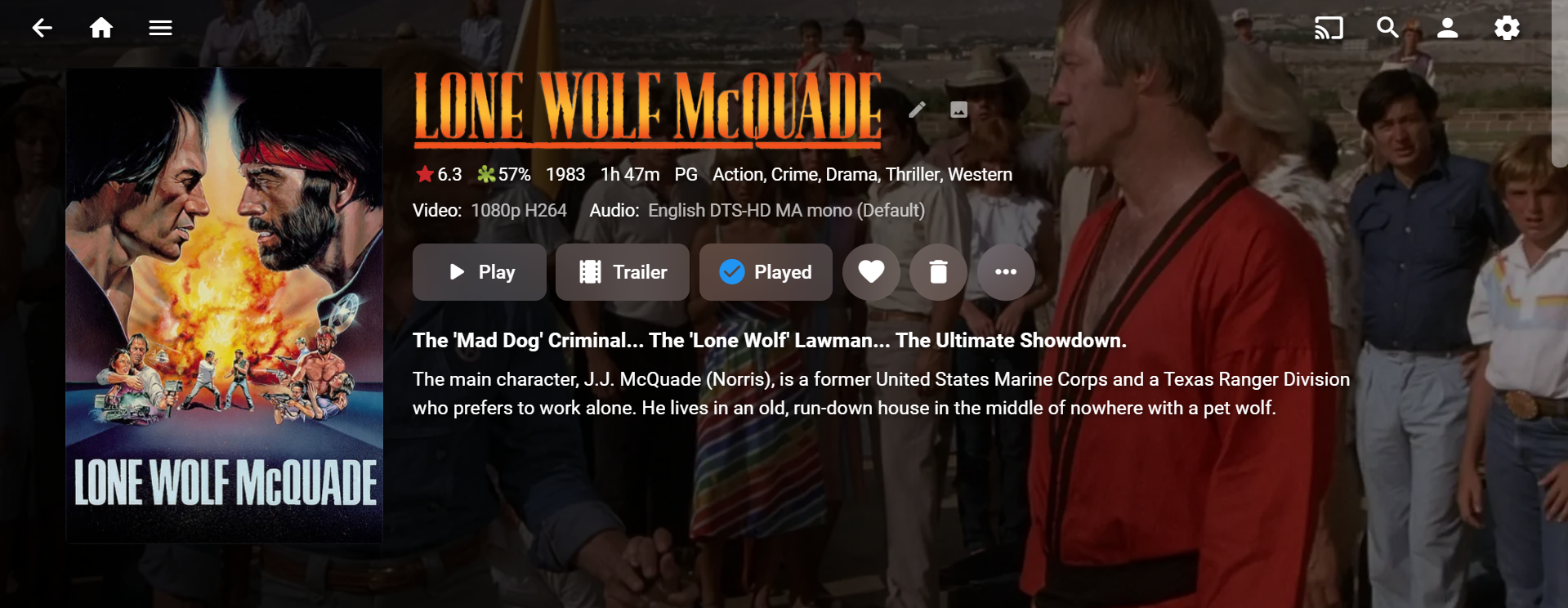

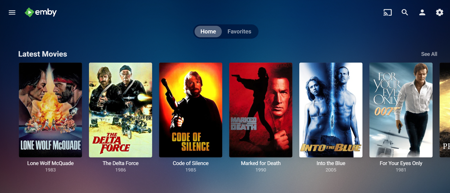

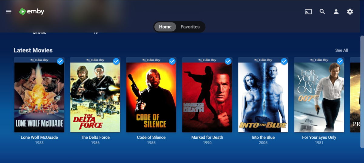

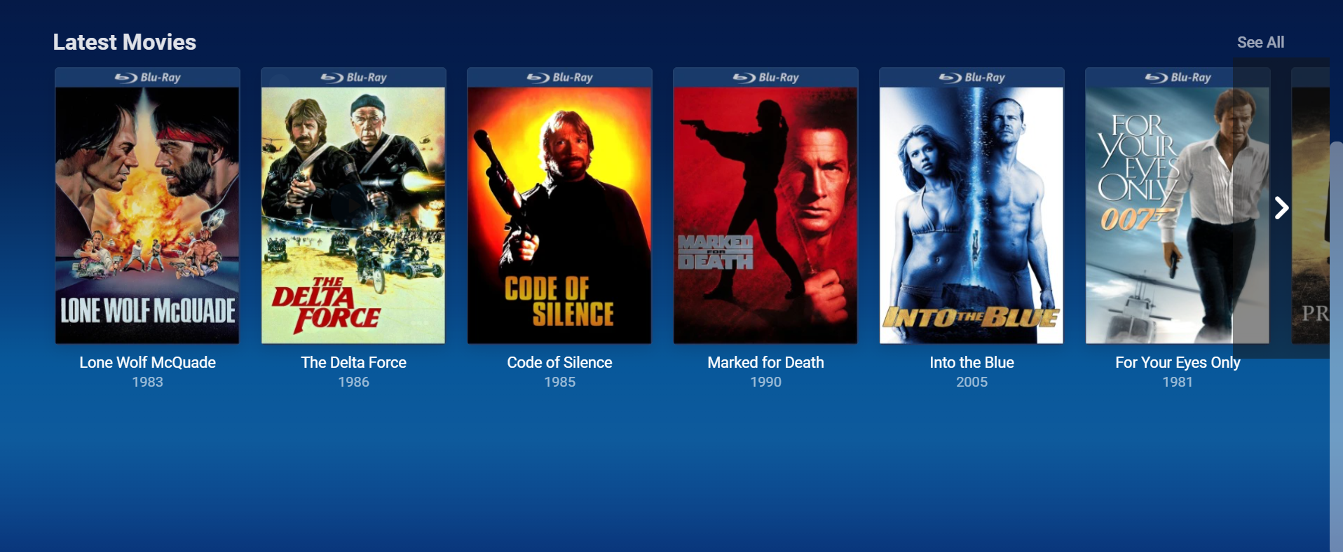

rax_y 1 Posted July 14, 2022 Posted July 14, 2022 It's the exact same scenario as Koolayde. In example 1. The Home screen is set to not to Hide fully played content from latest media. As u can see the the circle with a checkmark is showing indicating it has been played as per usual. In example 2. I enabled the Hide fully played content from latest media option. As you can see the played movies are still showing and the circle with a check mark is not showing. And assistance you can provide would be greatly appreciated.

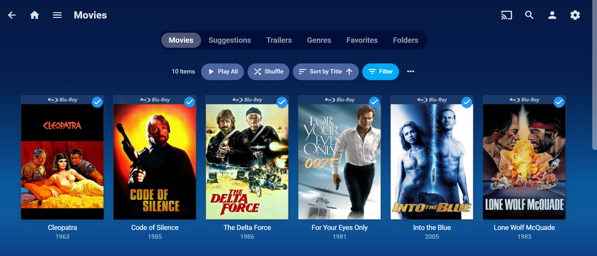

rax_y 1 Posted July 14, 2022 Posted July 14, 2022 Yes. I filtered played movies to Playstate: Played. This is the result.

rax_y 1 Posted July 14, 2022 Posted July 14, 2022 Yes the un played filter is working as expected. Just to clarify here. The played movies showing in my latest movies section is the only current issue(and played TV episodes in the latest TV section) The exact issue is, in Home screen settings the Hide fully played content from latest media option is not working.

Luke 42289 Posted July 15, 2022 Posted July 15, 2022 21 hours ago, rax_y said: It's the exact same scenario as Koolayde. In example 1. The Home screen is set to not to Hide fully played content from latest media. As u can see the the circle with a checkmark is showing indicating it has been played as per usual. In example 2. I enabled the Hide fully played content from latest media option. As you can see the played movies are still showing and the circle with a check mark is not showing. And assistance you can provide would be greatly appreciated. Can you send me a copy of your iibrary.db file? Thanks.

Luke 42289 Posted July 17, 2022 Posted July 17, 2022 6 hours ago, rax_y said: Sorry for the late reply. Assuming you meant library.db file. Thanks library.db 48.32 MB · 0 downloads If you click on marked for death, does it indicate a played status on the detail screen?
Luke 42289 Posted July 17, 2022 Posted July 17, 2022 36 minutes ago, Luke said: If you click on marked for death, does it indicate a played status on the detail screen? I think actually you might need to make new screenshots because the data in your library.db doesn't appear to match the screens. I think some played states have changed.
rax_y 1 Posted July 17, 2022 Posted July 17, 2022 Attached are current screenshots and the current library. db file. All the movies showing are marked as played. library.db
Luke 42289 Posted July 17, 2022 Posted July 17, 2022 Strange. When I run queries against this database the results look OK to me. So now what I'll need from you is a server log that can show me the exact database query being run. So here's what you'll need to do. Shutdown the server. Locate the server's config/system.xml file and set the LogAllQueryTimes value to true. Then start the server, go into the Logs section, and temporarily enable debug server logging. Then go to the home page, reproduce the issue, and immediately shutdown the server without doing anything else (to make the activity easier to find in the log), then provide me with the server log. Very important though: Make sure to undo these two things because they will cause huge log files. In particular LogAllQueryTimes will flood the log heavily. That's also why I need you to start and stop the server immediately. Thanks.
