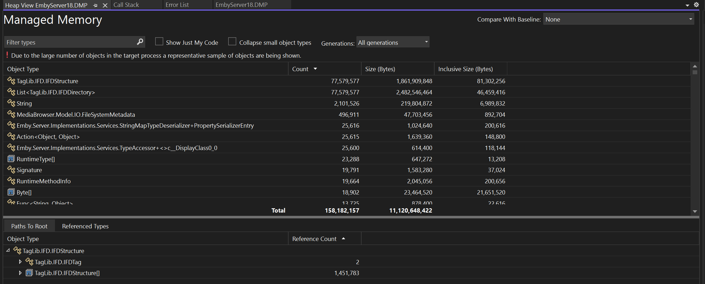

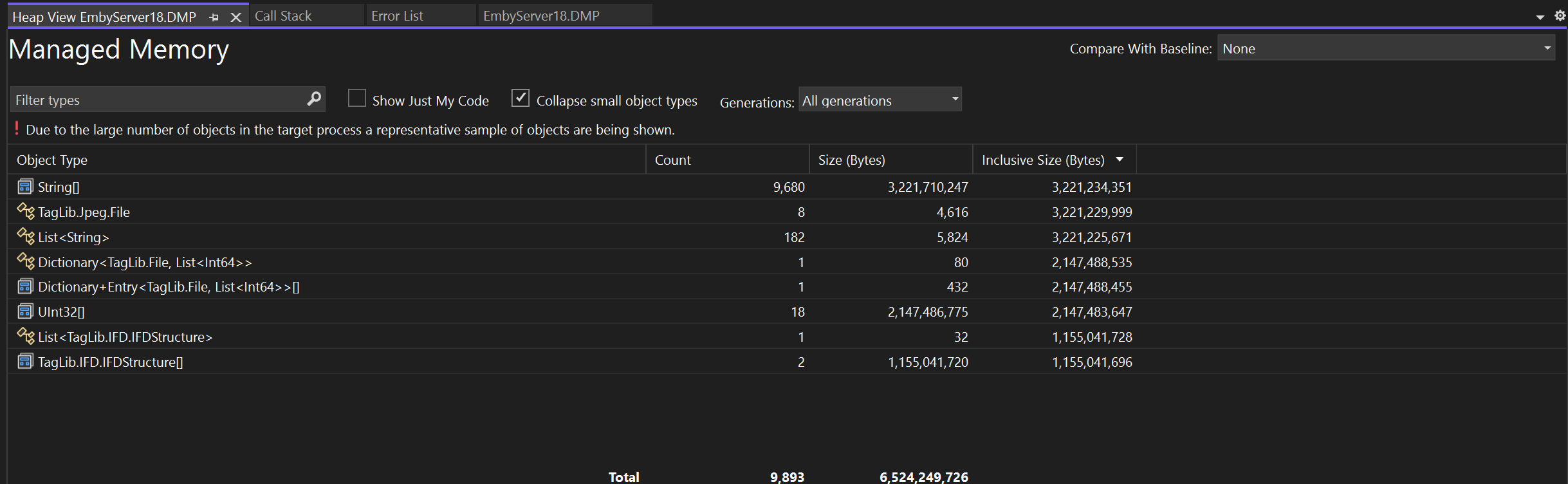

OscarCalvo 0 Posted May 23, 2022 Author Posted May 23, 2022 (edited) Here is the Heap View from the massive 10Gb dump. Most allocated type is TagLib.IFD.IFDStructure There are so many that VS can only display a "representative sample" Edited May 23, 2022 by OscarCalvo
OscarCalvo 0 Posted May 23, 2022 Author Posted May 23, 2022 It seems I can trigger the problem by manually Scanning the library. The process will start taking a lot of memory while scanning pictures: 2022-05-22 19:24:36.040 Debug App: FolderImageProvider reports change to 631183 - S:\ServerFolders\Pictures\Familia Calvo\2016\05\2016.05.14 2022-05-22 19:24:36.041 Debug App: Running FolderImageProvider for S:\ServerFolders\Pictures\Familia Calvo\2016\05\2016.05.14 2022-05-22 19:24:48.368 Debug App: Running PhotoProvider for S:\ServerFolders\Pictures\Familia Calvo\2016\Hazel OneDrive-S2016-E0217.17.07.52.jpg This explains why I can only see this after doing lots of pictures file renames. Also, the Tag.IFD.IFDStruture seems to be uses for getting picture metadata.
Luke 42185 Posted May 23, 2022 Posted May 23, 2022 OK yes that is a third party library that we're using for photo scanning. We'll take a look at it. Thanks.
