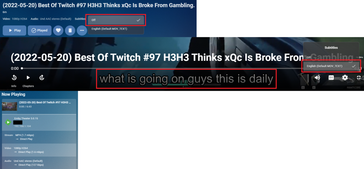

MOV_TEXT subtitle support seems to have been partially broken in the latest version. This is the subtitle format used in YouTube videos, and probably other streaming platforms.
1. MOV_TEXT subtitles can no longer be directly played. Playing a video file with subtitles will force video transcoding, citing that the subtitles are not supported for direct play. This applies to both Emby Theater and the iOS app.
2. If video transcoding is disabled, the video will never start but try to load forever until you forcibly quit the application (eg Alt+F4). This applies to Emby Theater, the iOS app will stop trying after a few seconds, but does not show any error message.
3. If video transcoding is enabled, the correct subtitle formatting will not be used, and instead the subtitles seem to be displayed in Times New Roman. However, if you disable and re-enable the subtitles while playing the video (ie CC-button -> Off, CC-button -> MOV_TEXT subtitles), the subtitles will now be displayed with the correct formatting.
4. Also, if you start the video without subtitles enabled, the video will start direct playing, and if you then enable subtitles while still playing the video, Emby is able to display the MOV_TEXT subtitles while still direct playing, and shows them with the correct formatting straight away.
541364092_turnonsubtitlesafterstarting.thumb.png.78425f515edb273d6c856a236eebb7e7.png

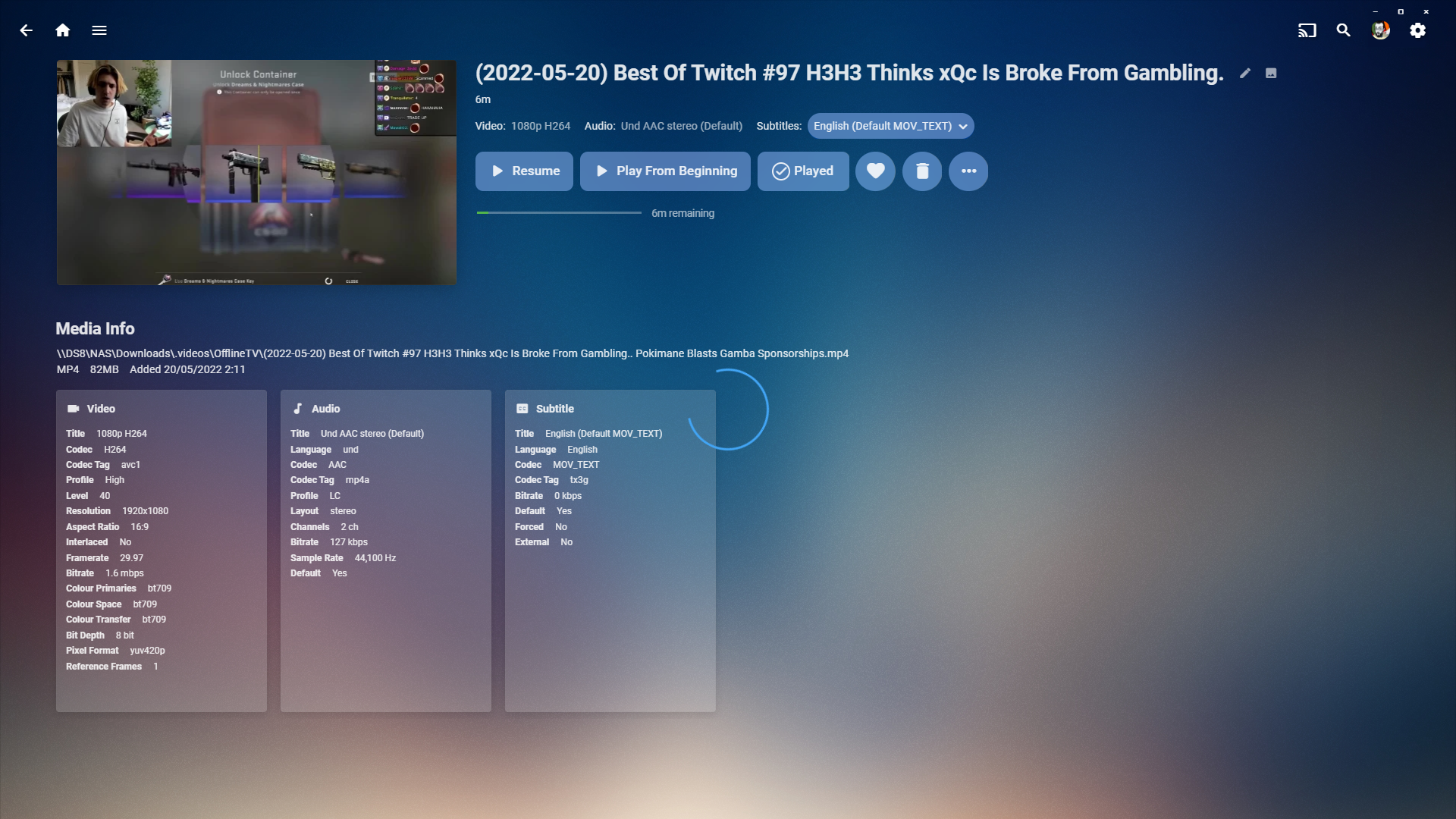

I have uploaded the video I used as an example, so you can try to recreate the same issue on your end. The issue applies to all my videos with MOV_TEXT subtitles, and started happening after the latest update. It has been working flawlessly before that, and since there has been several other subtitle-related topics after the update, maybe something has been changed in how Emby initially loads internal subtitles..?
Or is this problem just totally unrelated to any update..? Maybe some setting got reset in the update that changed how Emby handles these files? I've not changed any settings recently, nor installed any new plug-ins, nor changed any hardware or software, except for regular Windows Updates and updated NVIDIA drivers.
Emby Server: Windows v4.7.0.60. No custom CSS.
Emby Theatre: Windows Desktop v3.0.15
Emby for iOS: v2.1.6
Server and ffmpeg logs attached. These logs are from when the server forcibly transcodes the video, and when Emby Theatre displays the subtitles with the wrong formatting, ie scenario 1 above.

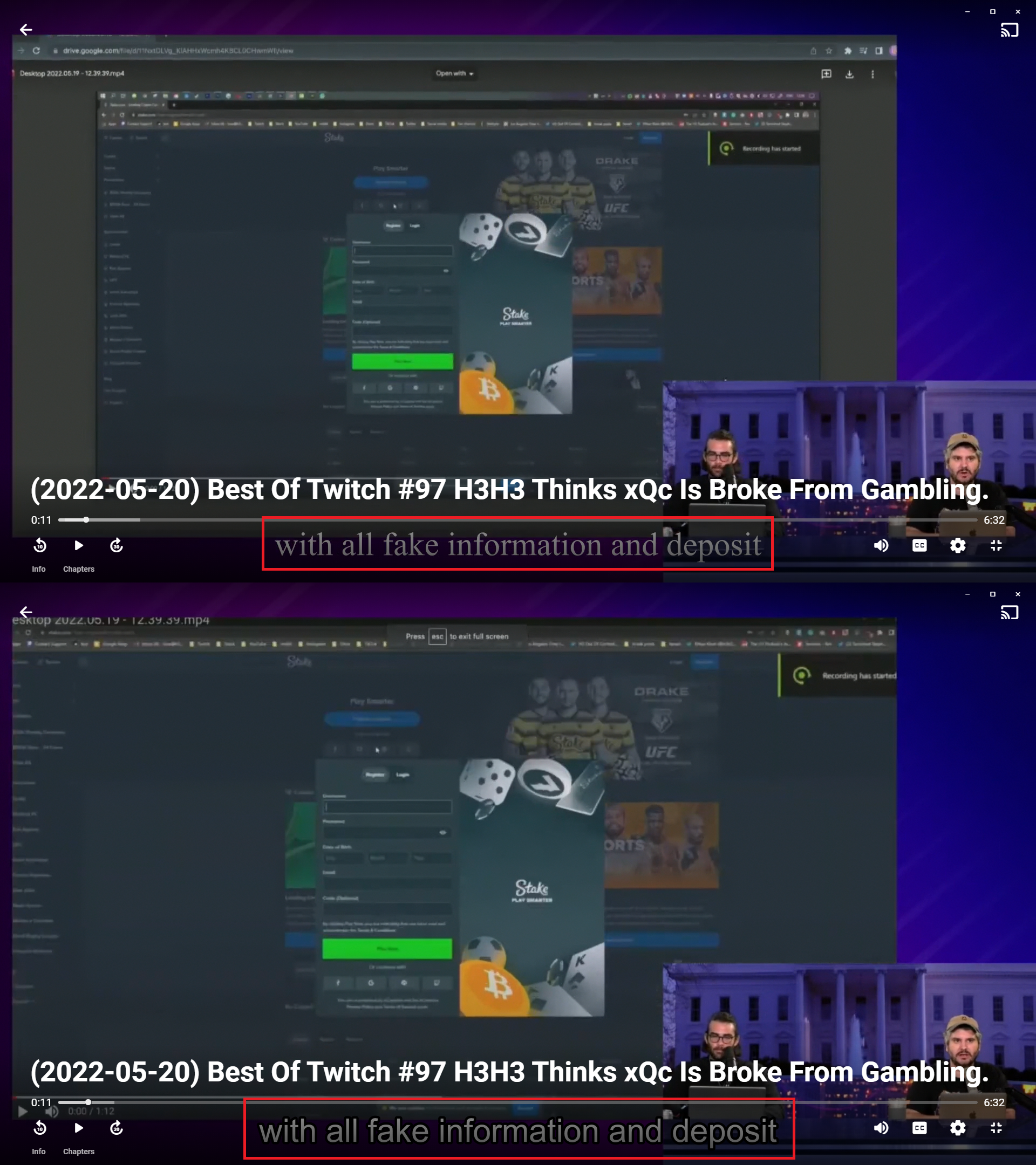

However, now that it is extracting the subtitles, Theater is now using a font face that the MOV_TEXT has specified, which seems to be "Serif".
321255840_wrongformatwithextractedsubtitles.thumb.png.49ed0e329dda67403153e934e0428e26.png
Disabling and re-enabling the subtitles while the video is playing does not help, like it did with scenario 3 in my original post.
In the iOS app the subtitles are now displayed with the correct formatting (and the normal Emby subtitle font), and it works with direct play without any issues.
Is there a way to get Theater to work like it did before, or get it to handle these subtitles just like when you enable subtitles after stating to play the video (scenario 3 above)..?
I want it to display the subtitles without the custom font setting from the subtitle, and without transcoding the video, just like it has done before. (And just like the iOS app does right now with subtitle extraction enabled.)
