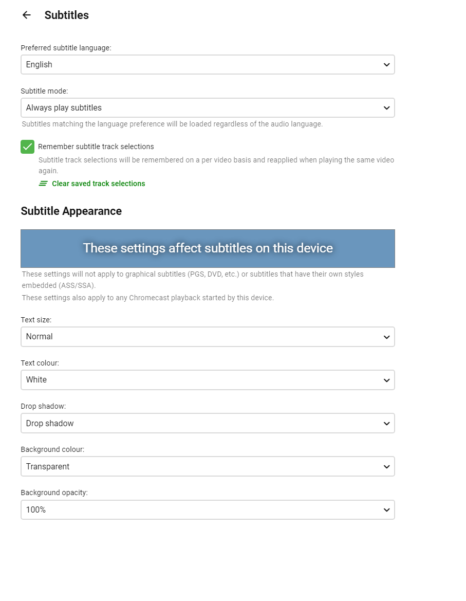

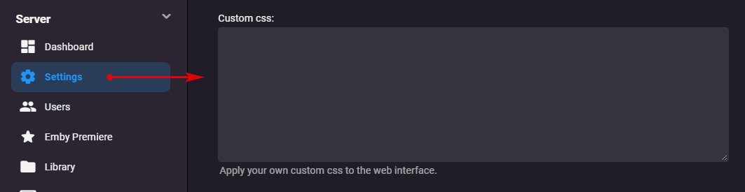

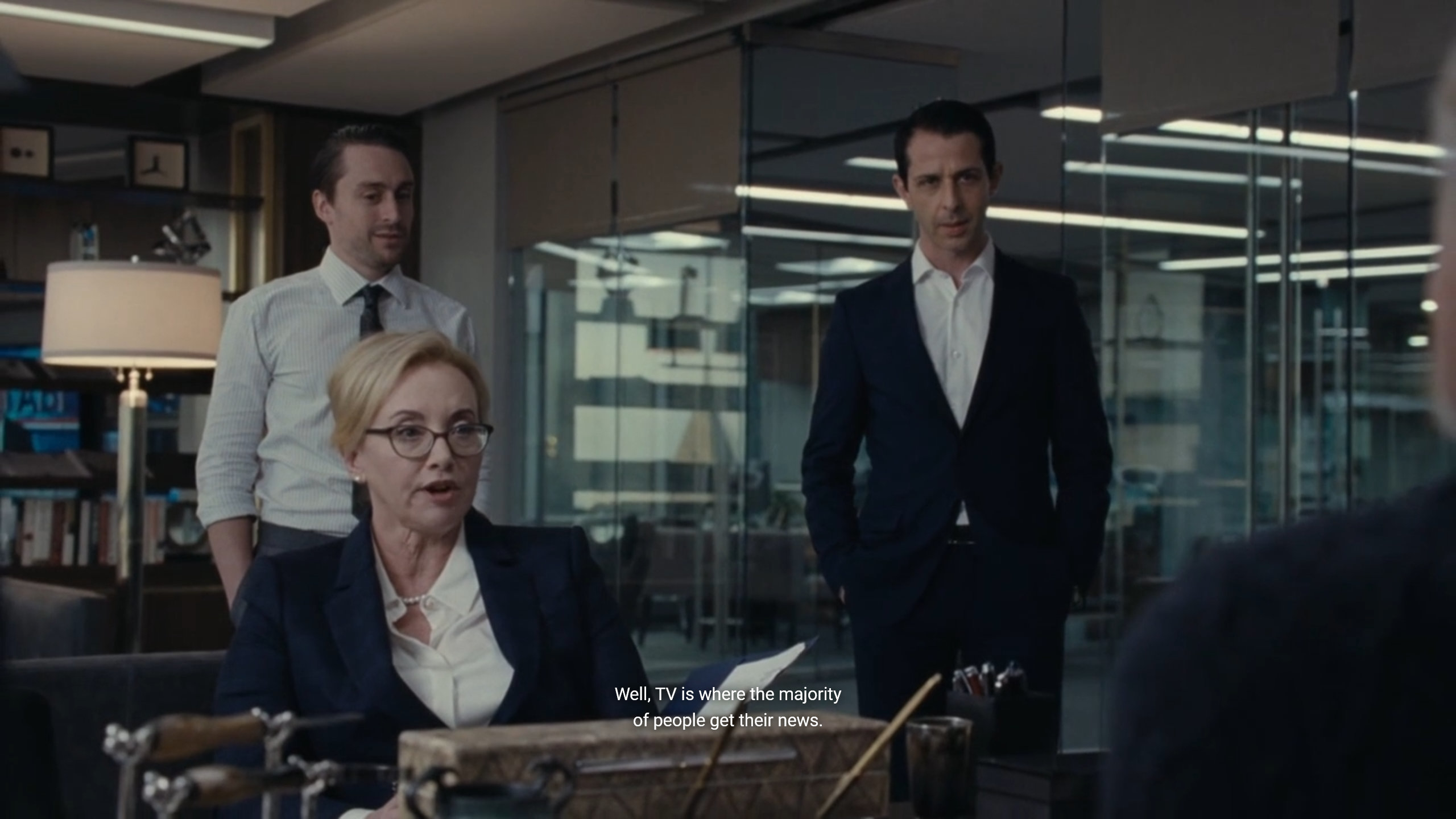

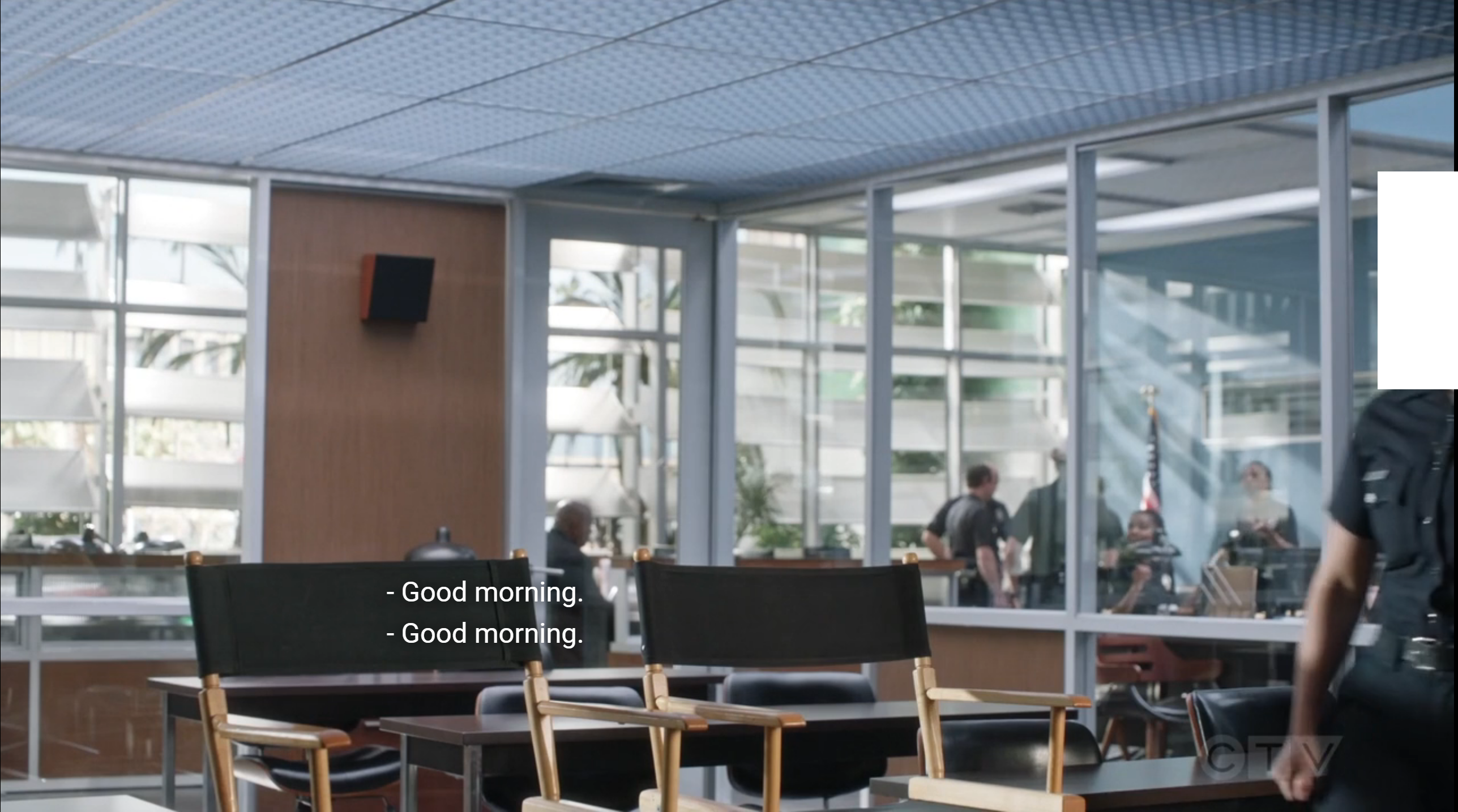

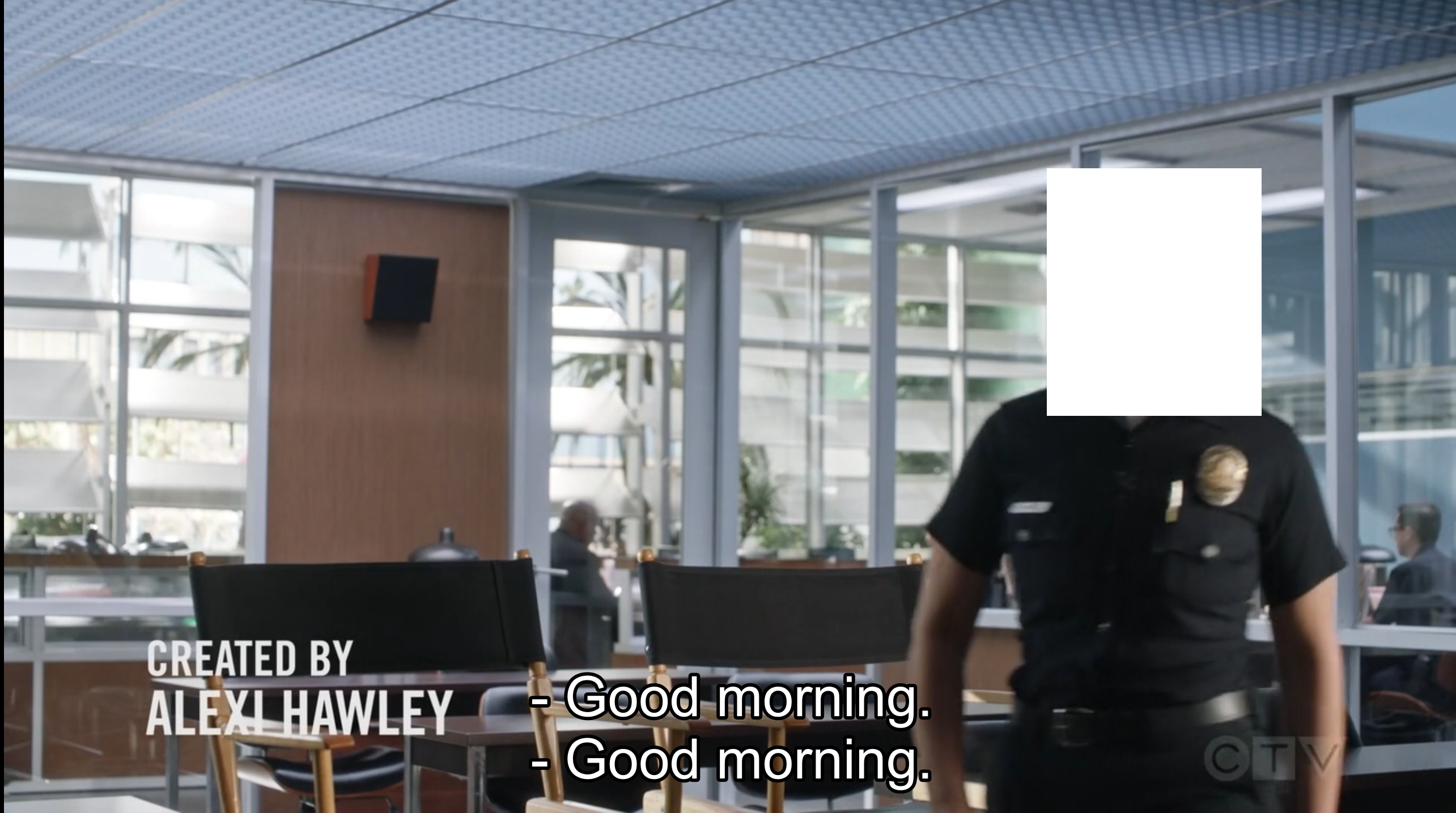

Royalnaga 1 Posted May 20, 2022 Posted May 20, 2022 (edited) All my existing subtitles have suddenly changed to being extreeeeeemly tiny and im trying to figure out a way to solve it without success (its only on the browser version) Picture (1) Normal settings / Picture (2) Extra large settings The placement of the subtitles is just that scene its not a issue as it reverts back to being middle bottom afterwards but still incredibly small The 1 min trial Theatre shows the subtitle normally (picture 3) Removed the face just to avoid any unintentional spoilers as its not revelant anyways, Any tips / help would be appreciated Version 4.7.0.60 Edited May 20, 2022 by Royalnaga

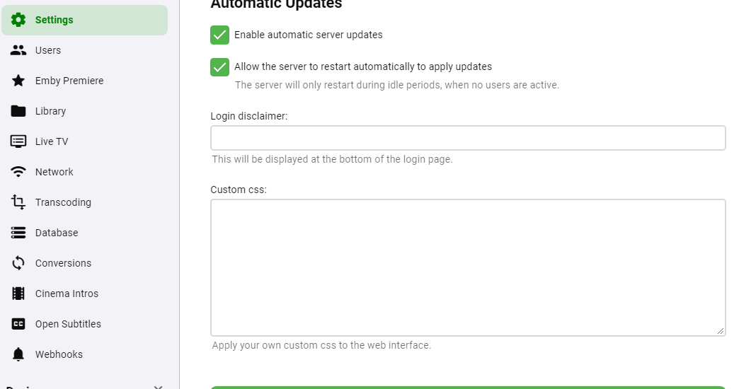

Luke 43420 Posted May 20, 2022 Posted May 20, 2022 Hi, do you have any custom css? If so then try removing that.
Royalnaga 1 Posted May 20, 2022 Author Posted May 20, 2022 14 minutes ago, Luke said: Hi, do you have any custom css? If so then try removing that. Not that i know of honestly i dont even know what that is? Can you tell me how to check?
seanbuff 1441 Posted May 20, 2022 Posted May 20, 2022 31 minutes ago, Royalnaga said: Not that i know of honestly i dont even know what that is? Can you tell me how to check? If you don't know, then it's unlikely you have added any, but worth checking anyway.
Royalnaga 1 Posted May 20, 2022 Author Posted May 20, 2022 Sadly empty going to bed now so my response is going to be delayed for 8 hours
rbjtech 5401 Posted May 20, 2022 Posted May 20, 2022 (edited) I'm using external .SRT files. I wound concur with the OP - 'Normal' is now very small in a browser. Setting to 'Large' is the equivalent to how 'Normal' used to look. Not a huge issue in the great scheme of things as you can set to Large easily enough - but maybe worth recalibrating back to match the other Apps ? Edited May 20, 2022 by rbjtech
