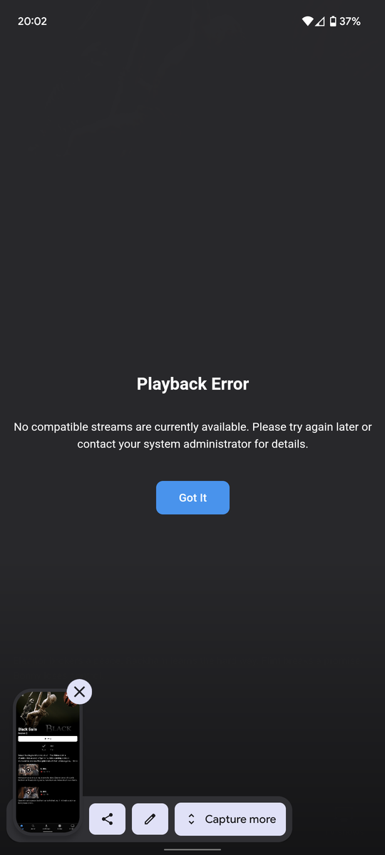

Mossop 2 Posted May 19, 2022 Posted May 19, 2022 I have a number of downloads on my Moto G Stylus. Many of them work but I just tried a couple and got an error message saying "Playback Error. No compatible streams are currently available. Please try again later or contact your system administrator for details." Shouldn't it have correctly transcoded the video to support my device before downloading?

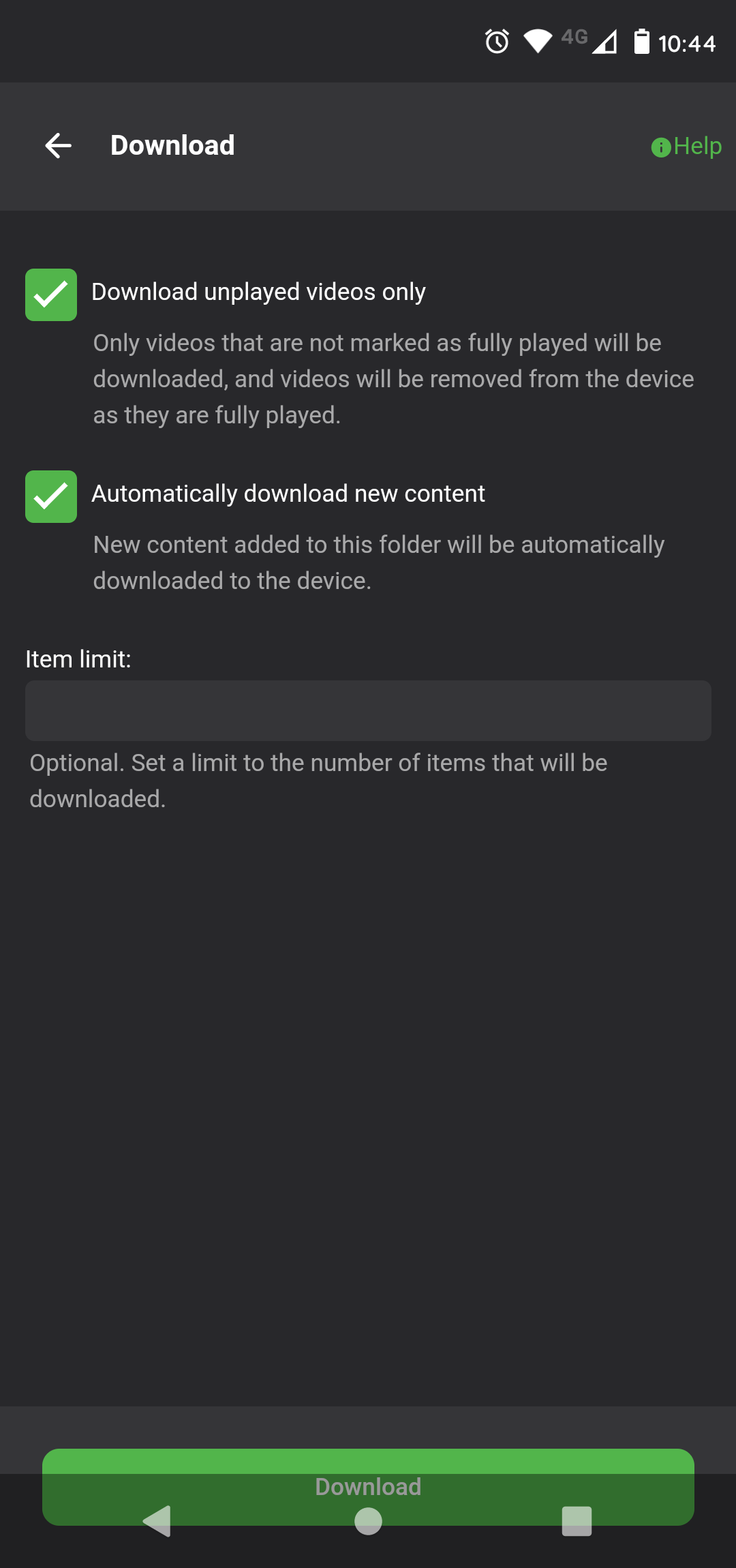

Mossop 2 Posted May 31, 2022 Author Posted May 31, 2022 On 26/05/2022 at 04:58, Luke said: Hi, please try this version: https://www.dropbox.com/s/u1obwrckg4lkjc8/emby-android-google-armeabi-v7a-release.apk?dl=0 And then provide a log from the app: Thanks. I've been unable to download anything with this version, it won't let me set up the download. I've seen this before when manually installing an Emby APK. For some reason in the download dialog the quality selection is missing, see the attached screenshot. I presume the button doesn't do anything because no quality has been selected. Note also the download button is partially overlayed by the device home/back buttons. That is a problem on all versions of Emby on my device. I see nothing at all in Internal/Android/data so I can't provide logs.

Mossop 2 Posted May 31, 2022 Author Posted May 31, 2022 50 minutes ago, Mossop said: I've been unable to download anything with this version, it won't let me set up the download. I've seen this before when manually installing an Emby APK. For some reason in the download dialog the quality selection is missing, see the attached screenshot. I presume the button doesn't do anything because no quality has been selected. I've re-installed the version from Google Play and now I see this problem there too so I'm unable to use downloads at all at this point .

KnightNZ 3 Posted June 12, 2022 Posted June 12, 2022 I got this error consistently when I had "Enable external players" enabled, but without any alternative player actually installed.
Biomorph 6 Posted June 14, 2022 Posted June 14, 2022 I have had the error 'No compatible streams' for offline files with 3.2.50 but only on MPEG4 .avi files, h264 seems to work fine with the limited testing I've done.
Luke 42241 Posted June 15, 2022 Posted June 15, 2022 18 hours ago, Biomorph said: I have had the error 'No compatible streams' for offline files with 3.2.50 but only on MPEG4 .avi files, h264 seems to work fine with the limited testing I've done. Hi @Biomorph Please try this version: https://www.dropbox.com/s/u1obwrckg4lkjc8/emby-android-google-armeabi-v7a-release.apk?dl=0 Then try to play the file producing the error, and then provide a log from the app. Thanks !
Biomorph 6 Posted June 15, 2022 Posted June 15, 2022 Have attached log files, played an x264 file first with success and then an MPEG4 file that failed with the 'compatible streams' error. embyserver-63790919157.txt hardware_detection-63790919147.txt
