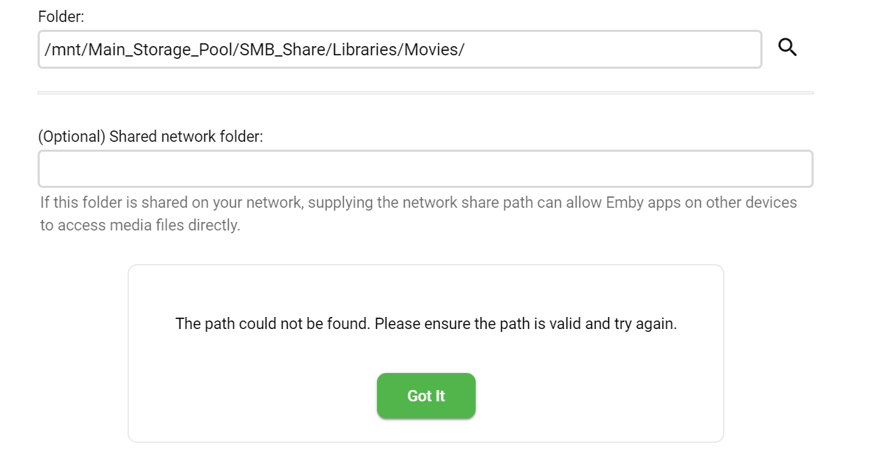

After installing Emby (with nothing altered, no custom parameters or additional options) through the Applications tab in TrueNAS and going through the setup of Emby, when making a library and choose the directory location for said library I am unable to select the directory where I have my SMB share located for easy  management of media files.
Does this have something to do with Emby not having permissions to read that directory?
SMB share is located in /mnt/Main_Storage_Pool/SMB_Share
Right now the only thing im seeing when tring to make a new library is this:
My main goal is just to have an SMB share that Emby can access so I can add/remove media  files easily.

Hi, did you try typing in the path manually?
uptivuptiz
I did. Image under spoiler to save space.
Spoiler
OK so that points to a permissions problem.
  • Solution
alucryd
@uptivuptizScale runs a kubernetes cluster, you need to map this directory as a volume inside the pod in the storage configuration, see screenshot below. You can do this with the installation wizard, or by editing the already installed application.
