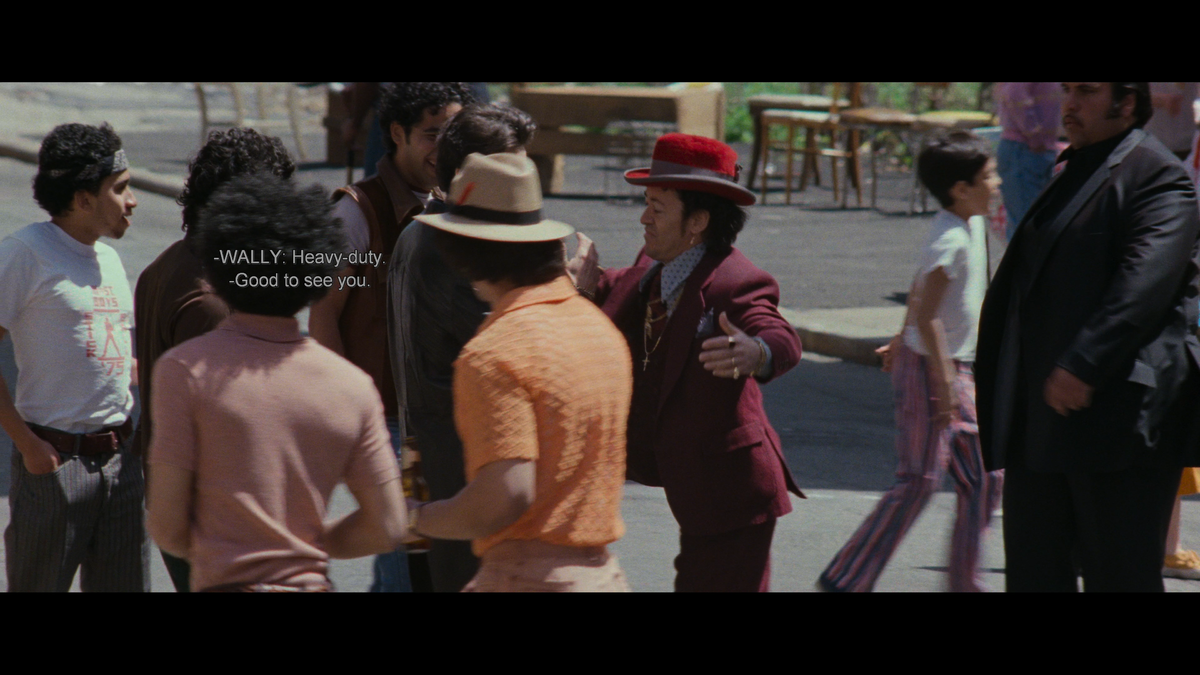

IggyPS 5 Posted May 18, 2022 Posted May 18, 2022 Hello, This is an issue I noticed today both on the Android TV app and on the web browser player. I am attaching a screenshot from the 4K version of Carlito's Way. Notice the subtitles position. And note that this is only on 4K content. Subtitles on other content are ok. Anyone else with this issue? Any ideas for solutions?
Luke 42186 Posted May 18, 2022 Posted May 18, 2022 Hi there, can we please look at an example? Thanks !
pwhodges 2023 Posted May 18, 2022 Posted May 18, 2022 What type of subtitles are they, and where di they come from? Sometimes you come across subtitles which are intended for a different resolution, and contain the expected resolution. Some programs will adjust them to fit, but others don't bother. I know that PGS subtitles intended for a higher resolution than they are being used with will render offscreen in Emby at present, so it is possible that your subtitles have not had their resolution updated from HD to 4K, and so are similarly rendering in the top-left 1080p part of the image. Paul
IggyPS 5 Posted May 19, 2022 Author Posted May 19, 2022 9 hours ago, pwhodges said: What type of subtitles are they, and where di they come from? Sometimes you come across subtitles which are intended for a different resolution, and contain the expected resolution. Some programs will adjust them to fit, but others don't bother. I know that PGS subtitles intended for a higher resolution than they are being used with will render offscreen in Emby at present, so it is possible that your subtitles have not had their resolution updated from HD to 4K, and so are similarly rendering in the top-left 1080p part of the image. Paul Embedded subs. I think I missed the important bit of information that this just started happening randomly yesterday. Before that, they always worked perfectly on all the same content. @Luke I will get the logs today after work, if that is what you meant by example.
IggyPS 5 Posted May 19, 2022 Author Posted May 19, 2022 17 hours ago, pwhodges said: it is possible that your subtitles have not had their resolution updated from HD to 4K, and so are similarly rendering in the top-left 1080p part of the image. BTW, what do you mean by this? How would one update PGS subtitles from HD to 4K?
pwhodges 2023 Posted May 19, 2022 Posted May 19, 2022 I've no idea - sorry! I can do it for ASS, but I've no programs that handle PGS other than offering to OCR it. Paul
