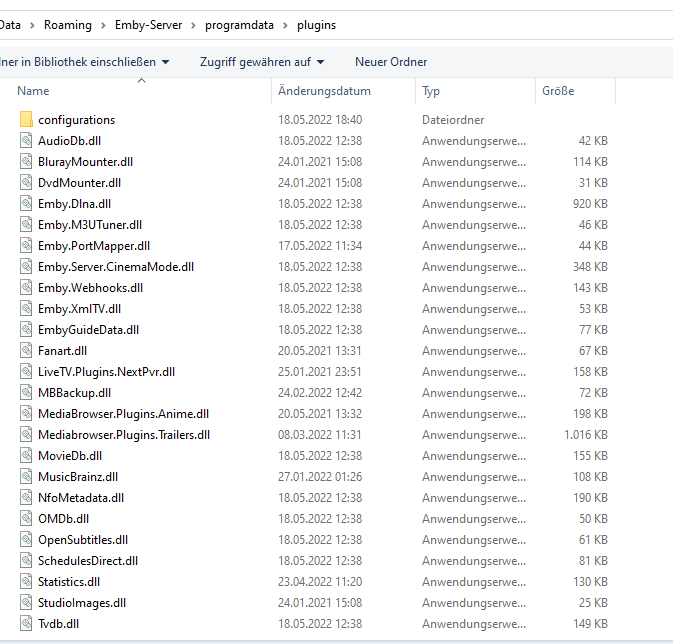

Justus 8 Posted May 18, 2022 Posted May 18, 2022 (edited) Hey since today when i started my Windows Emby server, it keeps closing after like 10 seconds. Its probably because of the Update because yesterday was everything working fine.. Logs attached. Thanks for your help! Edited May 22, 2022 by Justus
bzellinger 0 Posted May 18, 2022 Posted May 18, 2022 Same here. Unfortunately at work and can't access uploading logs. The server closed after around 10 seconds and the tray disappears. Will upload log as soon as possible.
ebr 16307 Posted May 18, 2022 Posted May 18, 2022 Hi. If you have any 3rd party plug-ins installed, try moving those out of the plugins folder and see if that makes a difference.
Justus 8 Posted May 18, 2022 Author Posted May 18, 2022 I removed an old version of IntroSkip, but the problem persists. The plugin was the only one I installed manually as far as I remember....
ArtMetz 5 Posted May 18, 2022 Posted May 18, 2022 My similar issue likely is with the NextPVR plugin. I tried removing it as well as removing the settings in livetv.xml. embyserver.txt 1
Justus 8 Posted May 18, 2022 Author Posted May 18, 2022 Ah you're right! Deleted NextPVR aswell and it seems to work now. Thanks!
Luke 42186 Posted May 18, 2022 Posted May 18, 2022 Thanks for the feedback. Once you're back up and running, if you'd still like to use Next Pvr then you can install using the plugin catalog and setup using the new process outlined here: Thanks. 1
ArtMetz 5 Posted May 18, 2022 Posted May 18, 2022 Deleting the plugin dll didn't work for me. The DLL reappears automatically and the system still crashes.
Luke 42186 Posted May 18, 2022 Posted May 18, 2022 14 minutes ago, ArtMetz said: Deleting the plugin dll didn't work for me. The DLL reappears automatically and the system still crashes. What exactly did you delete?
Luke 42186 Posted May 18, 2022 Posted May 18, 2022 3 minutes ago, ArtMetz said: LiveTV.Plugins.NextPvr.dll Can you attach a new log file after doing that?
ArtMetz 5 Posted May 18, 2022 Posted May 18, 2022 Appears to be working now after a reboot. I had removed the dll and the TunerHostInfo section from livetv.xml. I will try reconfiguring NextPVR a bit later. 1
