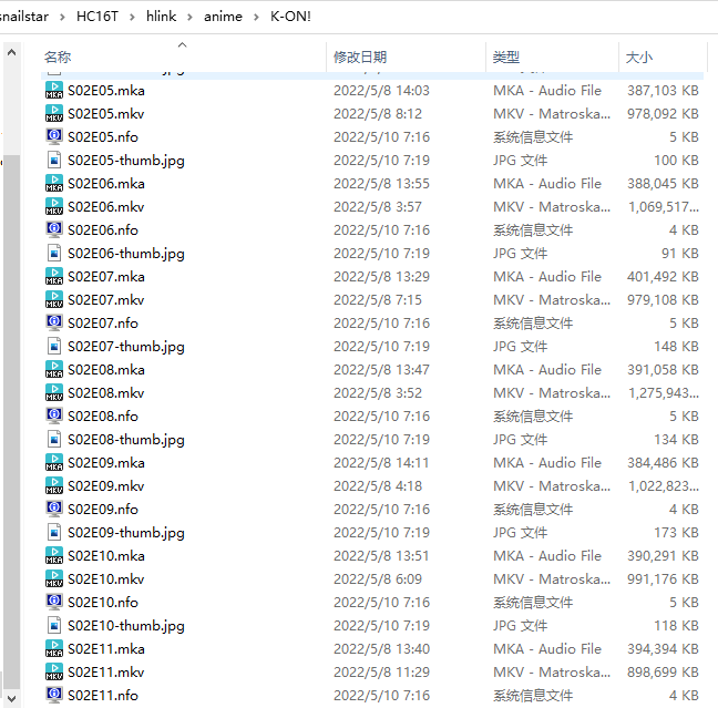

Chiyu 3 Posted May 13, 2022 Posted May 13, 2022 I have some external audio files,which is in FLAC format or mka. And I already have rename this files to same format.
Luke 42186 Posted May 13, 2022 Posted May 13, 2022 Hi there, can you please go over an example? Thanks.

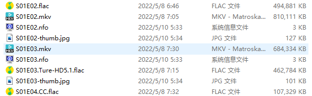

Chiyu 3 Posted May 13, 2022 Author Posted May 13, 2022 (edited) 19 minutes ago, Luke said: Hi there, can you please go over an example? Thanks. For example,The anime K-ON has some other languages audio track in mka format. And The anime Code geass has the Audio commentary track in flac format But,I can't find those audio files in my emby K-on: Code geass: Edited May 13, 2022 by Chiyu
Luke 42186 Posted May 13, 2022 Posted May 13, 2022 Ok.. External audio for video is not supported, but you never know for the future. Thanks.
Chiyu 3 Posted May 13, 2022 Author Posted May 13, 2022 4 minutes ago, Luke said: Ok.. External audio for video is not supported, but you never know for the future. Thanks. Thank you for answering this.I will looking forward to this function in the future
