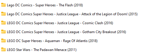

jasonmcroy 320 Posted May 10, 2022 Author Posted May 10, 2022 Thanks for your answer @Luke. I guess then I have to ask why Emby has so much trouble with those particular files every time I re-install a server? Just as a note, it always picks up The Padawan Menace fine and the Jurassic World file correctly as well. But all the others get really odd replacements. Most of them show up as "The Lego Movie" (which I also have in my library). Kodi also always gets these file wrong but for some reason Plex always picks them up correctly as well as my Channels DVR server. Here is a screenshot of those files in my folder:

Luke 42186 Posted May 10, 2022 Posted May 10, 2022 7 minutes ago, jasonmcroy said: Thanks for your answer @Luke. I guess then I have to ask why Emby has so much trouble with those particular files every time I re-install a server? Just as a note, it always picks up The Padawan Menace fine and the Jurassic World file correctly as well. But all the others get really odd replacements. Most of them show up as "The Lego Movie" (which I also have in my library). Kodi also always gets these file wrong but for some reason Plex always picks them up correctly as well as my Channels DVR server. Here is a screenshot of those files in my folder: It won't have any trouble with those names. We'll have to look at an example from when they were imported: Thanks.
Happy2Play 9800 Posted May 10, 2022 Posted May 10, 2022 3 hours ago, Luke said: It won't have any trouble with those names. We'll have to look at an example from when they were imported: Thanks. Example here "Lego DC Comics - Super Heroes - The Flash (2018)" is misidentified as "The Lego Ninjago Movie". But you can see only "Lego" and year are being queried, and from that query Ninjago is the first result and The Flash being second. So a question would be why was the query parsed to "Lego" only? 2022-05-10 13:23:13.184 Info App: MovieDbProvider: Finding id for item: Lego DC Comics - Super Heroes - The Flash (2018) 2022-05-10 13:23:13.188 Debug App: Throttling Tmdb by 203 ms 2022-05-10 13:23:13.409 Info HttpClient: GET https://api.themoviedb.org/3/search/movie?api_keyf6bd687ffa63cd282b6ff2c6877f266&query=Lego&language=en&year=2018 2022-05-10 13:23:13.565 Debug App: Throttling Tmdb by 143 ms 2022-05-10 13:23:13.715 Info HttpClient: GET https://api.themoviedb.org/3/movie/274862?api_key=f6bd687ffa63cd282b6ff2c6877f2669&append_to_response=casts,releases,images,keywords,trailers&language=en&include_image_language=en,null But note my test was in beta 4.7.0.38.
