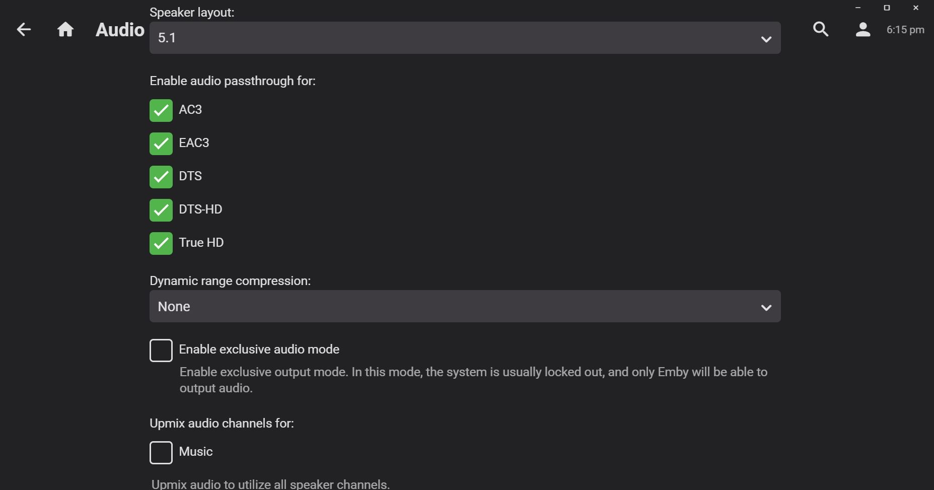

mitch2471 11 Posted May 9, 2022 Posted May 9, 2022 First of all, I am running Emby Theater on a windows 10 pc with the latest emby server installed on the same machine. I have the pc connected to an AV receiver via hdmi. The issue I’m having is that films with DD/DTS/DTS HD/Dolby HD quite often play with no sound. With most I can stop the playback & restart from the beginning & then I get sound. I have one film which has True HD surround sound & the audio just cuts in & out constantly no matter what I do. Sometimes I get the in/out sound effect on just standard 5.1 AC3. Any suggestions on how to resolve this?
Luke 42239 Posted May 9, 2022 Posted May 9, 2022 Hi there, how have you configured sound options in the app?
mitch2471 11 Posted May 9, 2022 Author Posted May 9, 2022 I've tried using the enable exclusive audio mode but it made no difference.
Luke 42239 Posted May 9, 2022 Posted May 9, 2022 What happens if you uncheck the passthrough options?
mitch2471 11 Posted May 9, 2022 Author Posted May 9, 2022 If I unchecked the pass through options I get a stereo output. No cutting in or out of sound.
