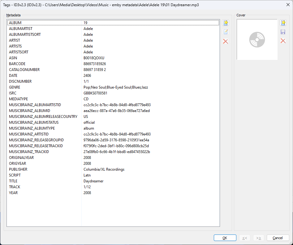

Happy2Play 9814 Posted May 9, 2022 Posted May 9, 2022 Use a forward slash or semi-colon delimiter. Pop;Neo Soul;Blue-Eyed Soul;Blues;Jazz Pop/Neo Soul/Blue-Eyed Soul/Blues/Jazz Currently Emby only writes nfo files but does not use them so all information will come from embedded tags. But \\ might be another delimiter for @Luketo consider.

Happy2Play 9814 Posted May 9, 2022 Posted May 9, 2022 1 minute ago, EZEd said: @Happy, you do this (use the semicolon or forward slash) inside of MP3Tag or inside of Emby metadata editor? In mp3tag via extended tags or genre column or directly in Genre field. Emby should see the updates but if it doesn't then Refresh the Album.

EZEd 60 Posted May 10, 2022 Author Posted May 10, 2022 (edited) I used semicolon (;) in between all entries and obtained the desired effect. I did not try regular comma but I'm sure it would have worked too. I was using forward slash (/) as another delimiter and it was causing other problems, so I replaced all forward slashes with spaces, and all came out well. So evidently forward slash also works as delimiter similar to semicolon and comma. I don't know why the instructions in MP3Tag say to use double backslash (\\). For sure that one did NOT work. Maybe both Happy2Play and wordlover should give their advice to MP3Tag folks since it doesn't look like they know their own product. Anyways, it all worked out fine...thanks to you both for info. Edited May 10, 2022 by EZEd 1
