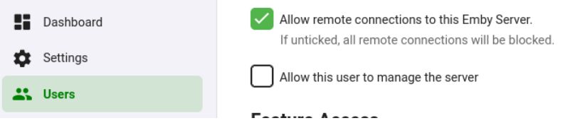

mengoshmink 16 Posted May 8, 2022 Posted May 8, 2022 (edited) Does this help: and Edited May 8, 2022 by mengoshmink

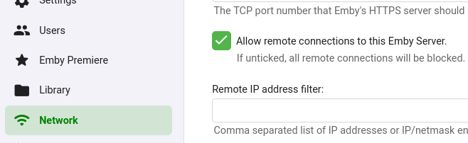

GrimReaper 4898 Posted May 8, 2022 Posted May 8, 2022 10 hours ago, QuarkZ said: So, turn off "Allow remote connections to this Emby Server." 2 minutes ago, mengoshmink said: Does this help: Guys, turning that off is beating the purpose of securing sever for WAN access in the first place, as only local connections would be allowed. @Raskolnikov, you don't want that option Off for your query. What you do want, however, is either setup SSL or go reverse proxy route, as suggested above, number of guides around forum, check out General/Windows section, adjust for Linux.
QuarkZ 14 Posted May 8, 2022 Posted May 8, 2022 34 minutes ago, GrimReaper said: Guys, turning that off is beating the purpose of securing sever for WAN access in the first place, as only local connections would be allowed. @Raskolnikov, you don't want that option Off for your query. What you do want, however, is either setup SSL or go reverse proxy route, as suggested above, number of guides around forum, check out General/Windows section, adjust for Linux. I was indeed referring to the Users option, obviously not the Network option. It should absolutely be ticked off for any admin as otherwise it could potentially allow admin remote login. I also hide the user from login screen when connecting remote.
GrimReaper 4898 Posted May 8, 2022 Posted May 8, 2022 2 minutes ago, QuarkZ said: I was indeed referring to the Users option, obviously not the Network option. It should absolutely be ticked off for any admin as otherwise it could potentially allow admin remote login. I also hide the user from login screen when connecting remote. There is NO such option on per-User basis, there is only single, global one. As far as Users are concerned, you can revoke admin privileges, hide when connected remotely (but it doesn't prevent them to login manually) and/or hide from devices they haven't logged before - but you cannot prevent remote access, admin or not.

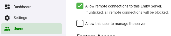

QuarkZ 14 Posted May 8, 2022 Posted May 8, 2022 15 minutes ago, GrimReaper said: There is NO such option on per-User basis, there is only single, global one. As far as Users are concerned, you can revoke admin privileges, hide when connected remotely (but it doesn't prevent them to login manually) and/or hide from devices they haven't logged before - but you cannot prevent remote access, admin or not. Sorry, but you are simply wrong. There is a per user option, you can see it in the screenshot from mengoshmink. I have several users on my emby and can absolutely prevent only certain accounts to login when remote using that option, I actually just tested it on one account and get an error if I try to login with a user that has that option unchecked.
GrimReaper 4898 Posted May 8, 2022 Posted May 8, 2022 (edited) 9 minutes ago, QuarkZ said: Sorry, but you are simply wrong. There is a per user option, you can see it in the screenshot from mengoshmink. I have several users on my emby and can absolutely prevent only certain accounts to login when remote using that option, I actually just tested it on one account and get an error if I try to login with a user that has that option unchecked. There is not. What you see in that screenshot is SERVER setting, single global setting, that ANY USER with admin privileges (enabled Allow this user to manage server under User settings) can enable or disable. If ANY of those users is logged and untick Allow remote connection, NOONE will be able to acces it remotely, no other user, admin or not. Edited May 8, 2022 by GrimReaper
QuarkZ 14 Posted May 8, 2022 Posted May 8, 2022 3 minutes ago, GrimReaper said: What you see in that screenshot is SERVER setting, single global setting, that ANY USER with admin privileges (enabled Allow this user to manage server under User settings) can enable or disable. If ANY of those users is logged and untick Allow remote connection, NOONE will be able to acces it remotely, no other user, admin or not. We must be talking past eachother here. I know that the Network option must be enabled, I'm talking about the Users option, which prevents particular accounts to logging in while accessing Emby remotely. 1
GrimReaper 4898 Posted May 8, 2022 Posted May 8, 2022 (edited) 12 minutes ago, QuarkZ said: We must be talking past eachother here. I know that the Network option must be enabled, I'm talking about the Users option, which prevents particular accounts to logging in while accessing Emby remotely. I have never seen that option until now, as I don't have it under any of my servers (Windows, though). Thank you for that, it's always nice to learn something new. Is that a Linux-only thing, @Luke? Edited May 8, 2022 by GrimReaper
rodainas 191 Posted May 8, 2022 Posted May 8, 2022 4 minutes ago, GrimReaper said: I have never seen that option until now, as I don't have it under any of my servers (Windows, though). Thank you for that, it's always nice to learn something new. Is that a Linux-only thing, @Luke? If you have disabled the remote connections on the Network settings sections then it won't be available on the Users settings. 1
GrimReaper 4898 Posted May 8, 2022 Posted May 8, 2022 4 minutes ago, rodainas said: If you have disabled the remote connections on the Network settings sections then it won't be available on the Users settings. Yep, got it now, mine is always disabled hence never noticed that. 1
QuarkZ 14 Posted May 8, 2022 Posted May 8, 2022 5 minutes ago, rodainas said: If you have disabled the remote connections on the Network settings sections then it won't be available on the Users settings. Well that explains it, I was very confused here! lol Thanks! 2
