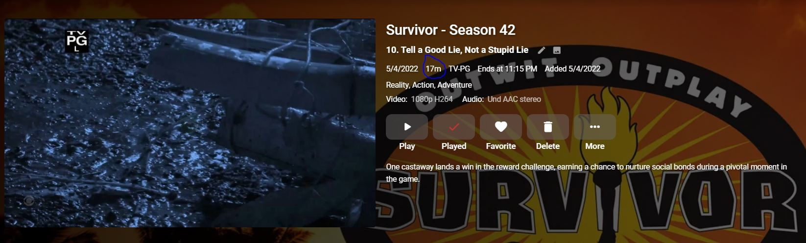

VisiPunk 0 Posted May 5, 2022 Posted May 5, 2022 For a few weeks now, my scheduled recordings start, then fail for whatever reason. Log is attached. I viewed the log but cannot tell if this is a problem with my Emby server or my IPTV service. Recordings are hit or miss, sometimes they work, sometimes they don't. Example: 'Survivor' is setup as a series record, new episodes on CBS at 8pm Eastern. Tonight's episode recorded 17 mins then dropped. Why is this happening? embyserver.txt

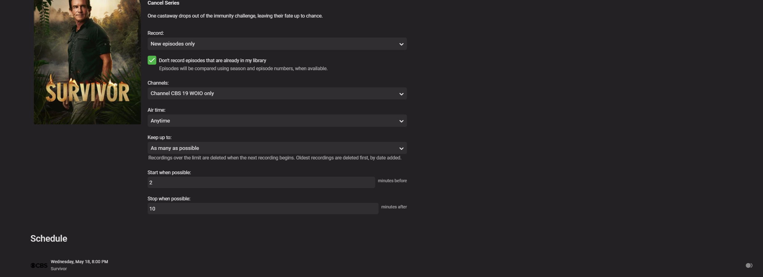

VisiPunk 0 Posted May 19, 2022 Author Posted May 19, 2022 This is still not working. Survivor was the only schedule today at 8pm eastern time. There is no sign of it in the logs or in the library. Since this is an OTA station, I think I am just going to spend the $30 and get an OTA DVR at Walmart and be done with this nonsense.
Luke 42243 Posted May 19, 2022 Posted May 19, 2022 10 minutes ago, VisiPunk said: This is still not working. Survivor was the only schedule today at 8pm eastern time. There is no sign of it in the logs or in the library. Since this is an OTA station, I think I am just going to spend the $30 and get an OTA DVR at Walmart and be done with this nonsense. Hi, try unchecking the option for new episodes only.
