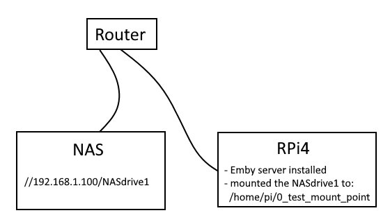

0v3rl0rd 5 Posted May 4, 2022 Posted May 4, 2022 (edited) So, what I have is a NAS with a shared folder (//192.168.1.100/NASdrive1) and a Raspberry Pi 4 with Emby server installed. On the Raspberry Pi4 I mounted the NAS folder using FSTAB: //192.168.1.100/NASdrive1 /home/pi/0_test_mount_point cifs credentials=/home/pi/.smbcredentials,file_mode=0777,dir_mode=0777,gid=1000,uid=1000,_netdev 0 0 And I can write normally: from within Linux, from SSH, and from Win10 (if I mount the same folder again in Win10 PC), no problems with that. But, another problem turned up - EMBY. It is set up so that it should save all the metadata inside the movies folders (on the mounted NAS drive) - but instead it saves the metadata on the RPi itself. It seems to me that it cannot write to the mounted NAS drive. I also added user "emby" to "sudo" group. Any info? PS, I know I can set the Emby up on the NAS itself, but that's not the point Edited May 4, 2022 by 0v3rl0rd
