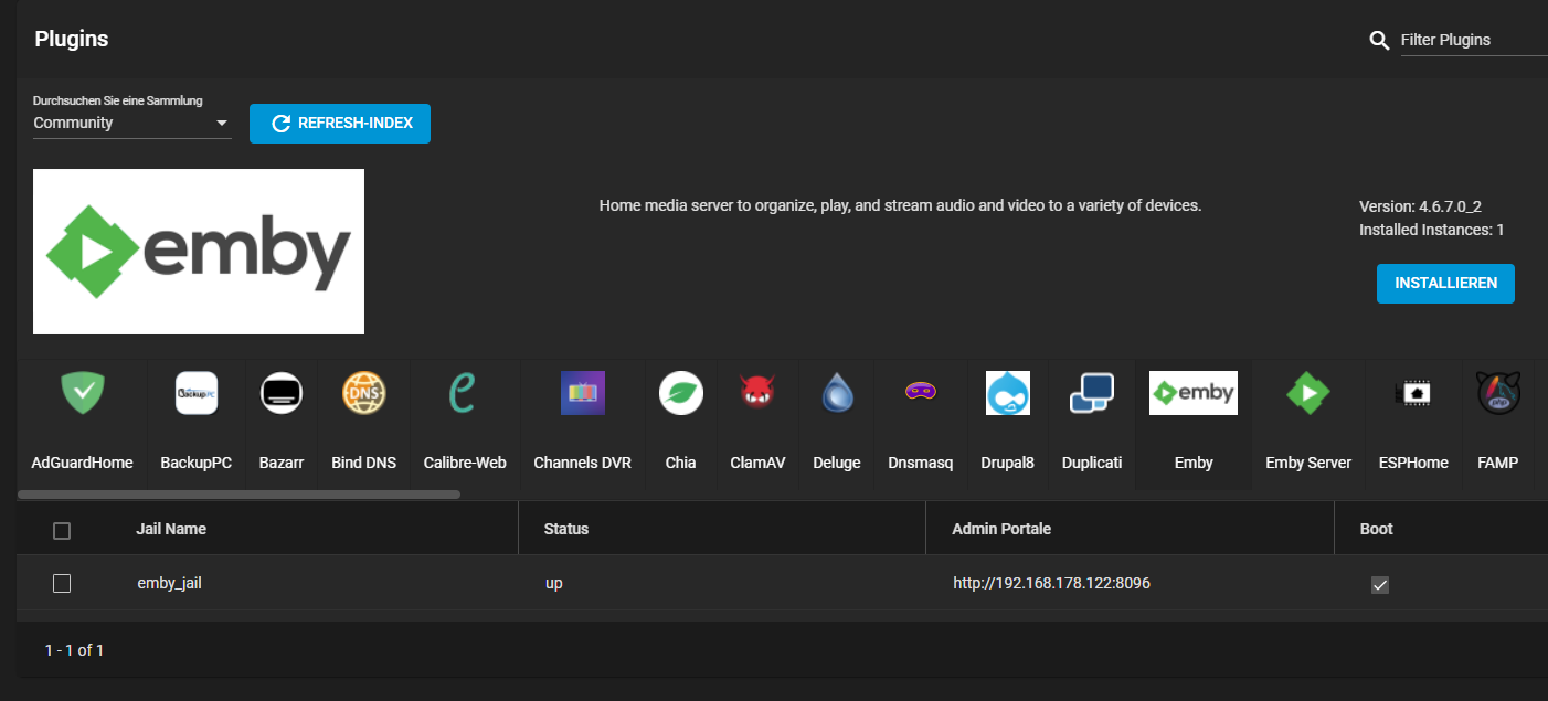

Guest Posted May 10, 2022 Posted May 10, 2022 (edited) 4 hours ago, Happy2Play said: A guess would be @DooDafiitis not using our FFMPEG and it is causing issues. @Luke 2022-05-05 00:00:00.106 Info App: Emby Command line: /usr/local/lib/emby-server/system/EmbyServer.exe -os freebsd -ffmpeg /usr/local/bin/ffmpeg -ffprobe /usr/local/bin/ffprobe -programdata /var/db/emby-server -updatepackage emby-server-freebsd_{version}_amd64.txz -noautorunwebapp Operating system: Unix 12.2.14.0 ffmpeg version 4.4.2 Copyright (c) 2000-2021 the FFmpeg developers built with FreeBSD clang version 10.0.1 (git@github.com:llvm/llvm-project.git llvmorg-10.0.1-0-gef32c611aa2) How did you install FreeBSD? I think I installed TrueNAS with the instructions here: https://www.truenas.com/docs/core/gettingstarted/install/ For the emby server I used the following plugin: @Happy2PlayWhy does it then work in the web player and Kodi with no issues? And as I said in my first post I have the same problems Emby server on WD My Cloud PR4100. 5 hours ago, Luke said: @DooDafiit it looks like you sideloaded our Android TV app. Can you try sideloading our standard android app on the same device and let us know how that compares? https://emby.media/emby-for-android.html Thanks ! Done and no positive news. Nothing changed. Edited May 10, 2022 by DooDafiit
