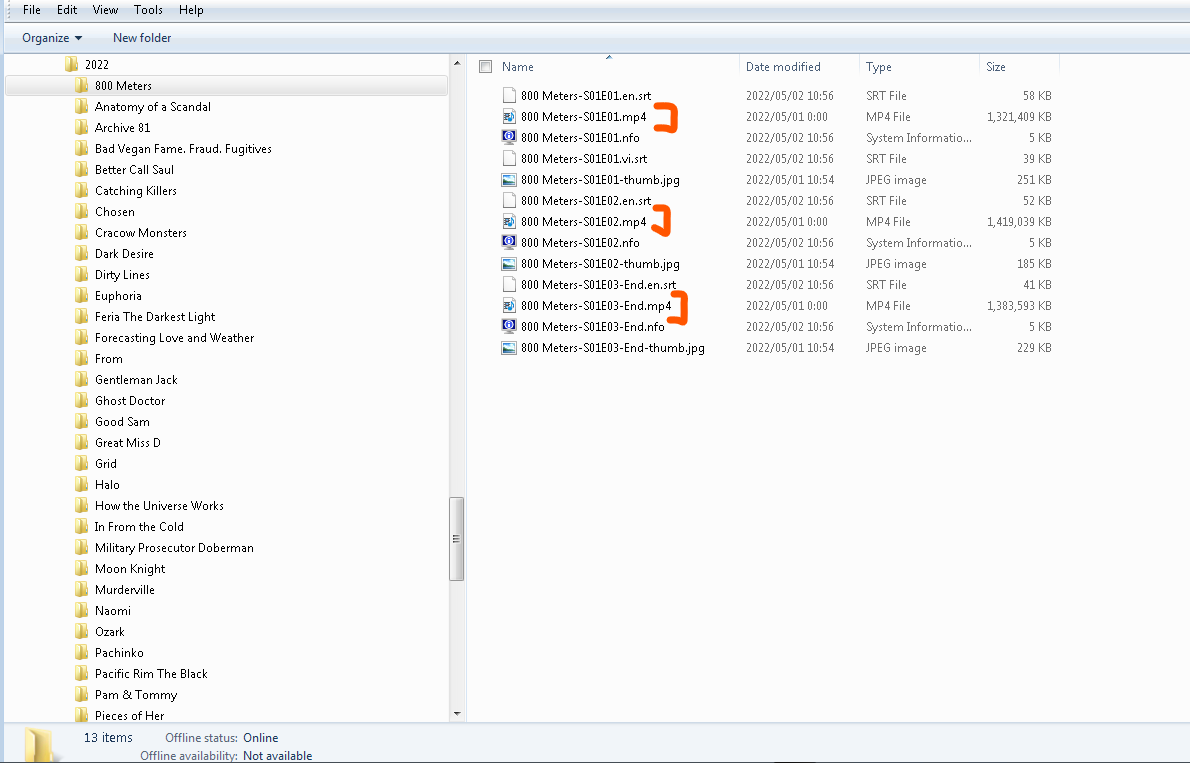

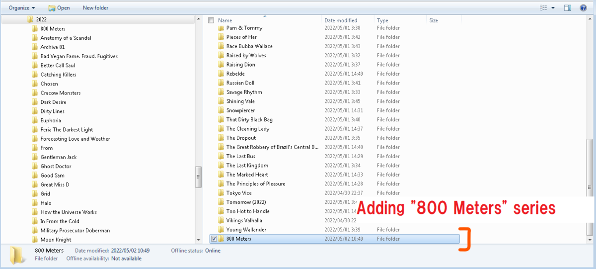

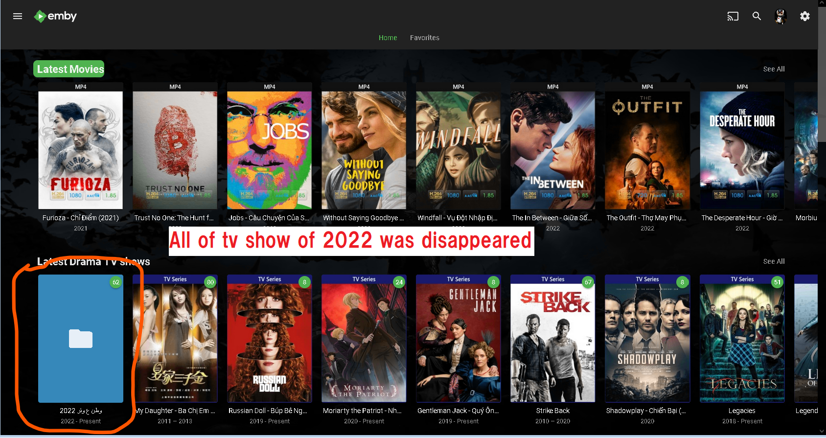

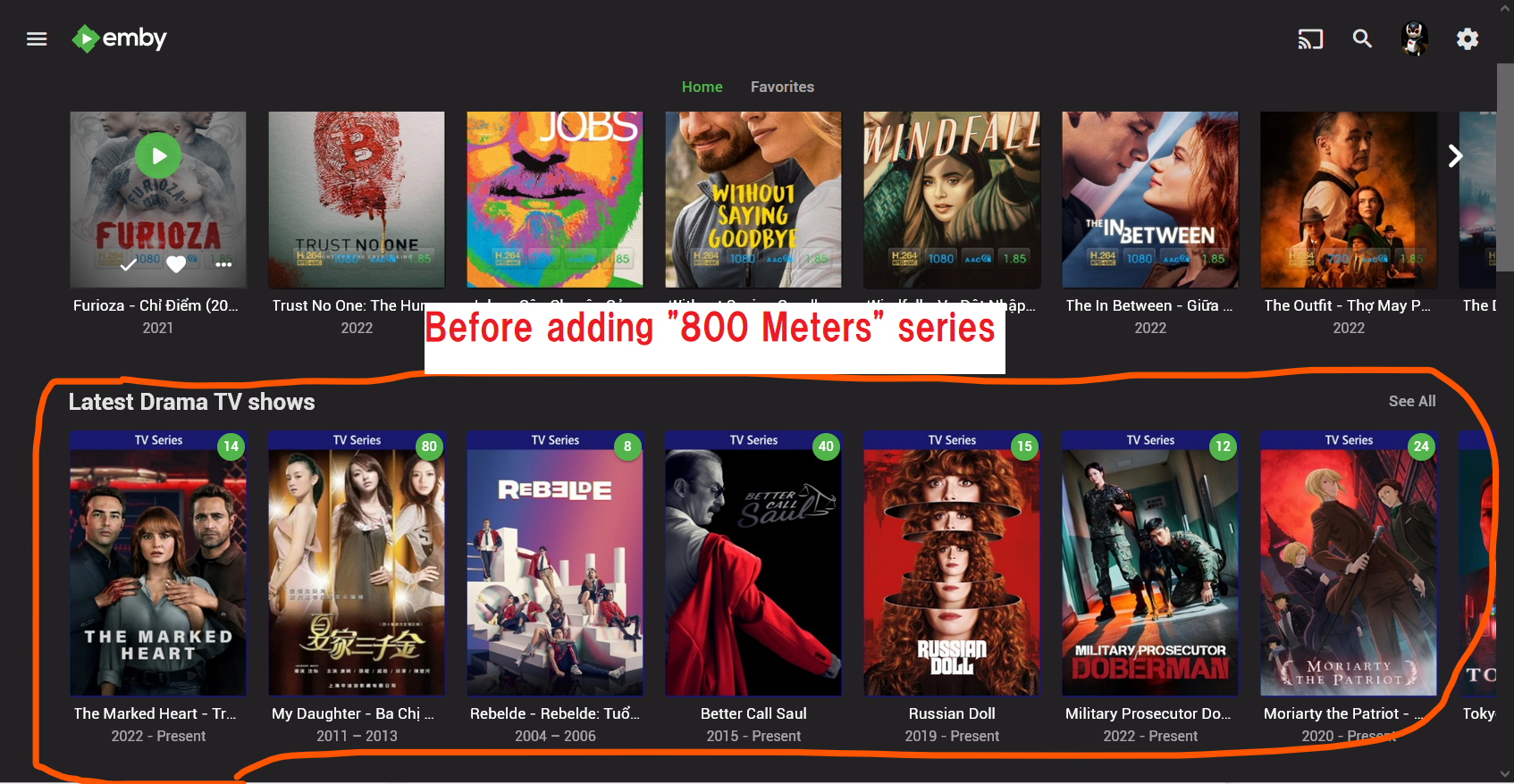

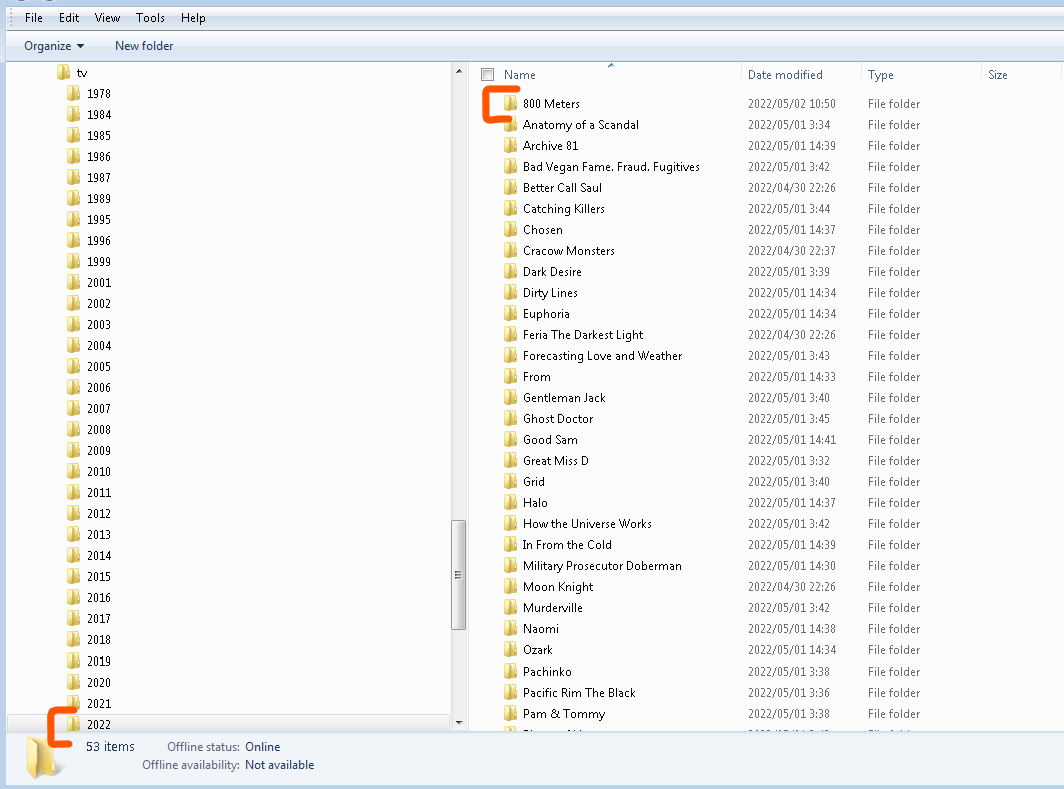

ngmdat 6 Posted May 2, 2022 Posted May 2, 2022 hi Guys, Ubuntu Emby server was crashed tv show folder when it's scanning "800 Meters (2022)" series. thanks for any advices
Luke 42246 Posted May 2, 2022 Posted May 2, 2022 Hi there, can you please describe the problem in more detail? What exactly happened?
ngmdat 6 Posted May 2, 2022 Author Posted May 2, 2022 @Luke thanks Ad. please find out detail with attached the images

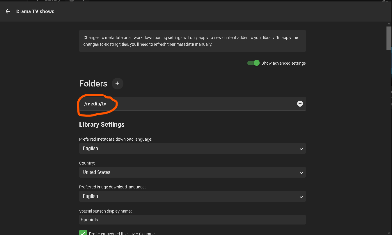

Happy2Play 9813 Posted May 2, 2022 Posted May 2, 2022 Can you post the server log for when you added this show. I had no issue adding this show but used 800 Meters (2022). Actually the only issue was images as there are no English images. What folder does your library point to? But a wild guess is Emby created a Series out of the "2022" nested folder.
Happy2Play 9813 Posted May 2, 2022 Posted May 2, 2022 Also does removing this Series correct the issue? But as mentioned am guessing the parser is getting confused with all the numbers "*/2022/800 Meters" as this happened after adding a Series with number in name.
ngmdat 6 Posted May 2, 2022 Author Posted May 2, 2022 (edited) @Happy2Play thanks for your response, for each category as movies, tv show ect. I created each folder and nest to each year for each contents. as for tv show i have the following configuration. Also if i'll remove "800 Meters" series, and re-scanning, this issue will be corrected. Edited May 2, 2022 by ngmdat

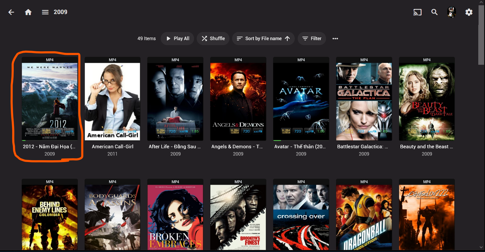

ngmdat 6 Posted May 2, 2022 Author Posted May 2, 2022 (edited) @Happy2Play > But as mentioned am guessing the parser is getting confused with all the numbers "*/2022/800 Meters" as this happened after adding a Series with number in name. Yes, i think Emby serve need to add some code to parse the name of content when they're number as this case. we can not change name of contents, because they are a key to search meta data from Web. Actually, for Movies content, Emby server worked fine with "2012" movie. Edited May 2, 2022 by ngmdat
ngmdat 6 Posted May 2, 2022 Author Posted May 2, 2022 (edited) we just have 3 contents for series at now, as following image. Edited May 2, 2022 by ngmdat
Happy2Play 9813 Posted May 2, 2022 Posted May 2, 2022 If you add an actual Season 1 folder does it help? But yes there are quirks like this in a nested TV library as it is hard to determine what level the series actually starts in everyone's environment.
ngmdat 6 Posted May 2, 2022 Author Posted May 2, 2022 (edited) @Happy2Play thanks for you comment, but I'm not sure that i undertand what you're talking about. As you see the images of tv show folder that i attached above. The Emby server has already work fine with same way to created folders for 31 years (1984-2022) for other similar series. Can you get the same result occur if you could create a similar folder ("800 Meters") in your Emby server environment? Edited May 2, 2022 by ngmdat
Happy2Play 9813 Posted May 2, 2022 Posted May 2, 2022 Yes this is reproducible 2022 becomes a Series folder with your exact structure without season folders. C:\Users\Media\Desktop\Videos\TV Shows - DB\2022\800 Meters\800 Meters-S01E01.strm But adding a true SEASON X folder corrects the issue cause in a Nested folder environment as it changes series level to 800 Meters instead of 2022. C:\Users\Media\Desktop\Videos\TV Shows - DB\2022\800 Meters\Season 1\800 Meters-S01E01.strm
