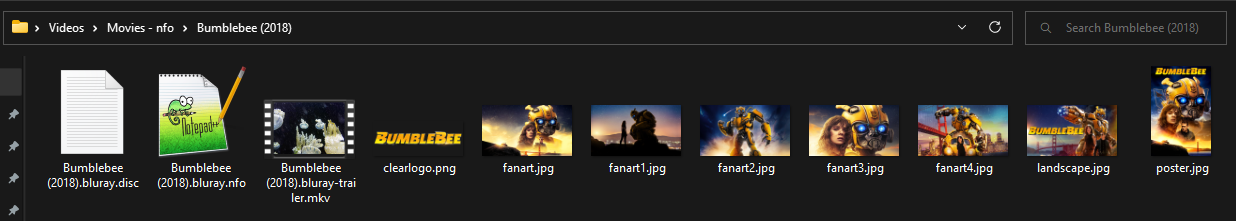

Happy2Play 9814 Posted May 1, 2022 Posted May 1, 2022 Just now, jlj1950 said: What do you mean by "written with media?" And "Images with media?" Thank you. Images store with media vs centrally stored in /metadata/library. Per library setting "Save artwork into media folders". If saved with media, the only way to lose is if you lose the media.
jlj1950 7 Posted May 2, 2022 Author Posted May 2, 2022 On 4/30/2022 at 10:31 PM, Happy2Play said: Images store with media vs centrally stored in /metadata/library. Per library setting "Save artwork into media folders". If saved with media, the only way to lose is if you lose the media. Thanks. This clarifies a lot. I have the appropriate box checked in the libraries' forms.
