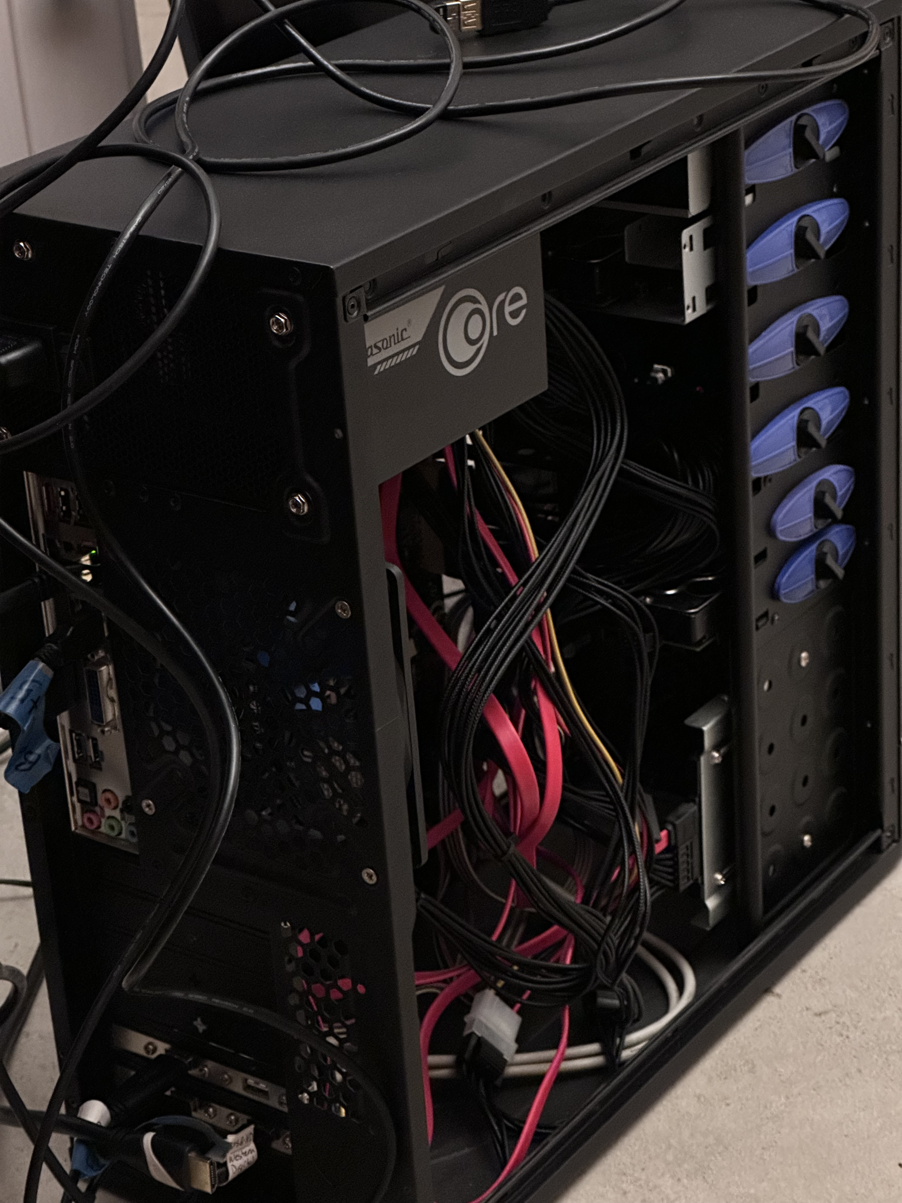

michaeltruncale 8 Posted August 3, 2025 Posted August 3, 2025 @RanmaCanadaokay so I never did upgrade anything and we just tossed the PC in the “basement” of the RV. Worked out fine for the time… however last Friday we had a power outrage / surge, blew the PSU (which was a Seasonic Titanium btw), I swapped out the PSU and the thing isn’t booting, the drives spin, and the cat 5 light comes on, the MB even has 2 short beeps upon turning on the power. No video displayed and from what I can tell it’s not booting because it never joins the network. So now I actually need to upgrade . Is that Pentium Gold 7400 still one you’d recommend or is there something else these days? Ironically I just replaced my Mac too and added Emby on the Mac mini M4, but it has issues with our Sony 65” 4k tv running Android OS… and I kind of like having Emby on it’s own server anyway.
RanmaCanada 502 Posted August 6, 2025 Posted August 6, 2025 @michaeltruncaleI am wondering if an N100/N150 micro system with a USB mult-enclosure, or even a laptop with one, or worse, something like a synology. Do you still use the TV Tuners? If you do, none of these will do, and you will be forced into a desktop.
michaeltruncale 8 Posted August 6, 2025 Posted August 6, 2025 @RanmaCanadaWe actually do not use the TV Tuners anymore. What's the speed comparison on N100/N150 versus what I had, and versus the M4? i.e., any idea on being able to fun multiple streams of 4K and 1080p?
