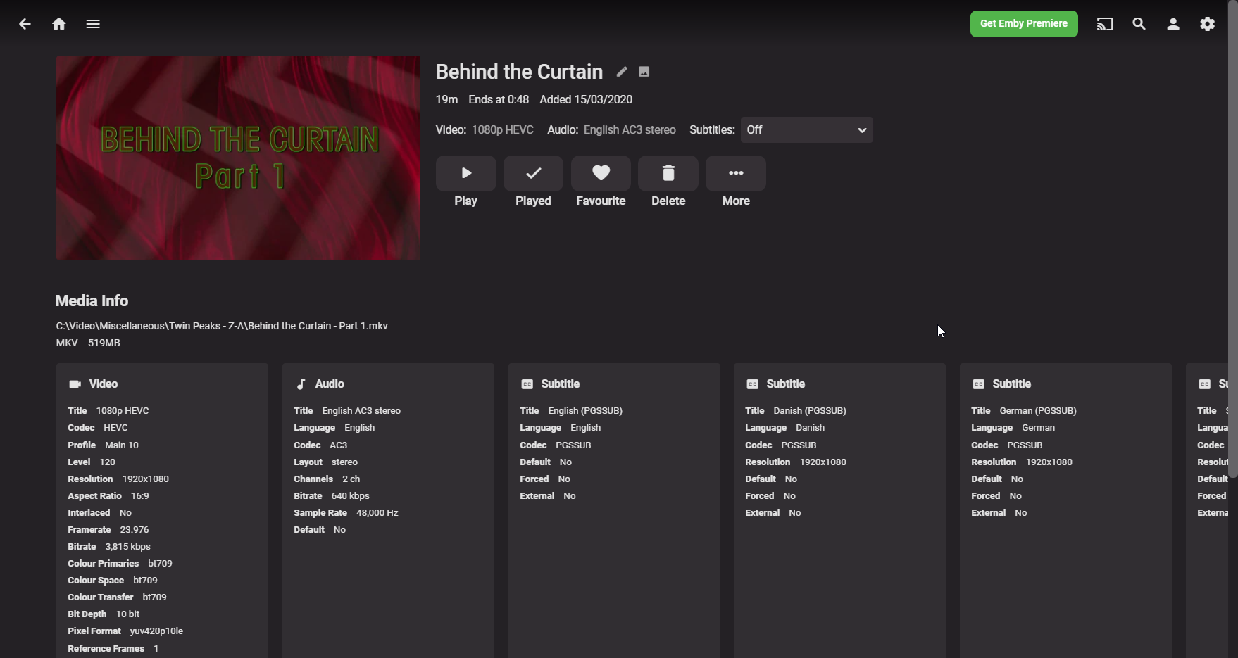

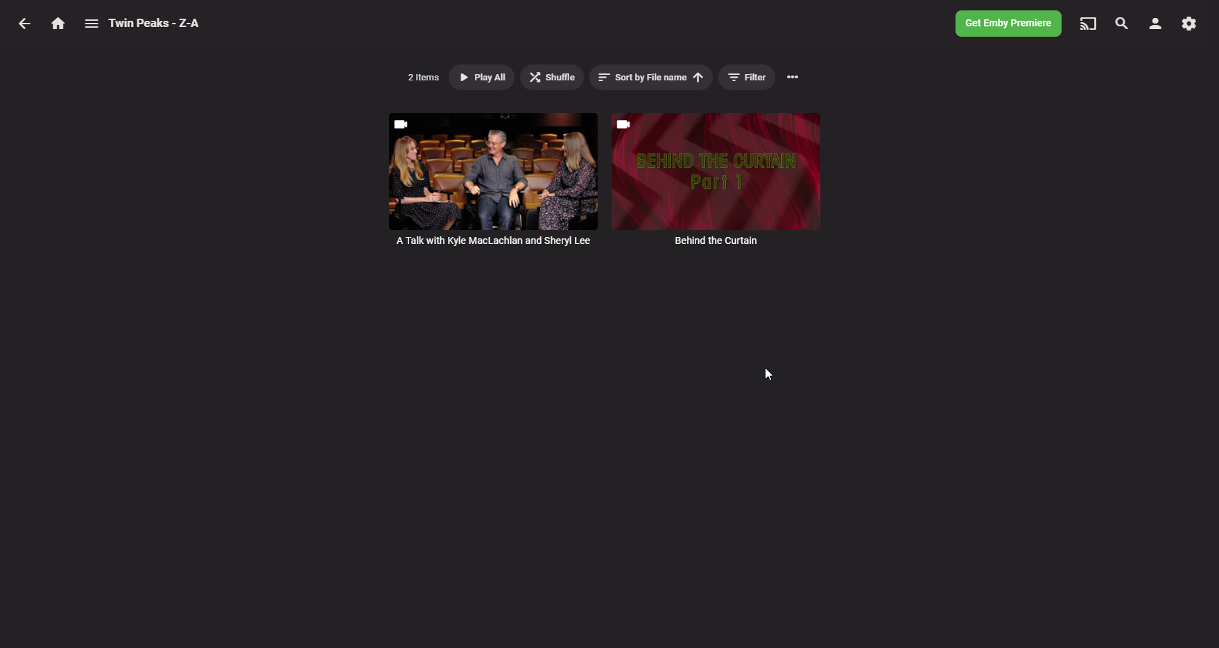

hedgehog90 19 Posted April 29, 2022 Posted April 29, 2022 (edited) I have a sequence of files named 'Behind the Curtain - Part 1' through to 'Behind the Curtain - Part 18' but when I view it in Folder view in Emby, it just shows Part 1. I would expect to see 'Additional parts' at the top of the page, but no matter what I do I can't get it to appear, making Part 2 - 18 completely inaccessible through Emby. Presumably it needs to be in a library with type Movie to show 'additional parts'... but then there's clearly an issue if it refuses to show Parts 2-18 in any other type library. I've tried changing from Mixed Content to Home Videos and Photos. Doesn't help. In a folder with 19 files, this is all I see: I've tried everything besides renaming the files to some crazy naming scheme... because that's not an acceptable solution. Edited April 29, 2022 by hedgehog90
Luke 42186 Posted April 29, 2022 Posted April 29, 2022 Hi there, can you show us the contents of the folder? Thanks.

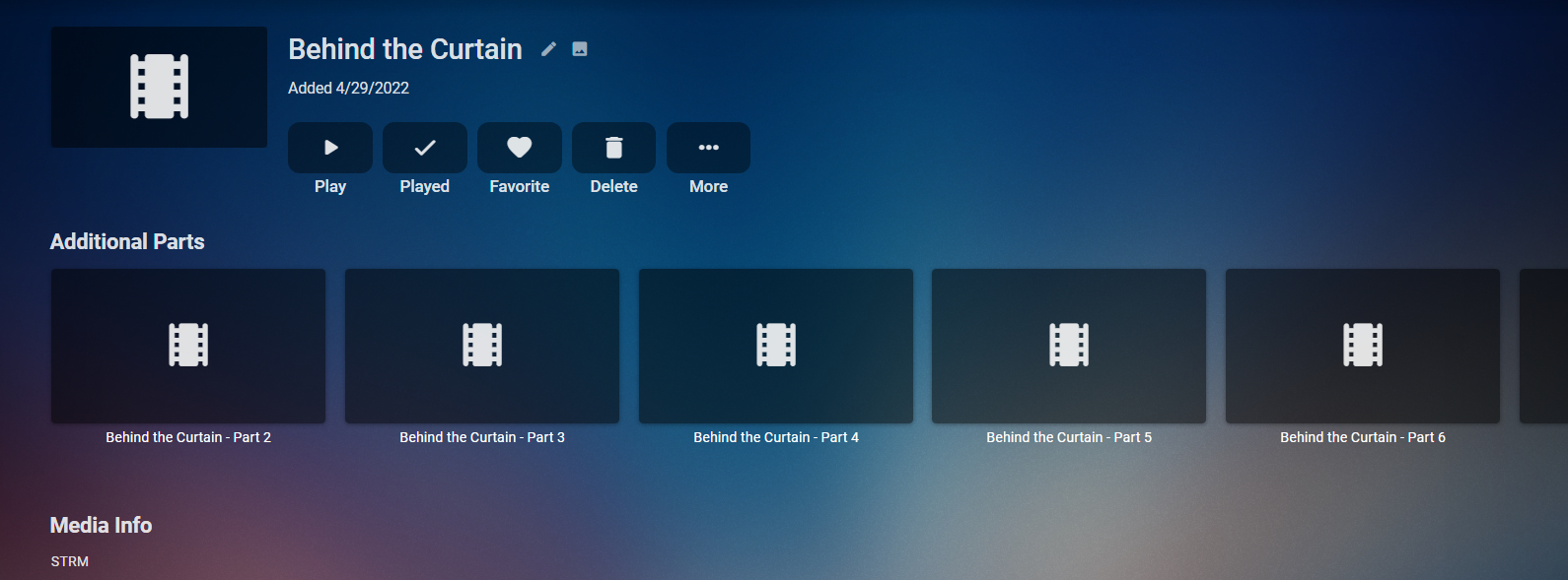

Happy2Play 9800 Posted April 29, 2022 Posted April 29, 2022 (edited) Tested in Home Videos and Photos. Show all 18 parts. Content place in Photo folder. But looking at your screen shot you have videos in "Twin Peaks Z-A" folder instead of a "Behind the Curtain" folder. From the KB. Quote Split videos require all parts be in the same movie folder with no other videos present Does the KB need amended to same name movie folder as shown in the example? Edited April 29, 2022 by Happy2Play 1
hedgehog90 19 Posted April 30, 2022 Author Posted April 30, 2022 I put them in all in a subfolder 'Behind the Curtain' and that worked, thanks. I still think there's something very flawed about this if this is intended behaviour and could easily be improved.

hedgehog90 19 Posted April 30, 2022 Author Posted April 30, 2022 15/03/2020 12:27 2,610,697,894 A Talk with Kyle MacLachlan and Sheryl Lee.mkv 15/03/2020 12:28 544,724,316 Behind the Curtain - Part 1.mkv 30/04/2022 13:26 533,214,291 Behind the Curtain - Part 10.mkv 30/04/2022 13:28 696,574,358 Behind the Curtain - Part 11.mkv 30/04/2022 13:30 632,127,935 Behind the Curtain - Part 12.mkv 30/04/2022 13:32 760,372,469 Behind the Curtain - Part 13.mkv 30/04/2022 13:35 774,743,050 Behind the Curtain - Part 14.mkv 30/04/2022 13:45 851,051,443 Behind the Curtain - Part 15.mkv 30/04/2022 14:07 926,994,422 Behind the Curtain - Part 16.mkv 30/04/2022 19:32 860,525,887 Behind the Curtain - Part 17.mkv 30/04/2022 19:34 795,060,331 Behind the Curtain - Part 18.mkv 15/03/2020 12:31 851,449,230 Behind the Curtain - Part 2.mkv 30/04/2022 00:00 806,272,833 Behind the Curtain - Part 3.mkv 30/04/2022 00:06 723,745,078 Behind the Curtain - Part 4.mkv 30/04/2022 00:09 812,430,104 Behind the Curtain - Part 5.mkv 30/04/2022 00:12 647,581,926 Behind the Curtain - Part 6.mkv 30/04/2022 00:15 710,865,874 Behind the Curtain - Part 7.mkv 30/04/2022 00:19 747,270,423 Behind the Curtain - Part 8.mkv 30/04/2022 00:23 647,374,426 Behind the Curtain - Part 9.mkv 19 File(s) 15,933,076,290 bytes
Luke 42186 Posted April 30, 2022 Posted April 30, 2022 Is that the full and complete contents of the folder? Please also supply the full path of the parent folder. Thanks.
Happy2Play 9800 Posted April 30, 2022 Posted April 30, 2022 (edited) In the end the naming scheme "Part n" breaks in a unsupported environment and does not display what the user expects. Easiest fix would be a different naming scheme that is not part of file stacking or follow the rule for file stacking. Edited April 30, 2022 by Happy2Play
hedgehog90 19 Posted April 30, 2022 Author Posted April 30, 2022 3 minutes ago, Luke said: Is that the full and complete contents of the folder? Please also supply the full path of the parent folder. Thanks. Yes, that is all that is in there. The full path is 'C:\Video\Miscellaneous\Twin Peaks - Z-A' 'C:\Video\Miscellaneous' is a Home Video & Photos library.
Luke 42186 Posted May 9, 2022 Posted May 9, 2022 Currently a multi-part video needs to be in it's own folder separate of other videos, but yes, improvements to this are possible for future updates. thanks.
