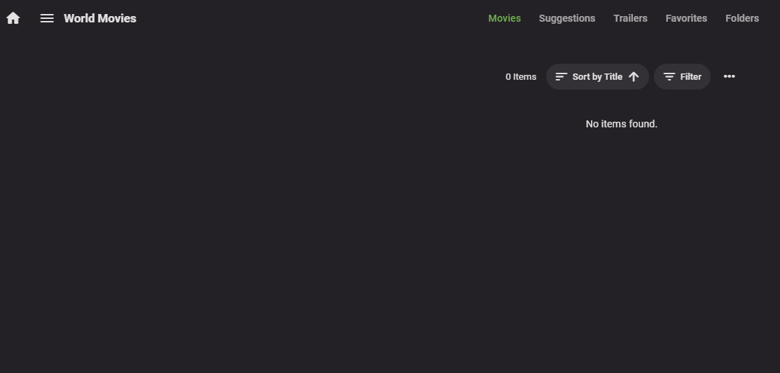

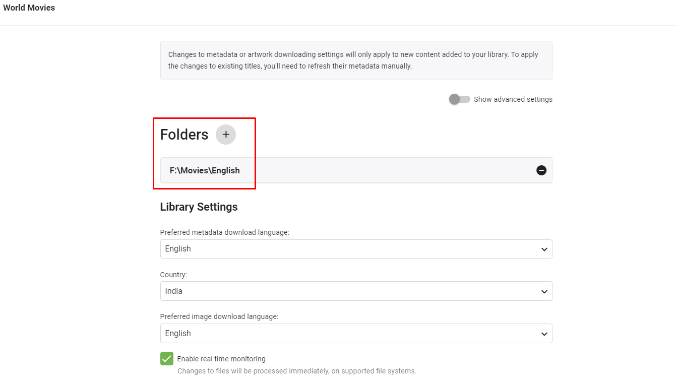

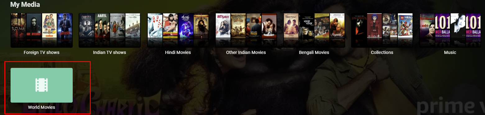

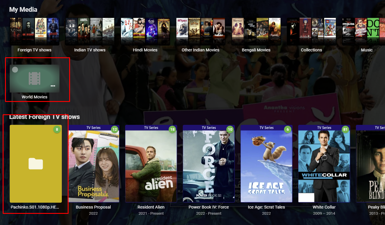

BinaryBoss 1 Posted April 29, 2022 Posted April 29, 2022 Added a Library, Added Folder containing 4000+ Titles, No Progress at all.. Its blank. No progress on Scan library or refresh metadata. I have deleted non working one & created new one.. Still no help. Other Libraries working, Getting info on Newly added Contents. Any help appreciated. embyserver.txt

Luke 42301 Posted April 29, 2022 Posted April 29, 2022 Hi, what folders have your added to your movie libraries?

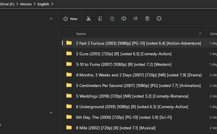

BinaryBoss 1 Posted April 29, 2022 Author Posted April 29, 2022 1 hour ago, Luke said: Hi, what folders have your added to your movie libraries? F:\Movies\English a single folder containing Movie Titles. Screenshots attached with post/topic.

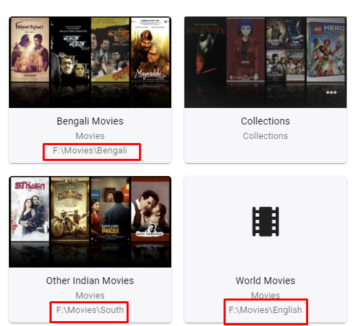

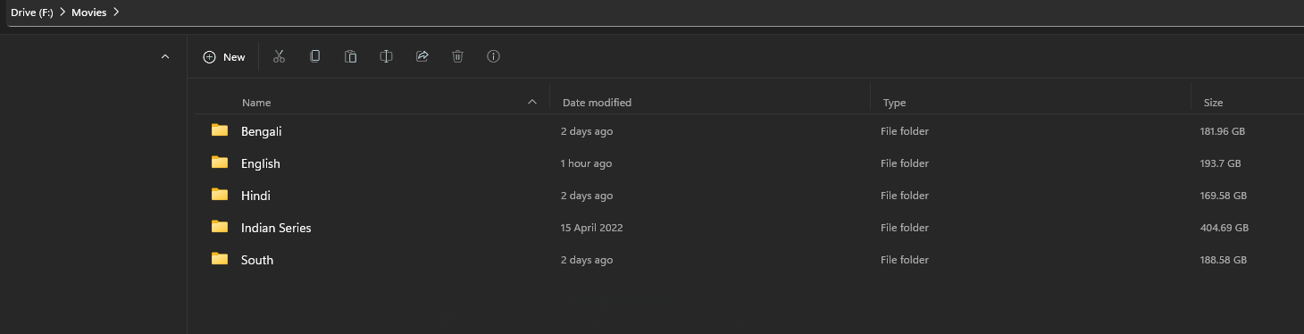

Luke 42301 Posted April 29, 2022 Posted April 29, 2022 Just now, BinaryBoss said: F:\Movies\English a single folder containing Movie Titles. Screenshots attached with post/topic. What folders have you added to all of the other movie libraries?
BinaryBoss 1 Posted April 29, 2022 Author Posted April 29, 2022 (edited) 6 minutes ago, Luke said: What folders have you added to all of the other movie libraries? Similar Folders F:\Movies\Bengali F:\Movies\South F:\Movies\Hindi Attached SS for Folder Structure. Edited April 29, 2022 by BinaryBoss Added more SS

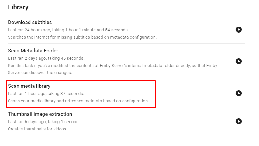

Luke 42301 Posted April 29, 2022 Posted April 29, 2022 OK, please try running the scheduled task to scan all libraries, wait for that to finish, and then see what it looks like.
BinaryBoss 1 Posted April 29, 2022 Author Posted April 29, 2022 (edited) 5 minutes ago, Luke said: OK, please try running the scheduled task to scan all libraries, wait for that to finish, and then see what it looks like. Tried all possibilities. None have results. Edited April 29, 2022 by BinaryBoss
Luke 42301 Posted April 29, 2022 Posted April 29, 2022 Do you see anything in the folders tab of the movies library?
BinaryBoss 1 Posted April 29, 2022 Author Posted April 29, 2022 7 minutes ago, Luke said: Do you see anything in the folders tab of the movies library?

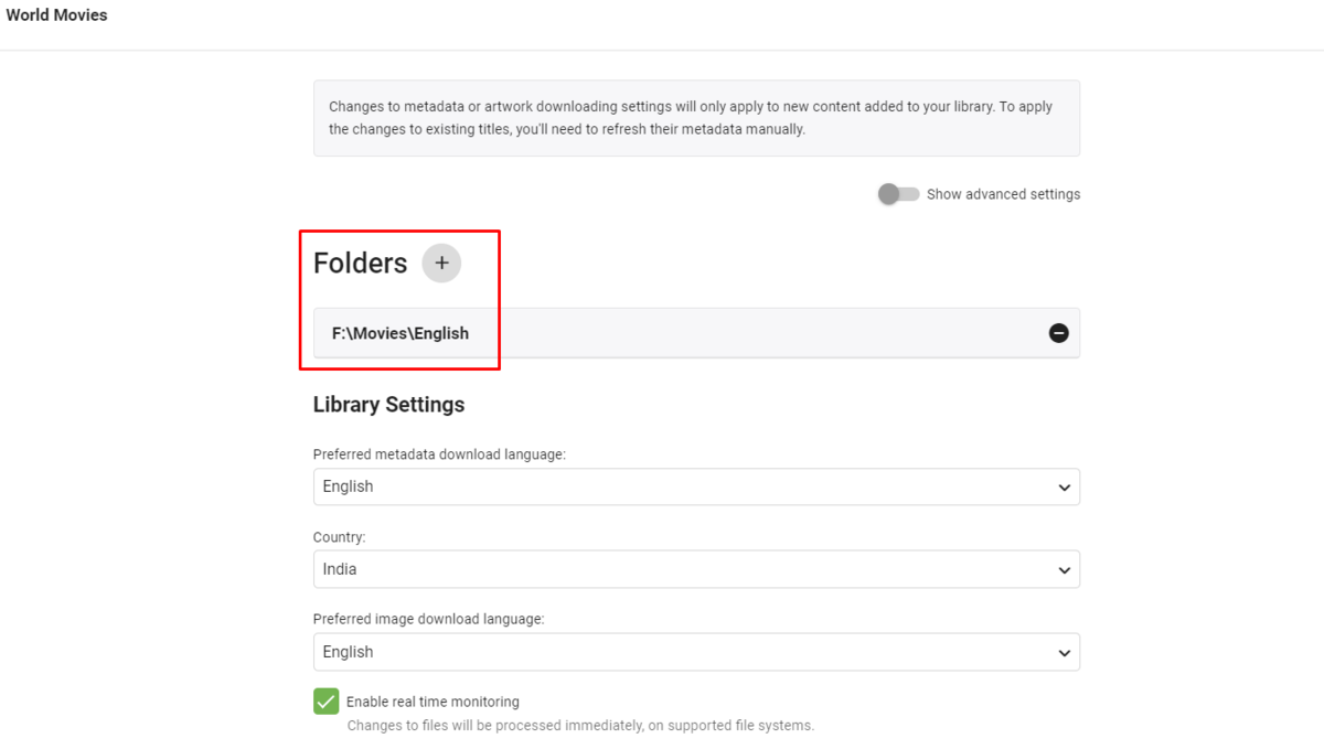

Luke 42301 Posted April 29, 2022 Posted April 29, 2022 No I mean in the Folders tab in the very first screenshot that you provided in the first post.
BinaryBoss 1 Posted April 29, 2022 Author Posted April 29, 2022 1 minute ago, Luke said: No I mean in the Folders tab in the very first screenshot that you provided in the first post. Nope. Folder tab also blank.

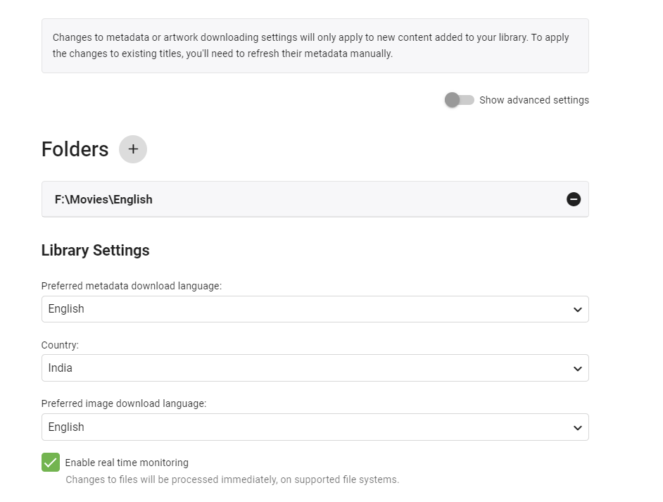

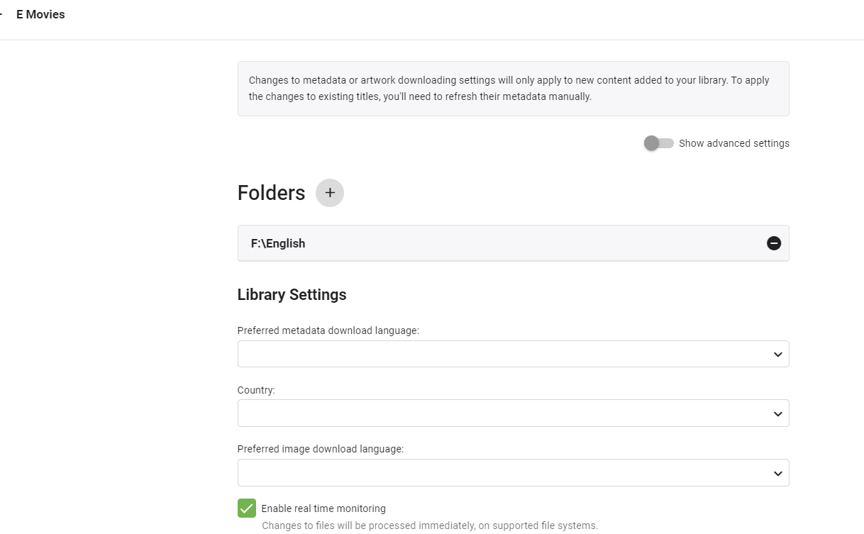

GrimReaper 4928 Posted April 29, 2022 Posted April 29, 2022 For test purposes, could you take that folder out of Movies parent folder 1 level up, to F:\English, and setup library with that path?
BinaryBoss 1 Posted April 29, 2022 Author Posted April 29, 2022 9 minutes ago, GrimReaper said: For test purposes, could you take that folder out of Movies parent folder 1 level up, to F:\English, and setup library with that path? Will try that too & Update.
BinaryBoss 1 Posted April 29, 2022 Author Posted April 29, 2022 17 minutes ago, GrimReaper said: For test purposes, could you take that folder out of Movies parent folder 1 level up, to F:\English, and setup library with that path? Nope.. same condition. Emby started to create nfo files in Movies\English though.
