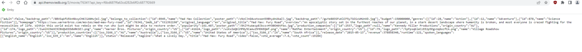

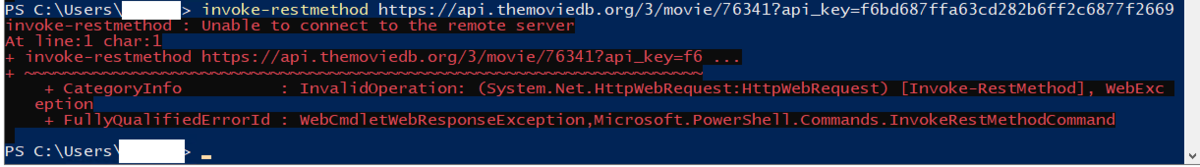

Dr Herbalist 0 Posted April 25, 2022 Author Posted April 25, 2022 The plot thickens. I can send a request to the API from a browser and get a response. It first refused the connection but after refreshing it a few times it returned the data. When I send the request from powershell without a useragent I get a refused connection, no matter how many times I send the request. Could it be a problem with the useragent? The particular IP address the network interface uses here is registered to Lithuania (so shouldn't be getting caught up with the Russian "special conflict"). Any other ideas?
Luke 42186 Posted April 25, 2022 Posted April 25, 2022 You may have something on your end preventing Emby Server from sending the outgoing request, such as firewall, security software, or VPN. Those are the most common causes that we see of this.

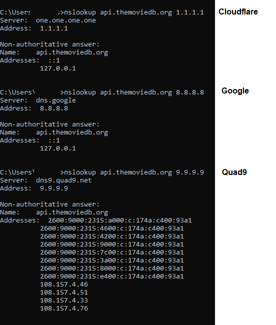

Solution Dr Herbalist 0 Posted May 13, 2022 Author Solution Posted May 13, 2022 (edited) Hey. Just thought would let you know that I managed to get to the bottom of it. It turns out that DNS lookups to api.themoviedb.org were returning 127.0.0.1 as the server address. No idea why this is happening using Google DNS servers or CloudFlare. I ended up using Quad9 for DNS resolution and it now returns the correct addresses. This might explain why it worked in a Chrome browser but not within the OS. I imagine Chrome has its own DNS cache or alternate method of lookup as a fall-back. It's odd because it's not a host record or anything overriding it, when I switched out DNS servers lookup is working. Either way, thanks your your time looking into the issue. It's all working as it should now. Edited May 13, 2022 by Dr Herbalist
Happy2Play 9800 Posted May 13, 2022 Posted May 13, 2022 Interesting as I cannot replicate that test. Spoiler PS C:\Users\Media> nslookup api.themoviedb.org 1.1.1.1 Server: one.one.one.one Address: 1.1.1.1 Non-authoritative answer: Name: api.themoviedb.org Addresses: 2600:9000:20be:fa00:c:174a:c400:93a1 2600:9000:20be:fc00:c:174a:c400:93a1 2600:9000:20be:2c00:c:174a:c400:93a1 2600:9000:20be:4800:c:174a:c400:93a1 2600:9000:20be:bc00:c:174a:c400:93a1 2600:9000:20be:400:c:174a:c400:93a1 2600:9000:20be:2000:c:174a:c400:93a1 2600:9000:20be:d000:c:174a:c400:93a1 52.84.162.18 52.84.162.76 52.84.162.22 52.84.162.78 PS C:\Users\Media> nslookup api.themoviedb.org 8.8.8.8 Server: dns.google Address: 8.8.8.8 Non-authoritative answer: Name: api.themoviedb.org Addresses: 2600:9000:20be:d400:c:174a:c400:93a1 2600:9000:20be:be00:c:174a:c400:93a1 2600:9000:20be:5200:c:174a:c400:93a1 2600:9000:20be:7800:c:174a:c400:93a1 2600:9000:20be:dc00:c:174a:c400:93a1 2600:9000:20be:4e00:c:174a:c400:93a1 2600:9000:20be:5e00:c:174a:c400:93a1 2600:9000:20be:9a00:c:174a:c400:93a1 52.84.162.78 52.84.162.76 52.84.162.22 52.84.162.18 PS C:\Users\Media> nslookup api.themoviedb.org 9.9.9.9 Server: dns9.quad9.net Address: 9.9.9.9 Non-authoritative answer: Name: api.themoviedb.org Addresses: 2600:9000:20be:3c00:c:174a:c400:93a1 2600:9000:20be:dc00:c:174a:c400:93a1 2600:9000:20be:6200:c:174a:c400:93a1 2600:9000:20be:4e00:c:174a:c400:93a1 2600:9000:20be:de00:c:174a:c400:93a1 2600:9000:20be:4a00:c:174a:c400:93a1 2600:9000:20be:3800:c:174a:c400:93a1 2600:9000:20be:1c00:c:174a:c400:93a1 52.84.162.76 52.84.162.22 52.84.162.18 52.84.162.78
Dr Herbalist 0 Posted May 18, 2022 Author Posted May 18, 2022 On 13/05/2022 at 21:05, Happy2Play said: Interesting as I cannot replicate that test. Reveal hidden contents PS C:\Users\Media> nslookup api.themoviedb.org 1.1.1.1 Server: one.one.one.one Address: 1.1.1.1 Non-authoritative answer: Name: api.themoviedb.org Addresses: 2600:9000:20be:fa00:c:174a:c400:93a1 2600:9000:20be:fc00:c:174a:c400:93a1 2600:9000:20be:2c00:c:174a:c400:93a1 2600:9000:20be:4800:c:174a:c400:93a1 2600:9000:20be:bc00:c:174a:c400:93a1 2600:9000:20be:400:c:174a:c400:93a1 2600:9000:20be:2000:c:174a:c400:93a1 2600:9000:20be:d000:c:174a:c400:93a1 52.84.162.18 52.84.162.76 52.84.162.22 52.84.162.78 PS C:\Users\Media> nslookup api.themoviedb.org 8.8.8.8 Server: dns.google Address: 8.8.8.8 Non-authoritative answer: Name: api.themoviedb.org Addresses: 2600:9000:20be:d400:c:174a:c400:93a1 2600:9000:20be:be00:c:174a:c400:93a1 2600:9000:20be:5200:c:174a:c400:93a1 2600:9000:20be:7800:c:174a:c400:93a1 2600:9000:20be:dc00:c:174a:c400:93a1 2600:9000:20be:4e00:c:174a:c400:93a1 2600:9000:20be:5e00:c:174a:c400:93a1 2600:9000:20be:9a00:c:174a:c400:93a1 52.84.162.78 52.84.162.76 52.84.162.22 52.84.162.18 PS C:\Users\Media> nslookup api.themoviedb.org 9.9.9.9 Server: dns9.quad9.net Address: 9.9.9.9 Non-authoritative answer: Name: api.themoviedb.org Addresses: 2600:9000:20be:3c00:c:174a:c400:93a1 2600:9000:20be:dc00:c:174a:c400:93a1 2600:9000:20be:6200:c:174a:c400:93a1 2600:9000:20be:4e00:c:174a:c400:93a1 2600:9000:20be:de00:c:174a:c400:93a1 2600:9000:20be:4a00:c:174a:c400:93a1 2600:9000:20be:3800:c:174a:c400:93a1 2600:9000:20be:1c00:c:174a:c400:93a1 52.84.162.76 52.84.162.22 52.84.162.18 52.84.162.78 It probably has to do with my DNS lookup originating for a Russian IP address.
