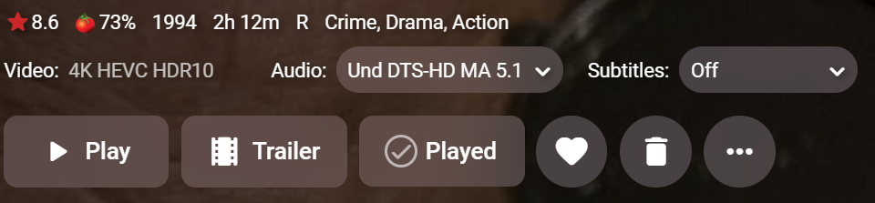

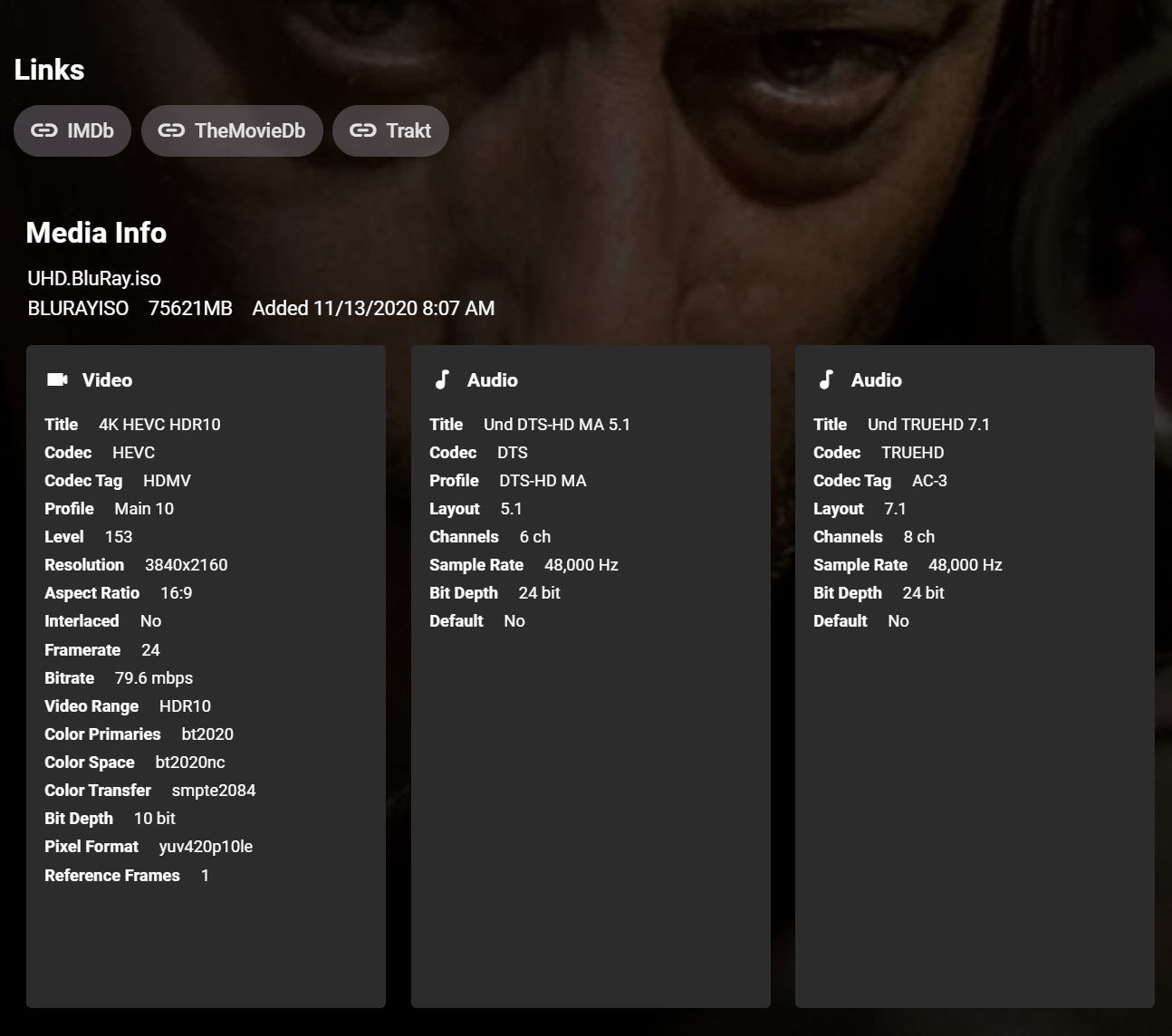

And voila:
1327159800_Screenshot2022-04-18154029.png.c6712828bae017d732d0a49a8a6fbaa0.png2109554975_Screenshot2022-04-18154045.thumb.png.1ab8efaa1cb6d7d7b19cd05cd944eb34.png
