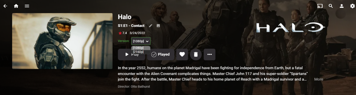

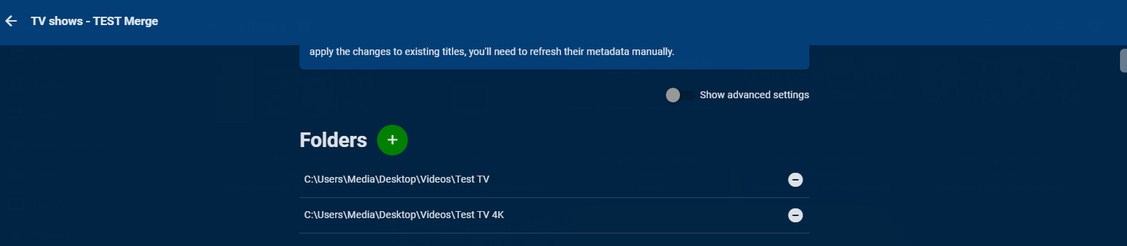

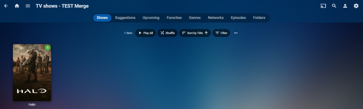

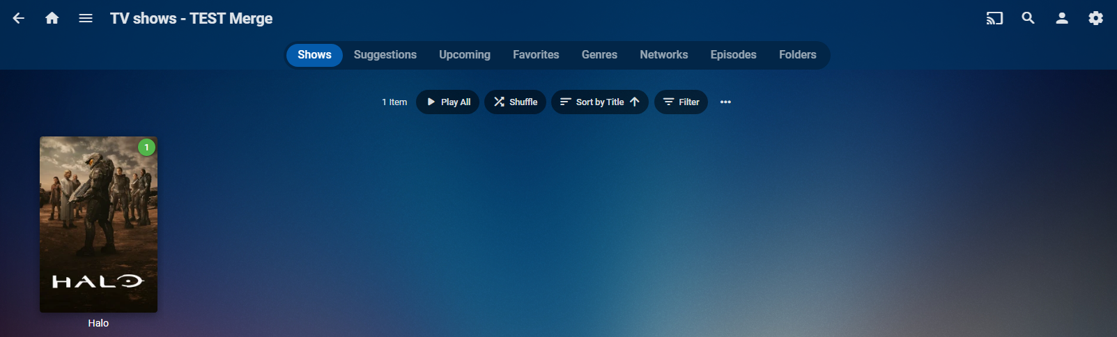

Happy2Play 9813 Posted April 14, 2022 Posted April 14, 2022 Testing this appears to work for me, folders are on the same system but shouldn't matter. Also on current beta 4.7.0.34 but don't think that would matter either. C:\Users\Media\Desktop\Videos\Test TV\Halo\Season 1\Halo S01E01 [1080p].strm C:\Users\Media\Desktop\Videos\Test TV 4K\Halo\Season 1\Halo S01E01 [2160p].strm
