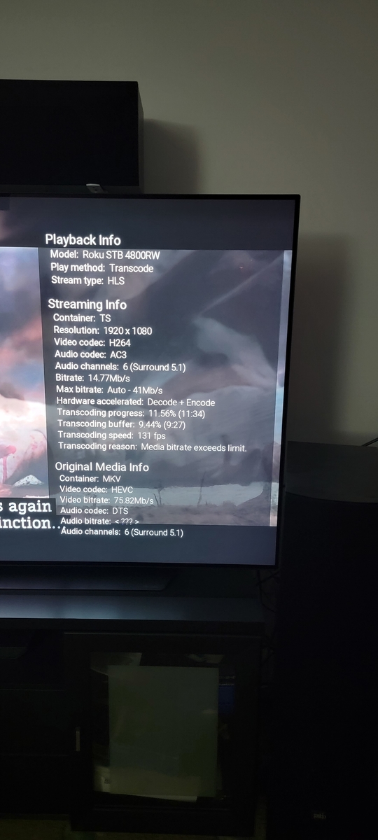

MichaelDiggs 5 Posted April 22, 2022 Author Posted April 22, 2022 Ok here is all the information. I'm giving you the mediafile output of the file, the log area in which I tried to play the file, and a snapshot of the nerds stats screen. Using Plex or Dune I could play this file at the original bitrate, DTS-MASTER Audio (all goes through receiver) no issues. Hopefully a little help. And the server specs are really good. If you want the server specs just let me know. I doubt that could be an issue. AFTER EARTH ffmpeg-transcode-f54497a6-fbfd-4c24-bfc5-d81b0cfa59e6_1.txt log earth.txt mediainfo.txt

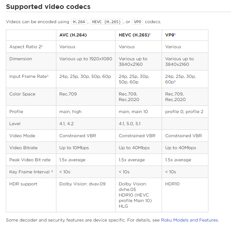

rbjtech 5335 Posted April 22, 2022 Posted April 22, 2022 (edited) Hi - without even looking at the logs, the stats for nerds tells you the issue - "media bitrate exceeds limit". It is a 75Mbit/sec 4K Remux, so you need to make sure the device you are playing it on is capable of playback at those bitrates AND the emby Client Max bitrate matches or exceeds this. Again - looking in Stats for Nerds - it says yours is 41Mbit/sec - thus it is transcoding. I would also be very surprised if a Roku STB can handle a 4K Remux. Lets get the video playing direct first (if possible) then we can move onto the Audio passthough - but I don't believe the Roku can handle HD Audio... edit https://developer.roku.com/en-gb/docs/specs/media/streaming-specifications.md#! so yea, according to Roku's specifications - the max supported bitrate for HEVC is 40Mbps. So while you may be able to force the Emby Client to bitrates higher than this, then it is not officially supported by the Roku - thus you may get issues - but if Plex etc work, then it may be perfectly ok.. The good news is the Roku does appear to support DTS passthrough, but it does not have DTS-HD nor True-HD support - thus during passthrough your AVR is just being fed the DTS Core from a DTS-HD Track. Edited April 22, 2022 by rbjtech

speechles 2062 Posted April 22, 2022 Posted April 22, 2022 (edited) 4 hours ago, rbjtech said: https://developer.roku.com/en-gb/docs/specs/media/streaming-specifications.md#! so yea, according to Roku's specifications - the max supported bitrate for HEVC is 40Mbps. So while you may be able to force the Emby Client to bitrates higher than this, then it is not officially supported by the Roku - thus you may get issues - but if Plex etc work, then it may be perfectly ok.. The good news is the Roku does appear to support DTS passthrough, but it does not have DTS-HD nor True-HD support - thus during passthrough your AVR is just being fed the DTS Core from a DTS-HD Track. Roku is a streaming company. They are not interested in advertising high bitrates. They want companies to stay within a defined middle-ground. The 4800 which that fellow has is the present top-of-the-line device for Roku. It can easily do HEVC as fast as the ethernet can go. Raise it up to 110Mb/s. The other thing DTS-HD and True-HD are supported on newer Roku TV units. Once Roku firmware 11 gets pushed onto Roku TV will come better methods to detect support for HD-audio codecs. It will just be plug-and-play with Emby just knowing what is supported because everything is read from the device chain. The problem with high bitrate HEVC (with HD audio) is ffmpeg has to package it into a TS (to directstream video and convert audio) and serve slices over your network and keep that bitrate going. If the media is on a different system than Emby runs on it will add overhead. Meaning it will have to use half bandwidth to fetch media the other half to serve media at full capacity. Around 50Mb/sec (100Mb/s ethernet) is about theoretical maximum, you get half duplex (Emby must fetch and dispatch media over the network). Whereas if the media and Emby are on same system you get full duplex (Emby will only dispatch media over the network). With giga-ethernet the problem goes away. The Roku NIC does not support giga except higher end Roku TV hence the bigger problem. @MichaelDiggs To get it to work like Plex please raise the maximum bitrate to 110Mb/sec. You cannot pass-through DTS inside an TS container using HLS. When transcoding Emby will use TS/HLS and cannot pass-through DTS and must convert it. But if you were to raise the maximum birate it would allow direct playback which would allow DTS to pass-through exactly like the other guys are doing. If you have any other questions feel free to ask. From your ffmpeg log: http://192.168.1.122:8096/emby/videos/25474/hls1/main/0.ts?DeviceId=deda9995-1d7d-57b0-bed9-34a3a9f30f14&MediaSourceId=4fba81c403ff08da476682e5fd6cd008&PlaySessionId=07153536bd604f8bbb109ffeb15dc2d6&api_key=8c456bcb117c41d2969a4c006ac135d8&VideoCodec=h264,hevc,mpeg2video&AudioCodec=ac3,aac,mp2,mp3,eac3,flac,vorbis,lpcm&VideoBitrate=40616000&AudioBitrate=384000&MaxFramerate=60&MaxWidth=3840&MaxHeight=2160&AudioStreamIndex=1&SubtitleStreamIndex=4&SubtitleMethod=Hls&TranscodingMaxAudioChannels=8&SegmentContainer=ts&SegmentLength=3&MinSegments=1&AllowInterlacedVideoStreamCopy=True&BreakOnNonKeyFrames=True&ManifestSubtitles=vtt&h264-maxrefframes=16&h264-videobitdepth=8&h264-profile=high,main,baseline,constrainedbaseline&h264-level=51&aac-audiochannels=6&eac3-audiochannels=8&ac3-audiochannels=6&flac-audiochannels=6&lpcm-audiochannels=6&mp3-audiochannels=2&mp2-audiochannels=2&vorbis-audiochannels=6&TranscodeReasons=ContainerBitrateExceedsLimit AudioCodec=ac3,aac,mp2,mp3,eac3,flac,vorbis,lpcm ... Are you sure you have DTS enabled in your Roku settings. We read from there. Plex will allow you to force things. We want you to stay within what you told the Roku you were capable of. We want you to just press play. They want you to fiddle. It might be missing because of the transcoding. Just ensure DTS is selected in Roku audio settings and you are good to go. eac3-audiochannels=8 ... Had you had this direct playing the DTS would be enabled this would allow DTS to keep 8 channel maximum and possibly pass-through DTS-HD on your Roku Ultra if it has firmware 11. Can you ensure you have DTS enabled in your Roku audio settings. Emby will read the Roku settings and apply them without you having to do a thing. The only change is bitrate raise to the maximum of 110MB/sec and let us know how it goes. Thanks. Edited April 22, 2022 by speechles

Happy2Play 9801 Posted April 22, 2022 Posted April 22, 2022 From a Roku standpoint there is documented values and believe Emby is coded defaulted to that value with your ability to exceed those values with setting to a higher value. &VideoBitrate=40616000&AudioBitrate=384000 So technically anything over 40Mbps is trial and error if it works on a Roku. But every device/client has their own thresholds.

ebr 16307 Posted April 23, 2022 Posted April 23, 2022 15 hours ago, MichaelDiggs said: I definitely understand nothing will work using the Roku Hi. That isn't true. The Roku will work just fine and, if your network can handle it, you can get it to operate above its published specs. Just set the limit in the app higher as suggested earlier. The Roku is a capable device. 13 hours ago, MichaelDiggs said: We already have determined that the Roku is good for about 40Kbps and that's it Pretty sure that was a typo but, even if you meant 40Mb, that isn't the case either. You can get it to go higher in some instances. 9 hours ago, MichaelDiggs said: How to install Emby in the Nvidia shield? Right now, you will need to sideload it. The APK is available on our web site.

ebr 16307 Posted April 24, 2022 Posted April 24, 2022 10 hours ago, MichaelDiggs said: When you say "set the limit in the app", where do you mean Inside the app you are using there will be a Playback settings area with a quality/bitrate setting. The default is Auto.
