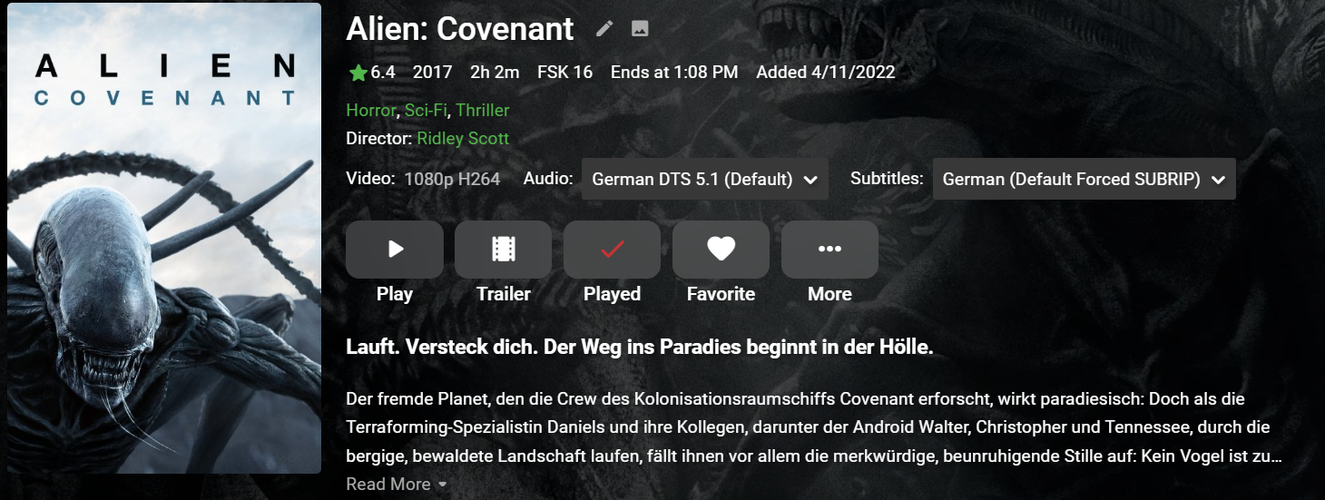

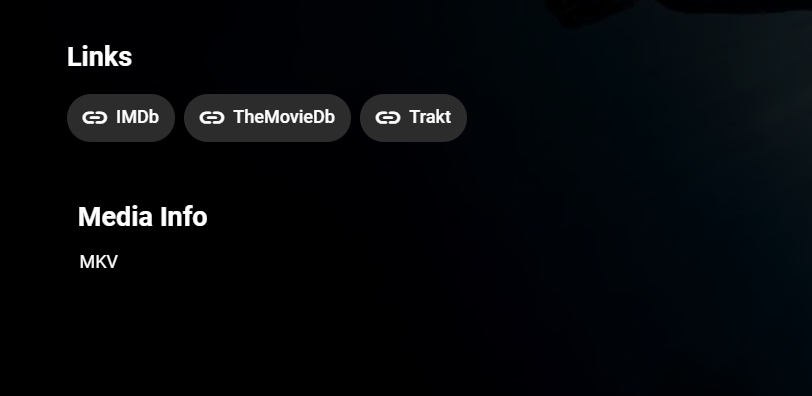

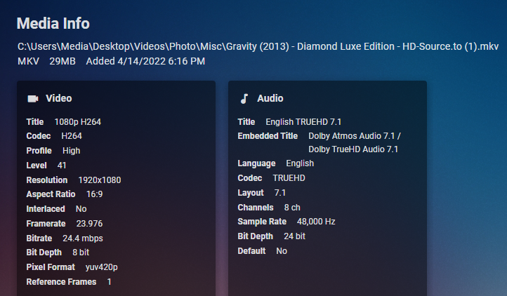

Marv 9 Posted April 12, 2022 Posted April 12, 2022 Hi, I have a single movie in my library for which no media information is shown by emby. All other movies look like this: I have no idea what is causing this as I got 800+ movies in my library and this is the first one with this issue When trying to playback the movie I get: "Playback Error: No compatible streams are currently available" Playback works fine with Kodi and other media players. Someone got an idea whats causing this?

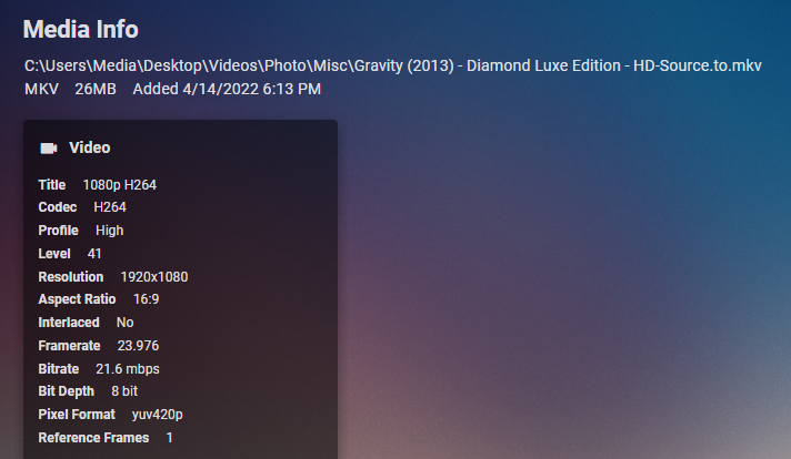

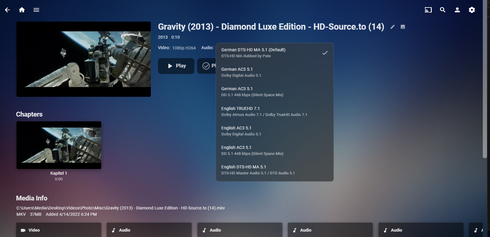

Happy2Play 9813 Posted April 15, 2022 Posted April 15, 2022 With a little trial and error something with the subtitles is broken, removing subtitles allows media info. Remuxed Sample from above leaving the video track added English TrueHD track Subs removed
