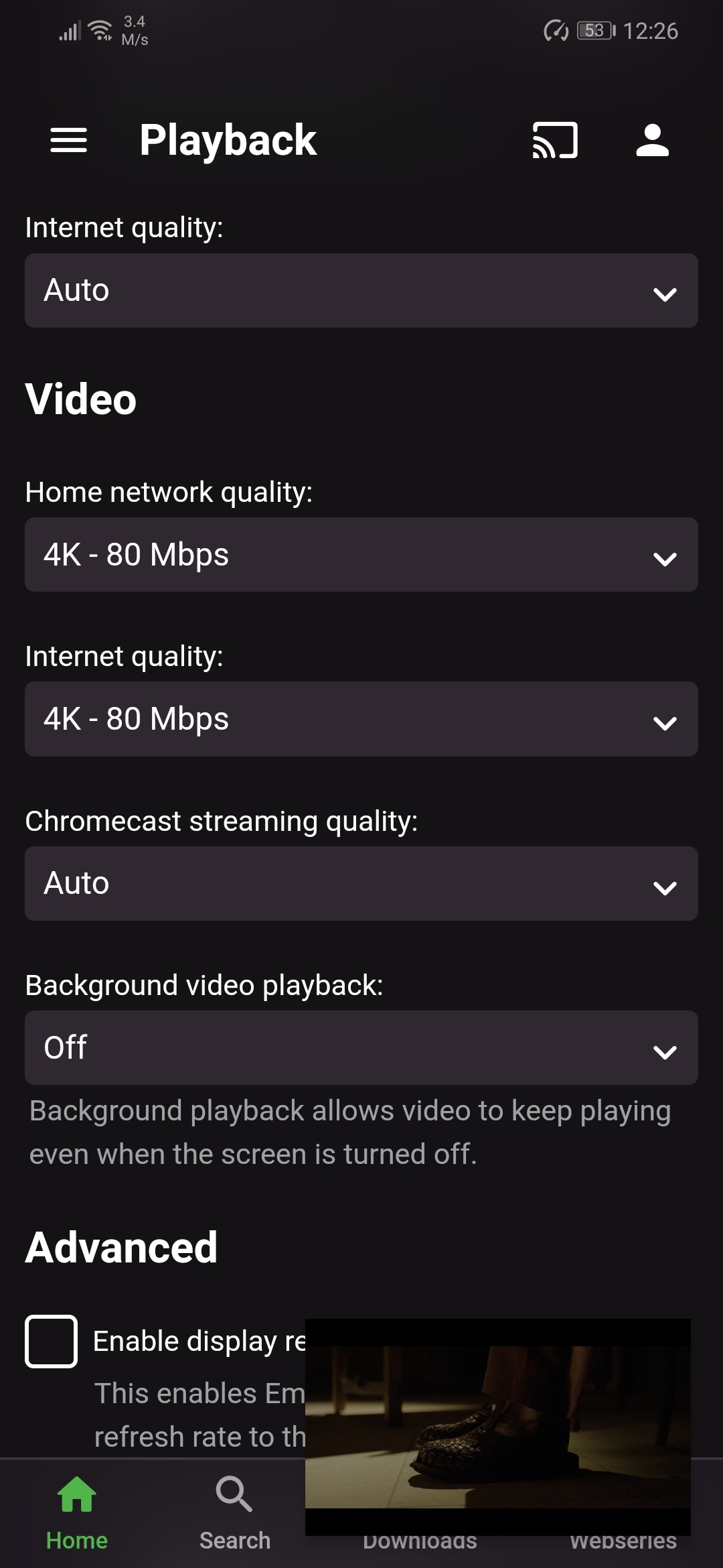

devansh9201 3 Posted April 11, 2022 Author Posted April 11, 2022 1 hour ago, Luke said: Hi, I would suggest lowering the in-app quality setting so that the server will transcode the content down to a lower bitrate. Please see if this helps. Thanks. The cloud processors are really slow so even if I transcode the video to 144p It'll take me 20 mins to just transcode .Lmao. Then I tried digging deep and found that The video was transcoding (which was slowing down the processes of streaming video) and i tried different different combos of Video playback Quality . And then figured out the problem from Ffmpeg Transcode log file and suprisingly I thought that maybe increasing internet quality could solve the problem so I turned it to 4k-80mbps. This solved the problem as it no longer transcoded the files and Yeah that's it Voila! Problem fixed. ffmpeg-transcode-13b8a7bb-6612-42d6-94b4-2d121944e39e_1.txt
Luke 42246 Posted April 17, 2022 Posted April 17, 2022 If your network can handle the larger output then that should be fine.
