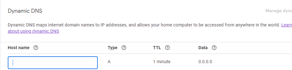

VirulentPip 93 Posted April 10, 2022 Author Posted April 10, 2022 Thanks I'll look into this.. I did try on Asus but kept coming up with request failed or authentication failed. This is what is shown on Google Domains section.. It won't let me input data so stays at 0.0.0.0 .. Which I guess is where the issue is.
rbjtech 5335 Posted April 10, 2022 Posted April 10, 2022 1 minute ago, VirulentPip said: Thanks I'll look into this.. I did try on Asus but kept coming up with request failed or authentication failed. This is what is shown on Google Domains section.. It won't let me input data so stays at 0.0.0.0 .. Which I guess is where the issue is. Correct - that would be my guess. Once the 'Data' matches your VM Public IP address - (and an nslookup does the same) - then you should be in business.
VirulentPip 93 Posted April 10, 2022 Author Posted April 10, 2022 (edited) I honestly have no idea what I am doing beyond this point. That data still says 0.0.0.0 . I assume I need some sort of DDNS client as Asus isn't working (Note : If the wireless router is using a private WAN IP address (192.168.x.x, 10.x.x.x, or 172.16.x.x), this router may be under a multi-layer NAT network. The DDNS service is not able to work under this environment.). But now I'm lost, I really wish this was more user friendly.. Well admin friendly. Edited April 10, 2022 by VirulentPip

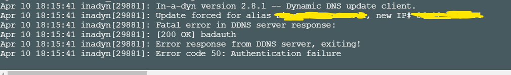

rbjtech 5335 Posted April 11, 2022 Posted April 11, 2022 Ddns needs to be fixed, as if VM ever change your public IP, it will stop working. Where is that log from - is that the Asus ? Any public DNS update will need to be done from your domain provider - as you need authentication for whoever owns that domain - otherwise anybody could just update your record and break it. So if you got your domain from google - then you'll need to auth with google to get the ddns entry updated. https://support.google.com/domains/answer/6147083?hl=en

VirulentPip 93 Posted April 11, 2022 Author Posted April 11, 2022 29 minutes ago, rbjtech said: Where is that log from - is that the Asus ? Yeah from Asus.. So in the Google DNS it's confusing.. In the Host name, what do I put? My Domain or something else, it doesn't quite make sense and I cannot seem to find an answer, maybe the Asus was coming back with that error due to the port misconfig hmm
VirulentPip 93 Posted April 11, 2022 Author Posted April 11, 2022 Well magically that now works too.. DDNS set up Will make new post about Android later. Thanks for the assist.
rbjtech 5335 Posted April 11, 2022 Posted April 11, 2022 Ports are not related to DNS. Are you using the login you got with the google domain setup process in the Asus for DDNS - and have you followed the link I sent about as it tells you how to set it up ? If your happy to - ping me a Private Message with the actual domain you are using (from google) and your WAN IP provided by VM - I will see if I can see what's going on.
