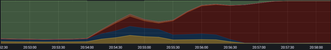

TwIXx 0 Posted April 13, 2022 Author Posted April 13, 2022 Sorry for the late answer: Here are the logs and the Screenshot from the I/O waits (red one). Emby_logs_2.txt
Luke 42246 Posted April 13, 2022 Posted April 13, 2022 How do you know that's from Emby Server. Please also attach the complete Emby Server log rather than just a portion of one. Thanks.

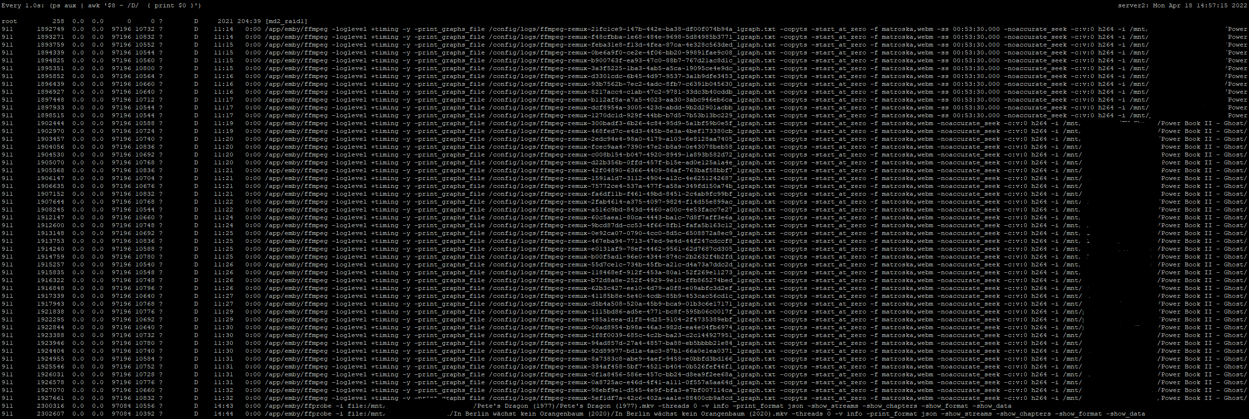

TwIXx 0 Posted April 18, 2022 Author Posted April 18, 2022 I think thats not the problem. See this processes gives me these I/O waits:
TwIXx 0 Posted April 18, 2022 Author Posted April 18, 2022 Here some of the logs. Are always the same. ffmpeg-remux-00ad8954-b98a-46a3-982d-ea4e04fb6974_1.txt ffmpeg-remux-94ad857d-27a4-4857-ba88-eb5bbbb21e84_1.txt ffmpeg-remux-8a7383c8-abe9-4aef-9458-e0bbfd3bd166_1.txt ffmpeg-remux-d5b4a508-520a-45b9-bca9-01b3c6e17171_1.txt embyserver-63785890952.txt
Luke 42246 Posted April 18, 2022 Posted April 18, 2022 Can you please try my two suggestions anyway and see how that compares? Thanks.
