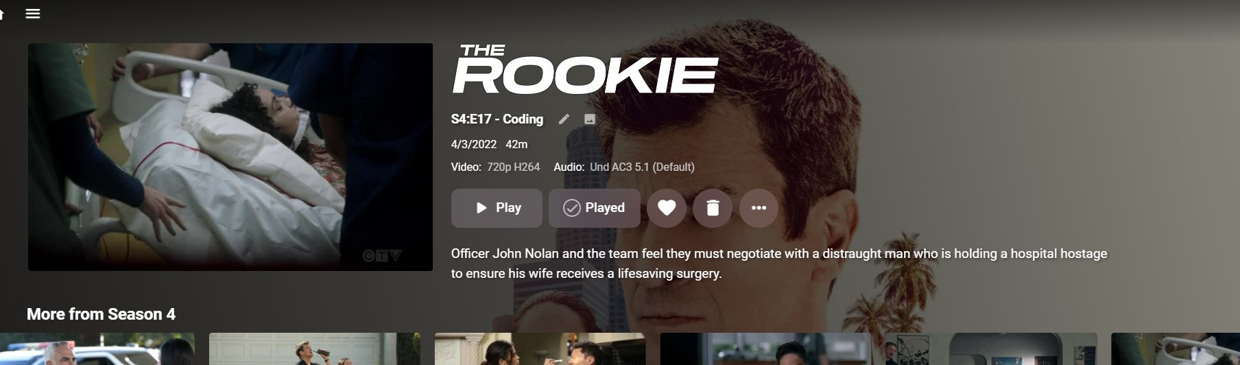

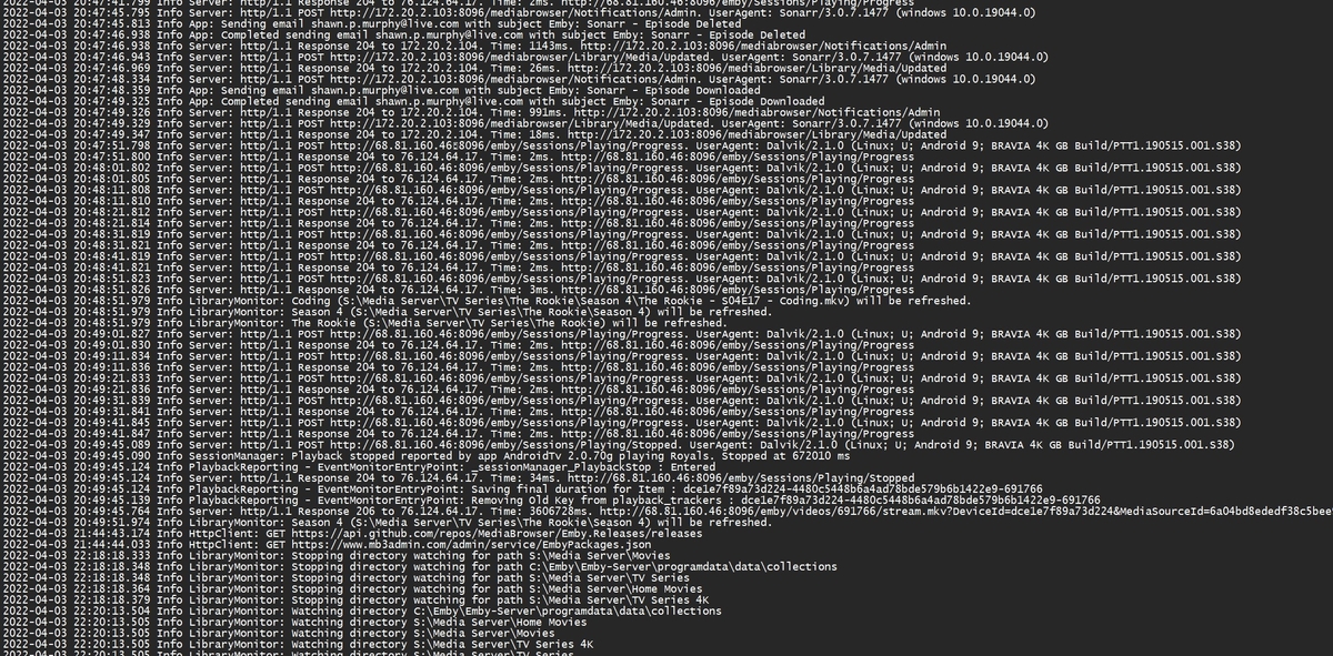

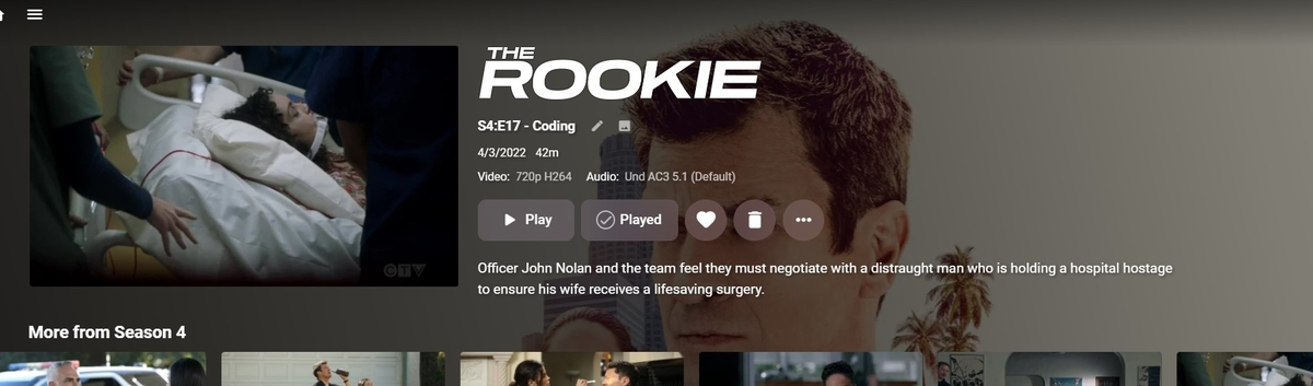

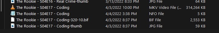

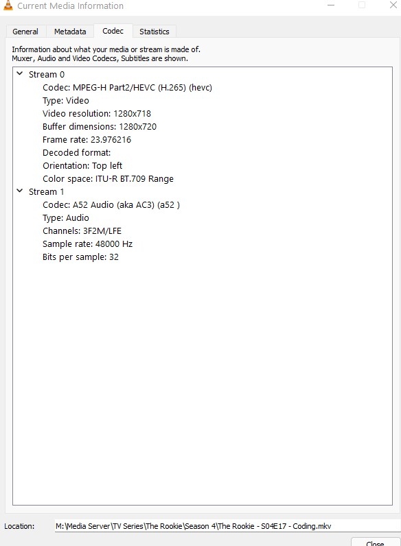

SpMCool 4 Posted April 4, 2022 Posted April 4, 2022 Hello, I am having a similar issue and cant seem to figure out how to fix it. The issue I'm having is that when an episode is upgraded by Sonarr, Emby does not update the metadata for the episode. This results in Emby for Roku to throw errors when trying to play that episode if it requires transcoding. For example, yesterday at 8:36PM Sonarr imported a h264 version of an episode of The Rookie - S04E17, Emby saw it and created the thumb, .nfo, and .bif files, 10 minutes later (at 8:47PM) Sonarr deleted that episode then imported a HVEC version of the episode, but Emby never rewrote the nfo nor updated the episode details (codec or video and audio track details). Below is what I see when I go to the episode in Emby. Below is the actual episode size and codec details. When I went though the logs, it appears that Emby does see the episode was updated and says it will be refreshed, but never was. The only way for me to get it to update so I can play that episode on my Roku TV is to manually refresh all metadata for that episode. I attached the full server log from both yesterday and today, as well as the transcode log. Please look into this and let me know how to fix it or if you need anything else from me. I can provide more examples if needed. Thanks, Shawn embyserver.txt embyserver-63784415685.txt ffmpeg-transcode-a5529d44-80be-4379-8bde-dd0335cf7e09_1.txt
Luke 42186 Posted April 5, 2022 Posted April 5, 2022 HI, make sure the date modified timestamp of the video file is changing. If that's not happening then that would explain why it's not getting re-probed for new media info.
SpMCool 4 Posted April 6, 2022 Author Posted April 6, 2022 @Luke, the date modified is not changing and will always be the same, that is because when Sonarr imports an episode, it changes the date modified to the date and time the episode originally aired. That said, when comparing the episodes, there are 2 file properties that will always be different, the date created and file size, is there any way I could configure my Emby server to re-probe the episode if one of those change? I’m a little surprised that no one else has run into the same issue that I’m having since Sonarr defaults to changing the date automatically and the only way to change that is to modify an advanced setting (which is hidden by default) located in the file management section of media management, therefore, I can only assume that most people using Sonarr have it set up to change the date of the episode. I’ve been having this problem for quite some time, so it's not something that changed in a recent update (I am a beta tester so my Emby updates often). I was working on a PowerShell script that monitors my media library for file system changes and deletes the nfo file of an ‘upgraded’ episode after Sonarr imports it, but I abandoned that idea after I realized that it wouldn’t resolve my issue if Emby doesn’t use the nfo and only writes it for Kodi.
