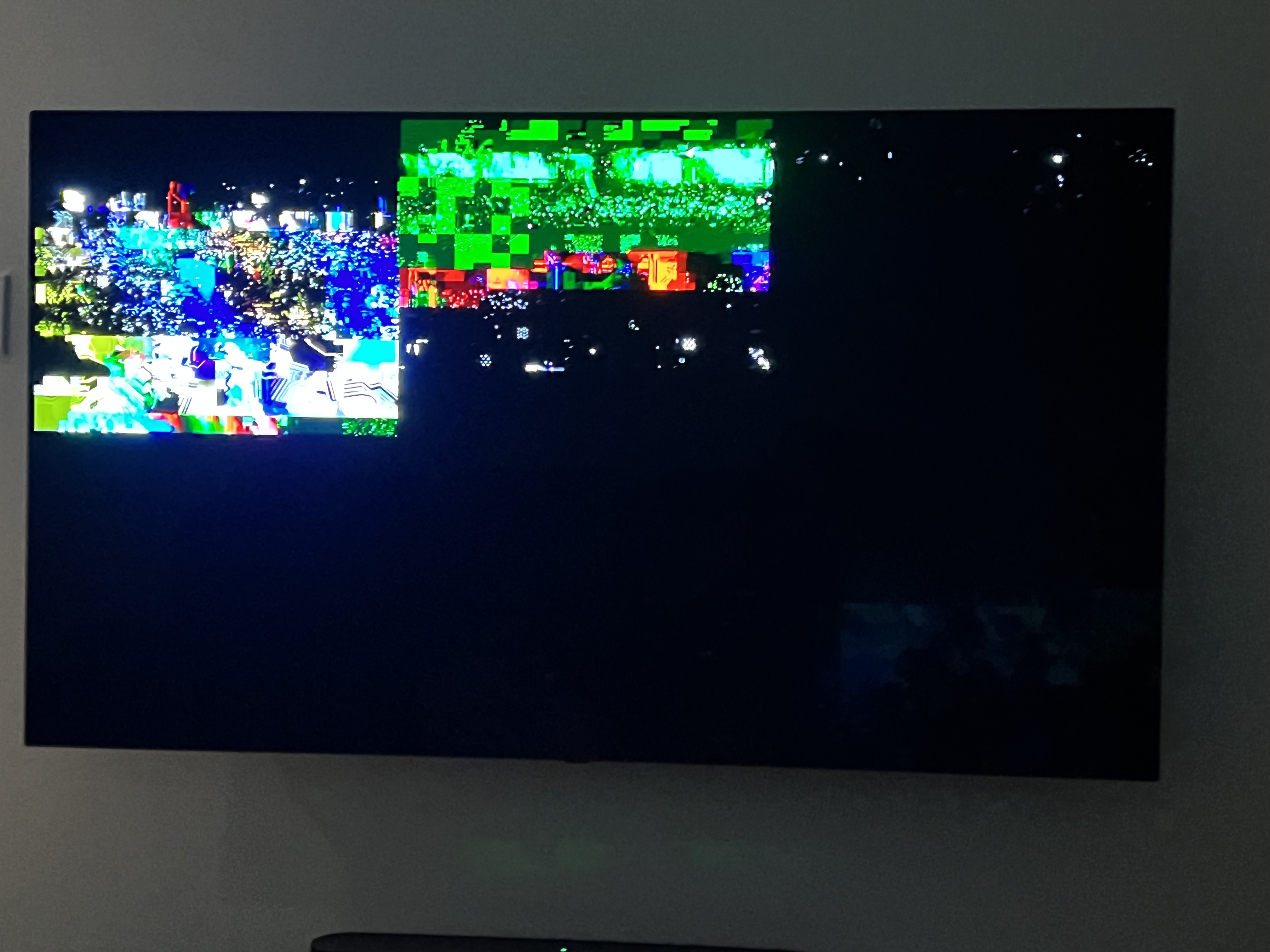

schn0052 1 Posted April 5, 2022 Posted April 5, 2022 Hello, I have the following setup -A Shield TV Pro connected to my LG OLED TV via HDMI. -Sonos Beam(Gen1) connected to LG OLED TV via Optical Issue When playing a 4K HDR 10BIT video that has an audio stream such as DTS-HD MA 7.1 the audio gets down converted to Dolby Digital 2.0 (I think by the Shield or LG TV or Beam as in Emby dashboard it shows Direct Play, see attachment Before-Changing-Audio-Settings.jpg). This then made me realize of course the Sonos Beam only supports Dobly Digital 5.1 audio streams so although Emby thinks its directly playing, something is down converting it to a lower Dolby Digital 2.0(As I can see in the Sonos app). I then noticed the setting in the Shield TV app that allows me to set "Convert Unsupported Audio to Dolby Digital", this actually fixed the audio stream and in the Sonos app it now shows as Dolby Digital 5.1(See attachment After-Chaning-Audio-Setting.jpg) however it breaks the entire video stream. The stream becomes glitchly with green boxes (See attachment Broken_Video_Stream). I have attached the server log as well. Please let me know if there is something I can do to resolve this or if its best to shy away from these types of audio codecs because I am using a Sonos Beam. Emby.log

schn0052 1 Posted April 5, 2022 Author Posted April 5, 2022 More information on this as I troubleshot more today on this, it seems to only happen to maybe one or two movies in my library and it only seems to effect them when I resume or seek far into the movie and not every time. Today in one of my tests I fast forwarded 3 times before the video got choppy.. If i start the movie and let it play though it seems to remux it perfectly fine. Not sure where to go from here? I assume it cant be a bad video since If I let it play it it works fine and if I dont remux it it plays fine too.

schn0052 1 Posted April 7, 2022 Author Posted April 7, 2022 So again tonight it is happening to another movie that’s 4K HVEC 10bit / DTS-HD MA 7.1 video, I noticed in both video files under embedded title it says DTS:X 7.1. These two files that had this issue it happend too. Now I am wondering if it has to do with DTS:X and remuxing that format

mike3231 2 Posted April 8, 2022 Posted April 8, 2022 @schn0052 Did you manage to get to the bottom of this or is it still an issue for you? It sounds like I have the exact same issue. Hard to pinpoint on certain videos.. but definitely seems to be an issue with DTS:X /7.1 videos. My setup is SHIELD (2019 Tube) > LG GX > Sonos Arc - DTS in all flavours is not supported by my TV so it will try to convert to DD 5.1 everytime and seems to be fine for DTS/DTS-HD but not DTS:X/ 7.1, it sounds correct but the video quality is broken (green artefacts/stuttering/screen tearing). However if you downmix to Stereo, it plays fine.

mike3231 2 Posted April 9, 2022 Posted April 9, 2022 2 hours ago, schn0052 said: Just side loaded the app as well, I have the same issue @Luke. When i play the video with DTS:X / 7.1 the app has a pop up that says audio not supported and the server dosnt try to transcode the audio file which results in no sound. When the file is direct played the video glitches do not occur. It’s only when it remuxes the file to DD 5.1 that causes the issue. That popup is probably from your TV rather than the shield or emby mobile app. To get around this on the shield you need to go to shield audio settings and uncheck auto detect supported audio and check the supported ones. If your TV is like mine (LG OLED 2020 onwards) then no DTS is supported so just uncheck those and check the rest. I think LG did have some DTS but have now dropped it You'll then get the audio on the Emby android (mobile) app but it'll be DD2.0 like me I imagine, but worth trying incase yours is different.
schn0052 1 Posted April 11, 2022 Author Posted April 11, 2022 On 08/04/2022 at 18:39, mike3231 said: @schn0052 Did you manage to get to the bottom of this or is it still an issue for you? It sounds like I have the exact same issue. Hard to pinpoint on certain videos.. but definitely seems to be an issue with DTS:X /7.1 videos. My setup is SHIELD (2019 Tube) > LG GX > Sonos Arc - DTS in all flavours is not supported by my TV so it will try to convert to DD 5.1 everytime and seems to be fine for DTS/DTS-HD but not DTS:X/ 7.1, it sounds correct but the video quality is broken (green artefacts/stuttering/screen tearing). However if you downmix to Stereo, it plays fine. I would say these symptoms are 100% what I am experiencing including the downmixing to 2.0 fixing the remuxing. @Luke, I will find time this weekend to side load the app. I have a video file now that lets me 100% reproduce the symptoms so it will be very easy for me to tell if this resolves it. I will post back soon with details. Thanks for assistance in!
schn0052 1 Posted April 11, 2022 Author Posted April 11, 2022 @mike3231, you were right, It was the TV, I disabled DTS on the shield but for some reason the Andriod Emby app downed it to DD 2.0 instead of DD 5.1. @Luke, Thoughts on what I should try next? I also noticed the Emby app is no longer on the App store. Is there a way I can download the apk for the Shield Emby App? Overall so far that app works better then the Android app I find.
