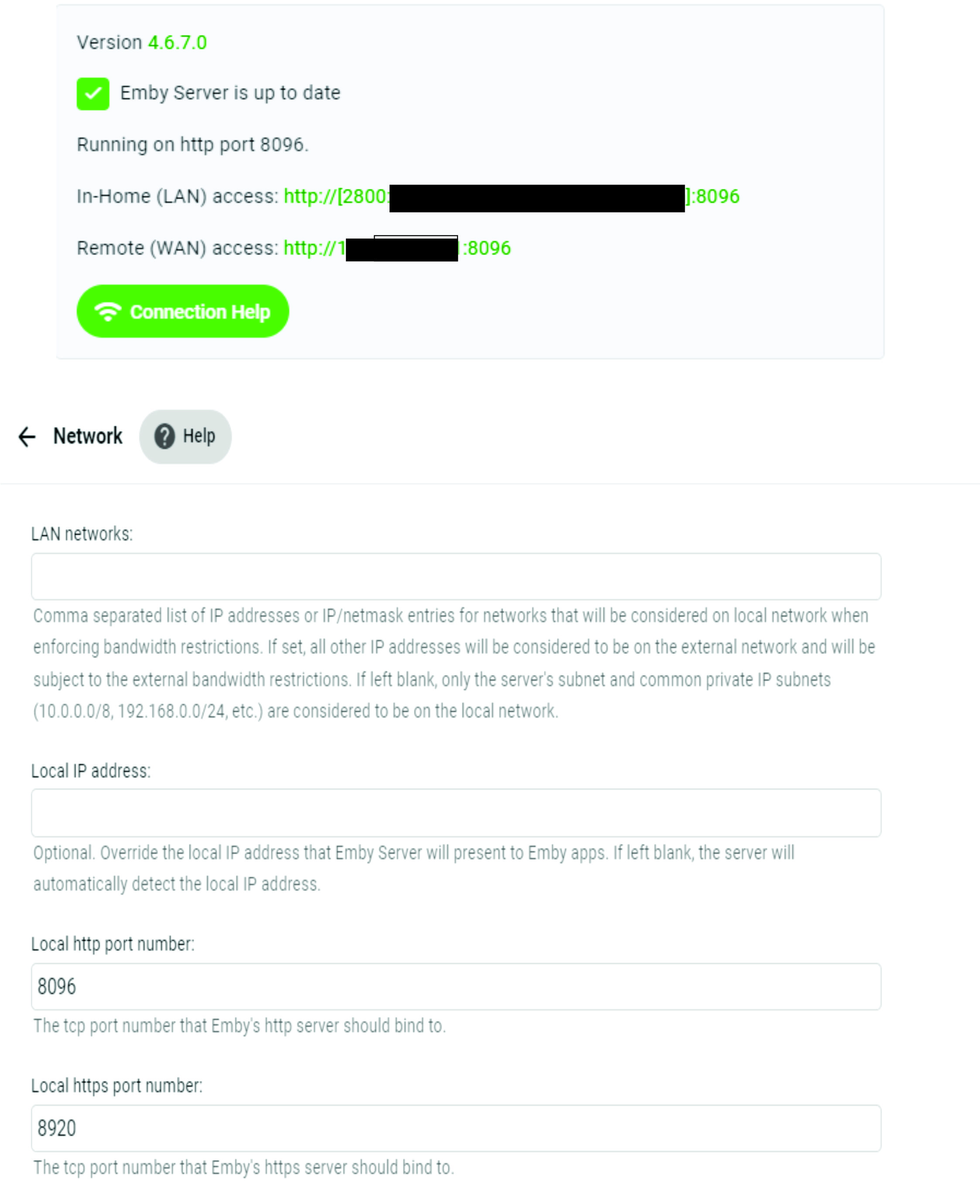

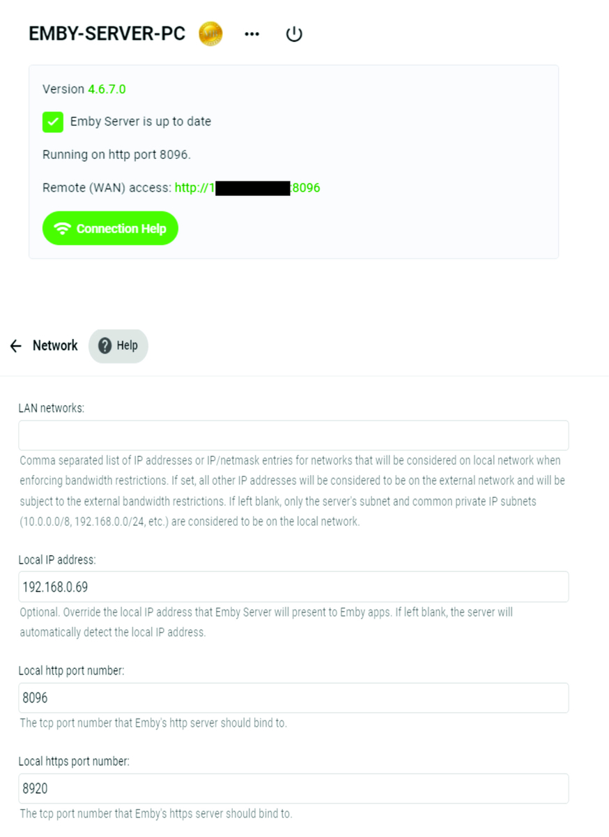

maxmaxter 0 Posted April 3, 2022 Posted April 3, 2022 hace unas semana, que tengo problemas con el acceso local del servidor, solo me deja conectar a la ip publica lo cual provoca problemas con las tv de la red local, cuando cambio la configuración y dejo en blanco los campos de red local e ip local me sale la ipv6 local, agradeceré su ayuda para solucionar este problema

Carlo 4561 Posted May 10, 2022 Posted May 10, 2022 23 hours ago, maxmaxter said: if I still have problems and I can not access the local network Hi, Looking at your log it seems like it's confused. Some IPs are IP4 and some IP6 with some from IP6 to an IP4 address of the loopback 127.0.0.1 taking 20+ seconds. Decide if you need IP6 AND IP4 both active. If not removing one likely fixes your issue. Otherwise start at the router and review IP setup to make sure DHCP is pulling an ip6 address and pulls an ip6 DNS server(s). Same for ip4 addresses. Make sure you get a DHCP address from your ISP as well for both an IP and DNS Server(s) using ip4. In Emby remove the local address you put in the network section and let it pull the IPs the server is getting from your router. It's going to use the ip6 address and show that in the GUI which is correct but should still be bound to all addresses as long as you don't specify one like you're doing now. Test using the ip6 address from another computer. I know hard to type those long addresses but if you're going to use them then use them. If it works when testing you can also give you network a name such as "local". If you set the name in windows to "emby" then that should get registered on your router and you can then use "emby.local" vs typing and IP. maybe use "home" instead of local so you can "emby.home" Both home and local should be understood by your router as being LAN addresses. Try that for starters and let us know you make out, Carlo
Happy2Play 9800 Posted May 11, 2022 Posted May 11, 2022 @LukeShould Emby "NetworkManager: Detected local ip addresses:" be detecting the IPv6 WAN address? But would guess disabling IPv6 would/could correct the issue.
Luke 42186 Posted May 11, 2022 Posted May 11, 2022 3 hours ago, Happy2Play said: @LukeShould Emby "NetworkManager: Detected local ip addresses:" be detecting the IPv6 WAN address? But would guess disabling IPv6 would/could correct the issue. Ideally no, and that should only happen if an ipv4 address is not detected.
