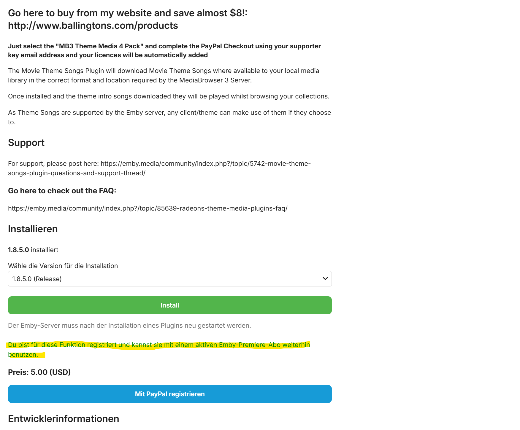

muchi2007 0 Posted June 8, 2025 Posted June 8, 2025 Hello, i hope somebody can help me with my problem. Today i've purchased the "Emby Theme Media Full Price" Package. I've got the same Key like my Server licensed. Than I've installed the TV-Theme Songs and Movid Theme Songs Plugin to my Emby Server. In the install screen i get the message of the picture, so i think all is good. When i download the local TV Show Songs all of them working great. But when i want to download the local Movie Theme Songs than the task running for only 1 Second. In the Log-File i get the error: 2025-06-08 08:02:59.704 Info App: Movie Theme Songs Registration Status - Registered: False In trial: True Expiration Date: 23.06.2025 00:00:00 Is Valid: True 2025-06-08 08:02:59.704 Info App: Movie Theme Songs 2025-06-08 08:02:59.704 Info App: In Trial - Downloading movie theme songs is only allowed for Registered Users I just reinstall the plugin and i used different versions, but the error occured again. What can i do, that Emby seems me as a registered user?
radeon 760 Posted June 8, 2025 Author Posted June 8, 2025 Give it a bit of time pal. The emby licence can take a big of time to update but you're right, everything is good to go. Restarting your emby server instance can help pull the licence through so give that a go. Cheers
